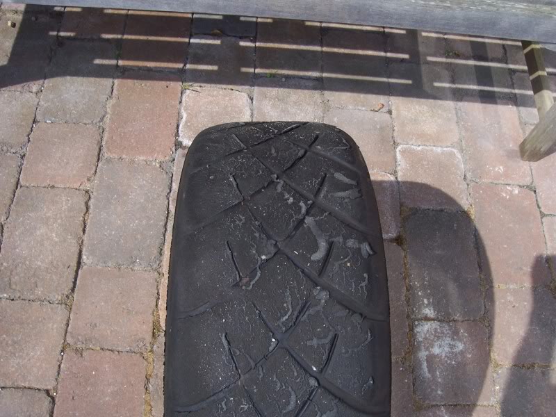

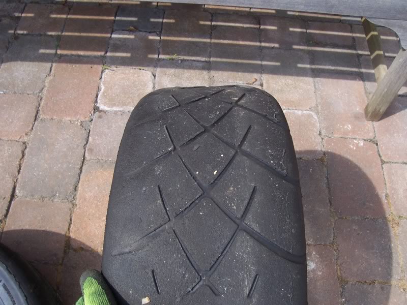

I ran at Goodwood recently using some track tyres that were well over 7 years old - visual inspection showed no signs of the rubber perishing, and they had enough tread for a day and being a cheap accountant I thought I could get another day from them.
The carcass though...almost killed me!
Fordwater at Goodwood, flat in 5th so 110-120 or so, and I feel a slight knock through the steering wheel and the car wants to pull me off the track to the left. I backed off then as I braked for St. Marys the car tried to shake itself apart with the vibration coming from the front left wheel. Backed right off, headed back to the pits where I found this...
Tyre 1 - all good
Tyre 2 - no problems here
Tyre 3 - this one's fine
Tyre 4 - rolling diameter swollen on the inner edge by about 15mm!!!!!
So the carcass on this tyre, the front left one, started breaking down at 110-120 mph, on a corner with zero run-off.
F***.
That's the last time I try to get max life out of something so critical!
