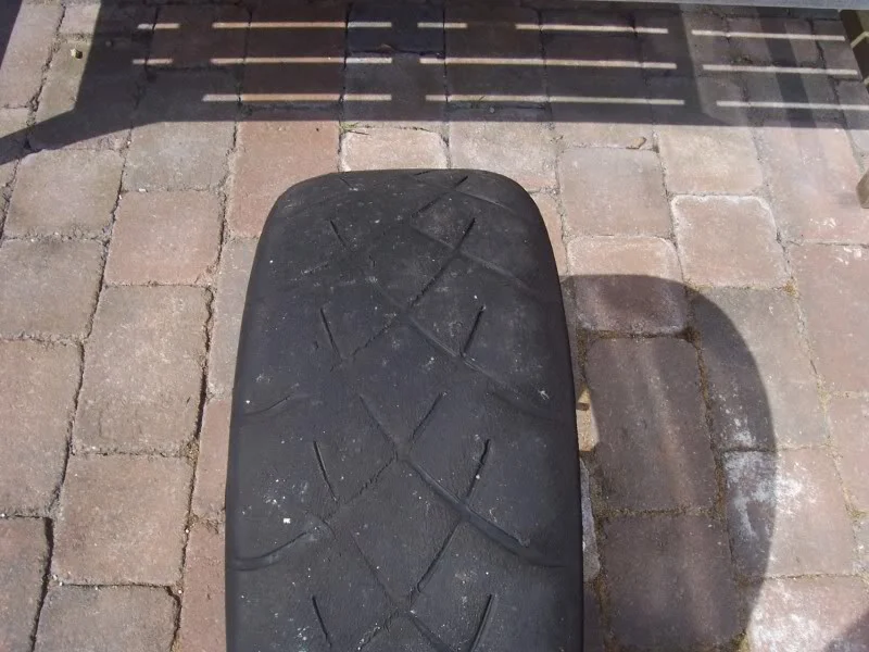

Fordwater at Goodwood, flat in 5th so 110-120 or so, and I feel a slight knock through the steering wheel and the car wants to pull me off the track to the left. I backed off then as I braked for St. Marys the car tried to shake itself apart with the vibration coming from the front left wheel. Backed right off, headed back to the pits where I found this...
Tyre 1 - all good

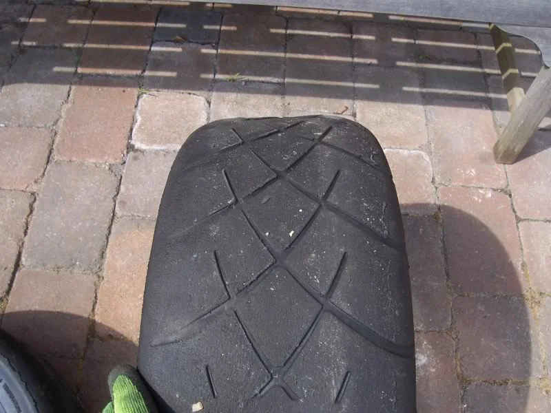

Tyre 2 - no problems here

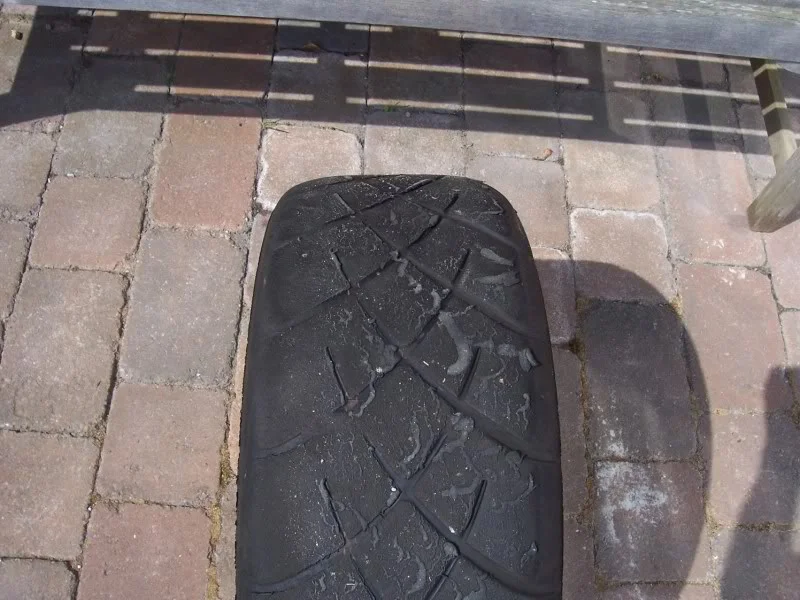

Tyre 3 - this one's fine
