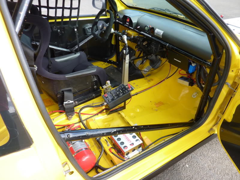

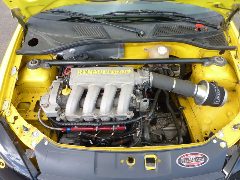

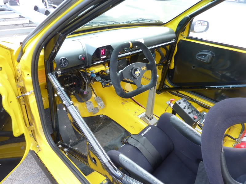

I managed to find a couple of pictures from previous owners...
The current spec of the car is: (Taken mostly from the listing)
Engine : Clio 182 sealed cup spec engine, Omex 600 ECU. Orbisound exhaust and sports cat.
Bodyshell : 2005 Lhd shell refinished inside / outside and underneath in 2k Renault Yellow. Around 900kg. Front strut brace. Electric power steering.
Gearbox : Sadev 6 speed sequential , Flat Shift ( Full Throttle ) Dog Engagement with Limited slip diff. Illumenated dash shift display.
Suspension : Renault Sport Cup spec non adjustable Bilstein Dampers. Modified Cup spec rear beam , Modified front Lower arms.
Brakes : Clio 182 Sport Calipers with Competition Mintex Discs and Carbone Lorraine RC6 and RC5+ pads, Goodridge Hoses and all lines throught inside of car. Brake balance adjuster.
Interior :. Renault Sport master console to right of driver with all necessary switches ie. Masterswitch , ignition , start button , wipers, indicators, fan, screen demister etc. Switch for power steering. 1 x Corbeau Race seat , sabelt aircraft 3" Harness . Full manual Fire Extingisher system. XAP isolator. Spa fuel guage. Spa Dual Oil Pres/Oil Temp. Spa Dual Water Temp/Volts. Geartronics gear indicator.

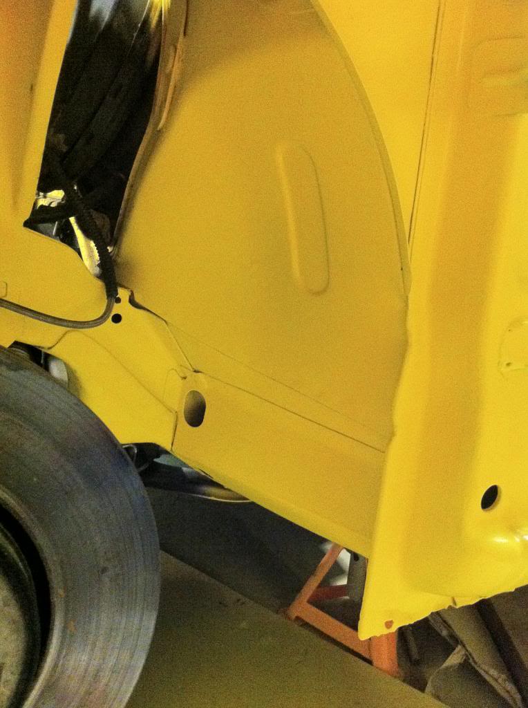

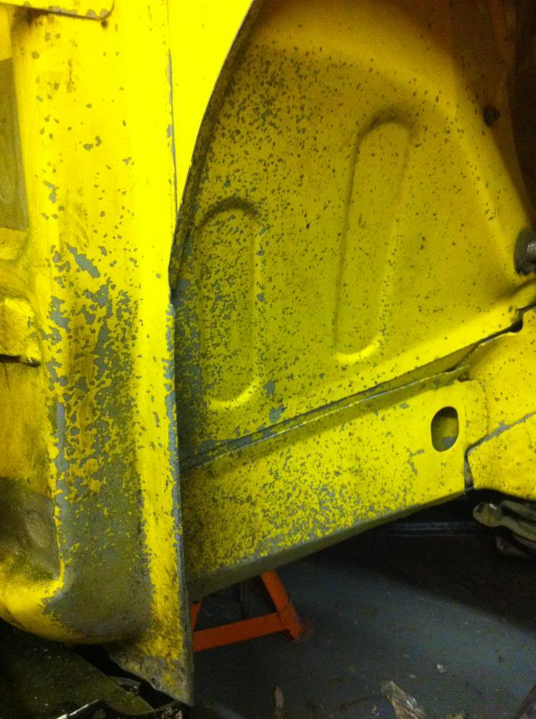

Firstly, gave the arches a good clean/repaint,
Before
After

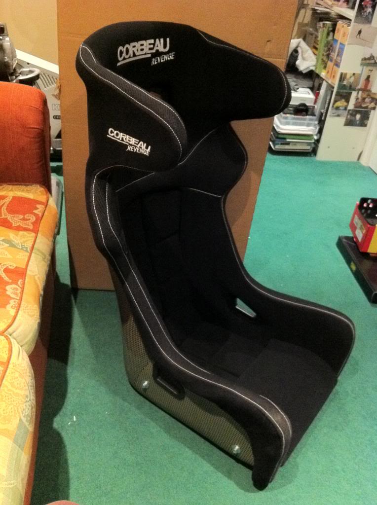

We are currently in the process of making some seat subframe/side mounts for the new seat to replace the old/far to heavy renaultsport ones (pics to follow).
New Chair :eek:

the whole lot is mounted to the subframe
please for the love of god fit a genuine oil filter, i've seen 2 of those ufi ones with failed internals
  Lionel Richie
i just don't get why people fit s**t filters when genuine ones are £5, why risk destroying your engine by fitting a £4 non genuine filter, madness!
  Clio Cup Racer
Sure that was from Opie Oils Fred. No offence but since when does anyone use genuine oil filters - no one I know does. Also don't forget this isn't a road car with a filter stuck on for however many thousand miles - it's a race car and the filter was changed regularly. It's a standard engine too.
Bit strange seeing a thread with your old car but glad it went to good new owners.
  182cup & 172 racecar
I have never used anything but genuine, it's not as if they are £20.
