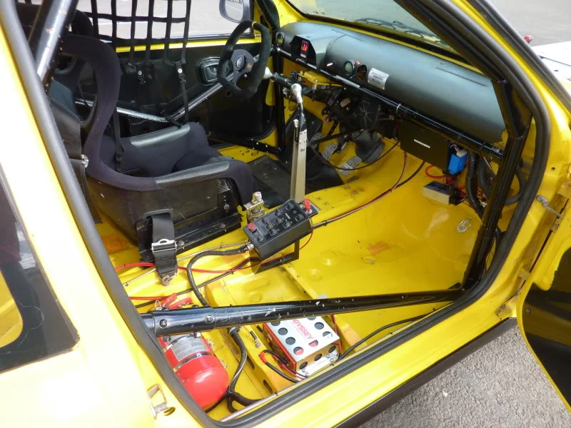

I managed to find a couple of pictures from previous owners...
The current spec of the car is: (Taken mostly from the listing)

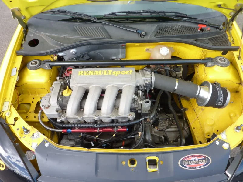

Engine : Clio 182 sealed cup spec engine, Omex 600 ECU. Orbisound exhaust and sports cat.
Bodyshell : 2005 Lhd shell refinished inside / outside and underneath in 2k Renault Yellow. Around 900kg. Front strut brace. Electric power steering.
Gearbox : Sadev 6 speed sequential , Flat Shift ( Full Throttle ) Dog Engagement with Limited slip diff. Illumenated dash shift display.
Suspension : Renault Sport Cup spec non adjustable Bilstein Dampers. Modified Cup spec rear beam , Modified front Lower arms.
Brakes : Clio 182 Sport Calipers with Competition Mintex Discs and Carbone Lorraine RC6 and RC5+ pads, Goodridge Hoses and all lines throught inside of car. Brake balance adjuster.
Interior :. Renault Sport master console to right of driver with all necessary switches ie. Masterswitch , ignition , start button , wipers, indicators, fan, screen demister etc. Switch for power steering. 1 x Corbeau Race seat , sabelt aircraft 3" Harness . Full manual Fire Extingisher system. XAP isolator. Spa fuel guage. Spa Dual Oil Pres/Oil Temp. Spa Dual Water Temp/Volts. Geartronics gear indicator.

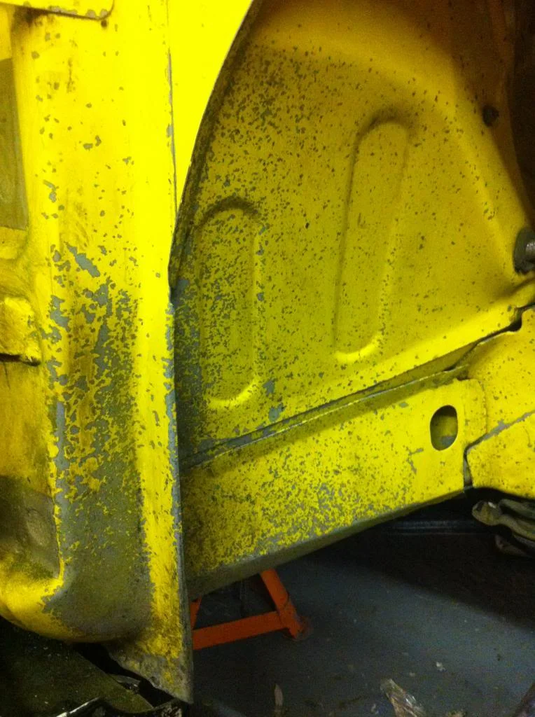

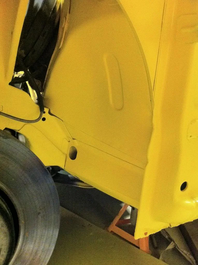

Firstly, gave the arches a good clean/repaint,
Before
After

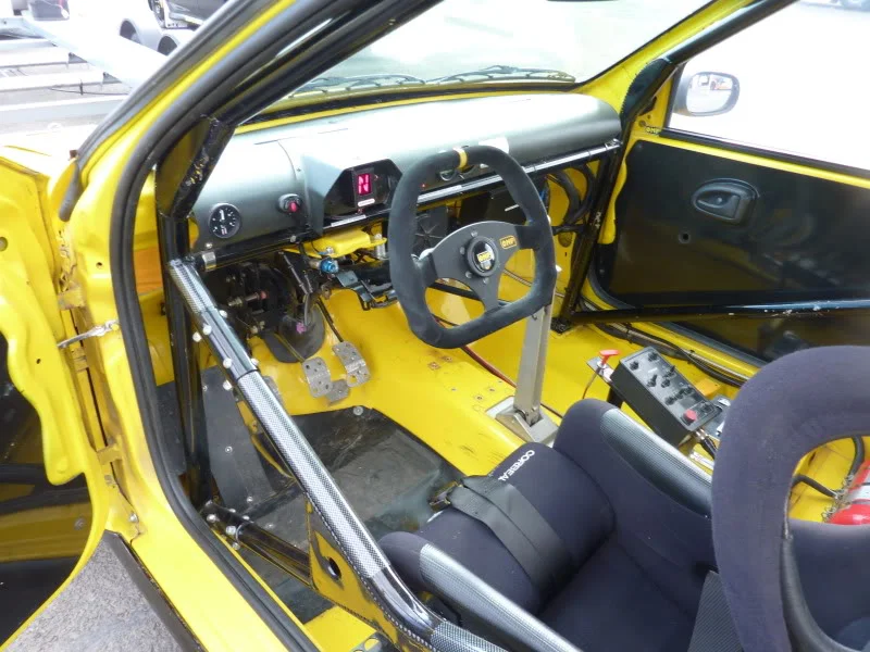

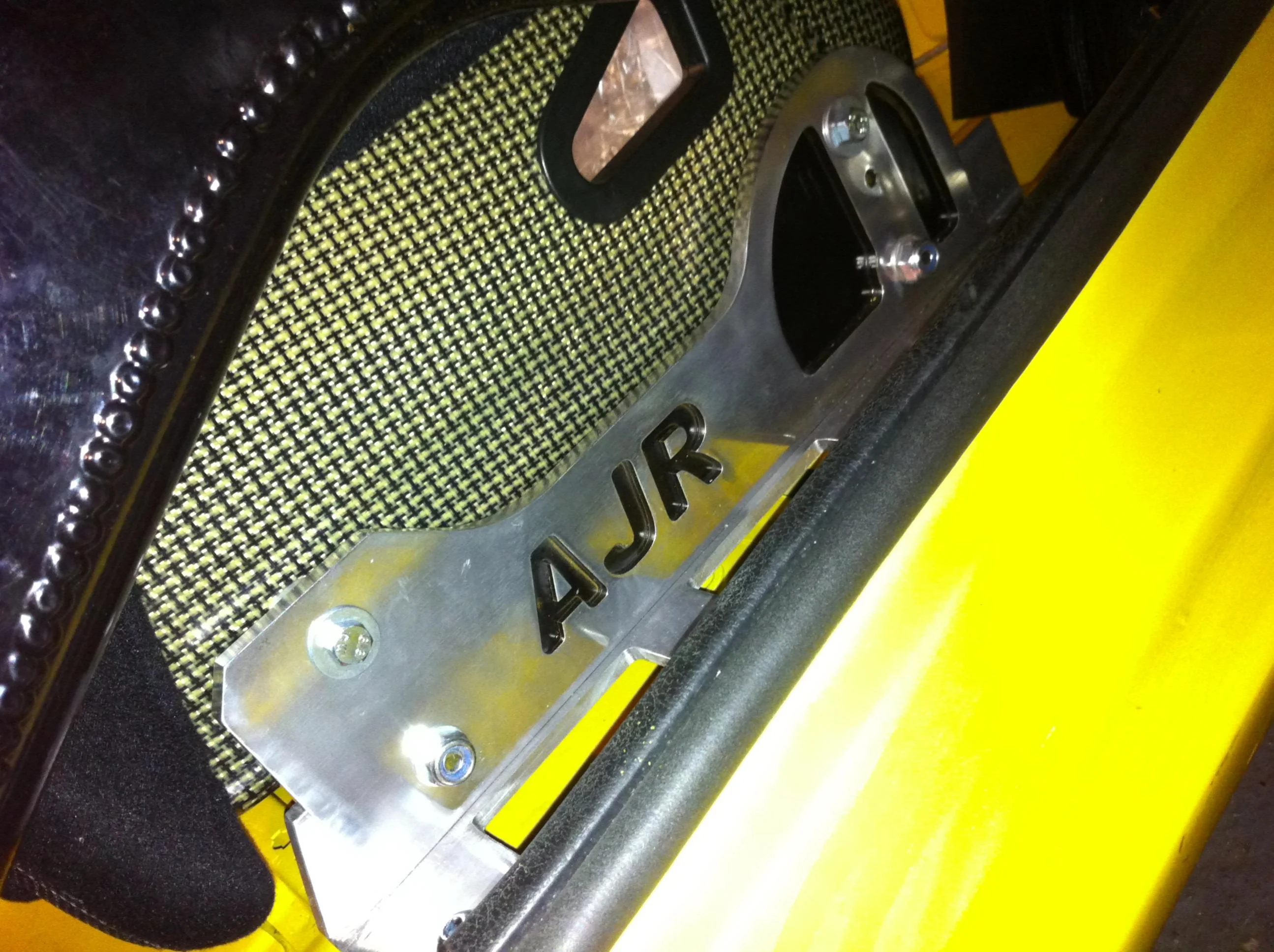

We are currently in the process of making some seat subframe/side mounts for the new seat to replace the old/far to heavy renaultsport ones (pics to follow).

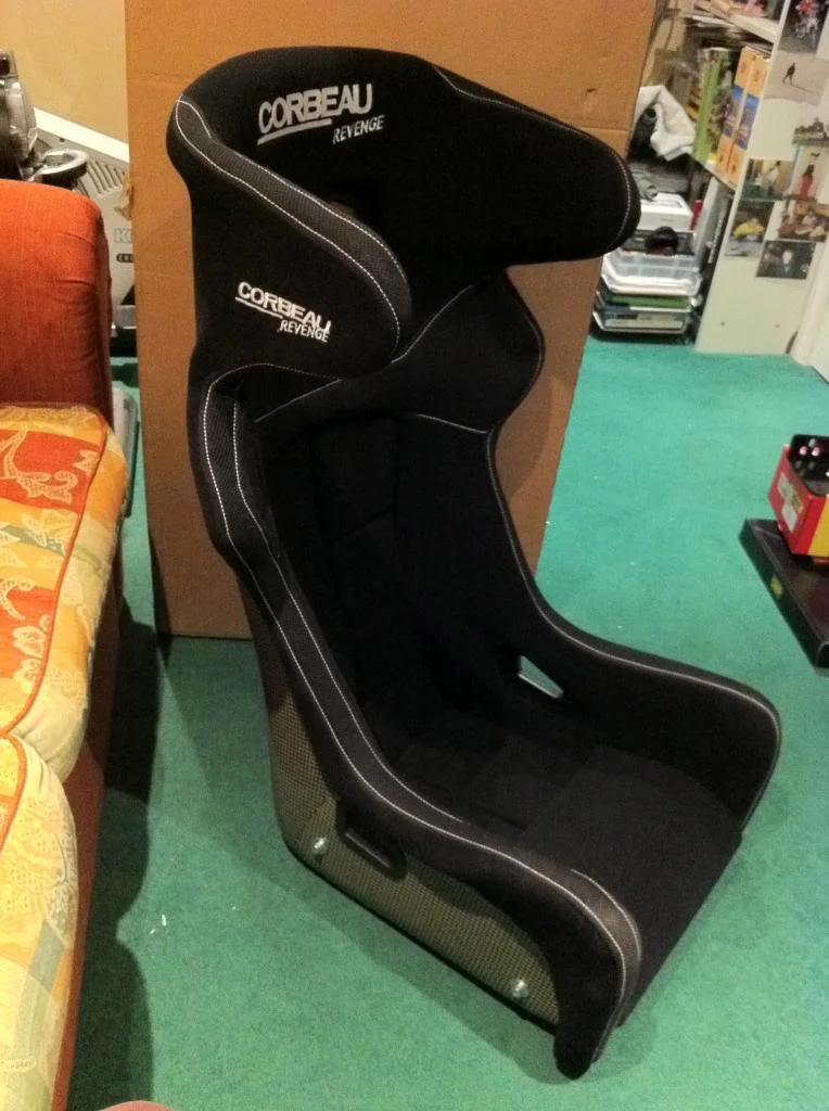

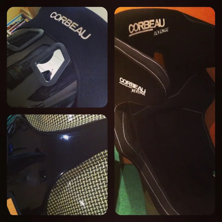

New Chair :o

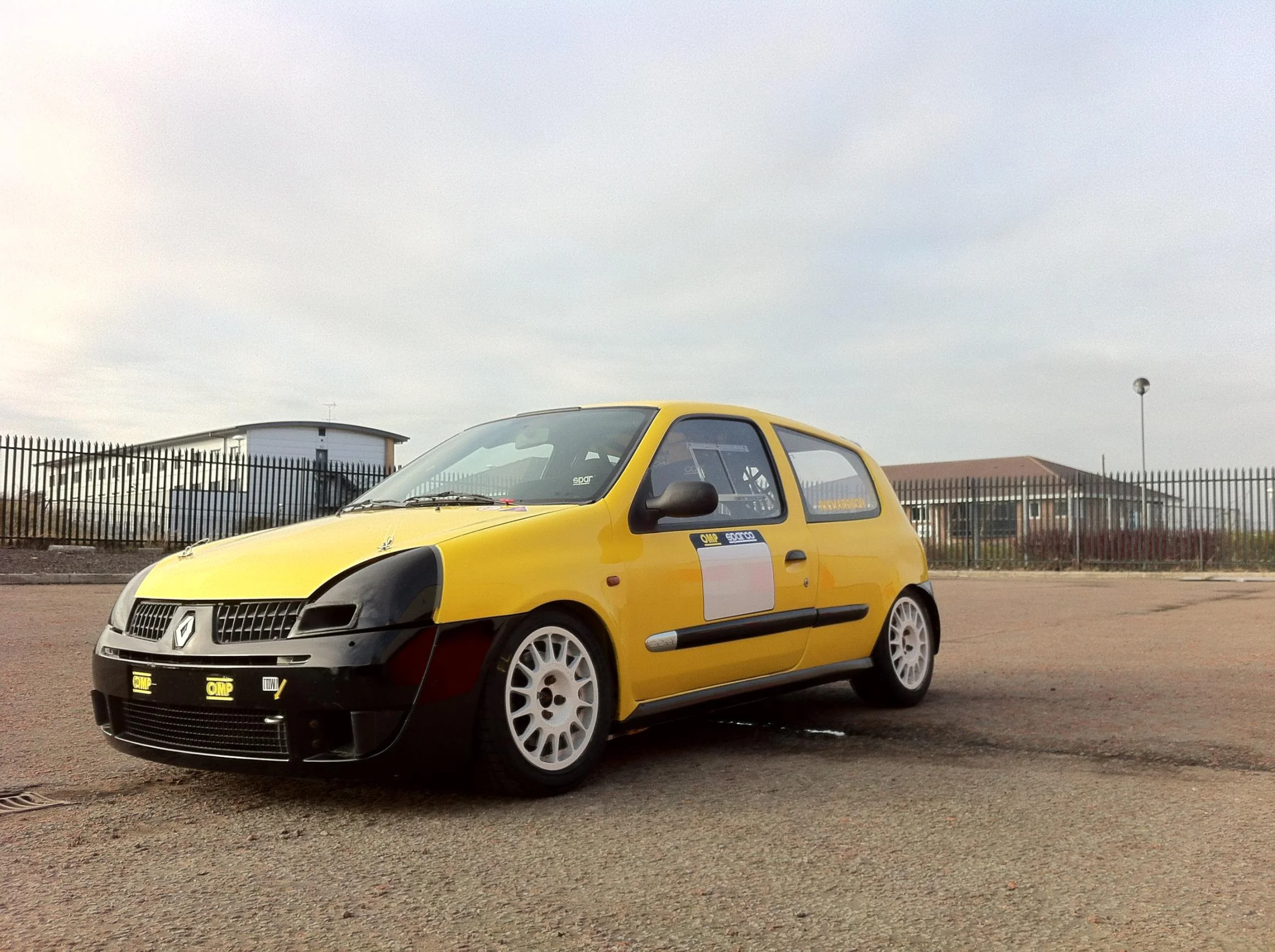

Finaly got the clio ready for its first outing at Anglsey on the 17th Feb.
Since getting the car we have:
Put in two new seats on new mounts
Tidied Wiring
New fuse & relay box
New wheel and spacer
and a few other little bits.
Here are a few pictures from before we went, more to follow...
