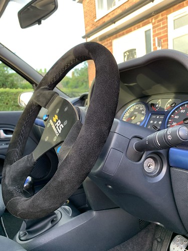

Managed to grab a RS Sabelt steering wheel and sell the RS performance one pretty quickly, definitely feels nicer to grip, I will give the interior a good detail soon as this great weather improves.
Even with the two SRS resistors fitted the SERV/Air bag light illuminate so I will try bending the contacts on the themselves to make a better connection.

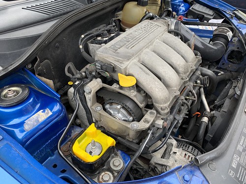

Since September I have fitted the cambelt kit, water pump aux belt all genuine.
-Oil service
-Spacers back on the front
-Brake fluid change
The water pump was fun to remove there really isn't much room, i found it easier to lift the engine nice and high, lots of wiggling a bit of swearing and its out.
Its old gasket took over an hour to fully get off using a small Stanley blade.
Definitely worth having all the correct genuine tools at first i thought it would be ok to use just the crank pin + horse shoe.
The engine became out of time once tensioned no matter how many try's timing it up, the cam pulley lock was essential.
locking the cam pulleys and being able to take the slack out of the belt got the timing where i wanted it to be.
After getting the engine to TDC numerous times both locking tools went back in without any hiccups.
Hurrah! job complete, the Clio runs/ pulls better than before and a little less thirsty.
Then an oil change + Genuine Renault coolant to complete the job. It's only done 3 thousand miles since the last service.
These little Clio's still look great 20 odd years later.
After checking everything over for leaks etc. All was good so time for the heart pumping moment of starting it up + bleeding any air out of the coolant system.
The engine ran great with the new aux belt tensioned up properly i didn't have the slight squeak previously on cold starts.
A little blast up the countryside made me realize how much i missed this car the engine pulls great and defiantly feels better in the midrange power wise.
