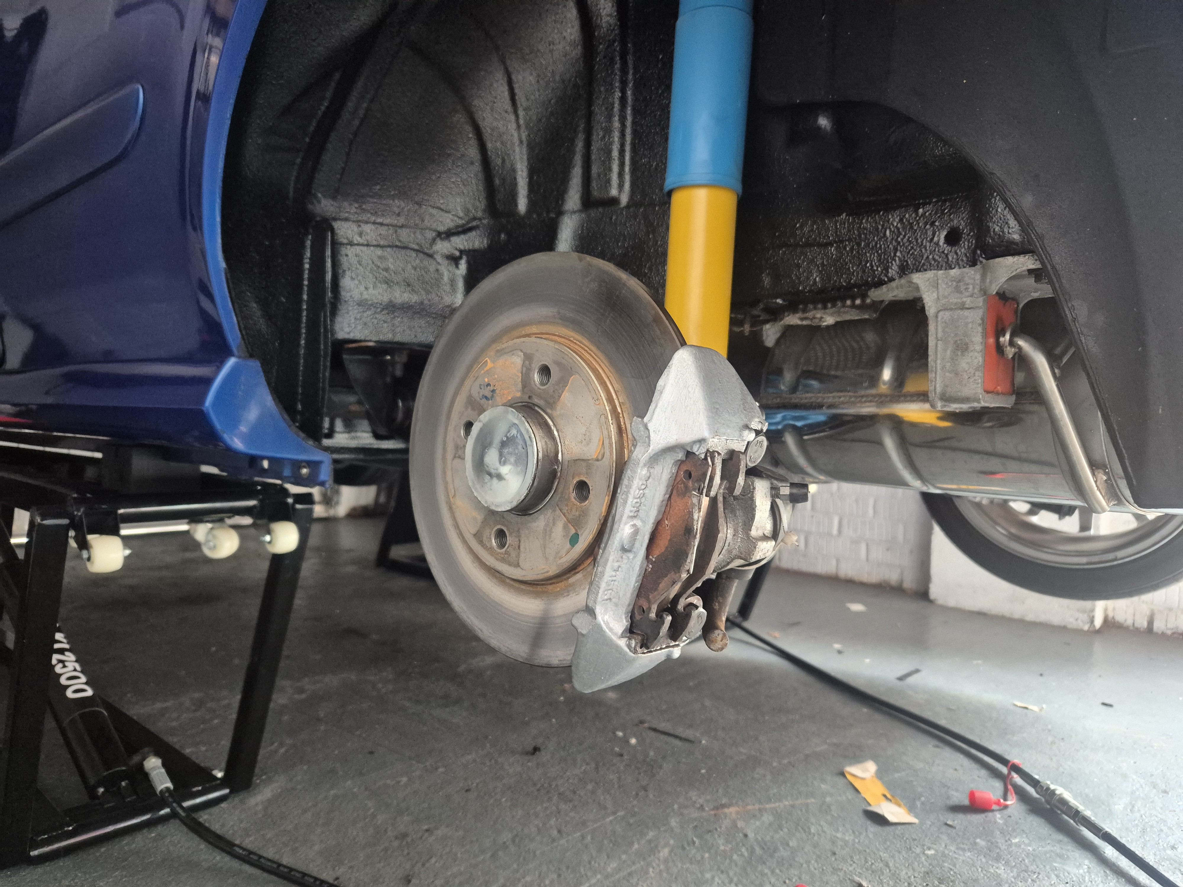

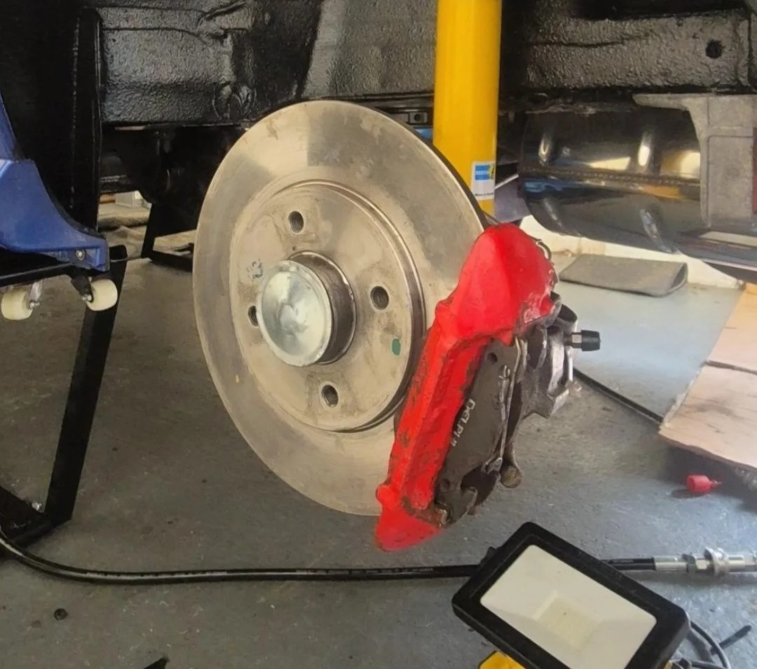

Fitted a caliper I bought of @SKINTasPER earlier in the week. They ideally need a rebuild but I needed to see if I could solved the knock from the rear passenger caliper that's been haunting me for weeks now.
Yes it's red and will be getting painted.
Buttoned everything up and off we went.
Bilsteins fitted as they came out the box. The rear needs tweaking as it's sitting slightly higher than I'd like.
First impressions, the knock seems to have gone! Although I am still waiting for it. I was also hyper sensitive to other noises coming from the suspension I'd just fitted. But I didn't hear anything, well, other than the usual clio rattles.

Took it for a slightly longer drive today, rather than up and down my street.
Bilsteins have really impressed me. Smoothed out the crashy ride. It's firm but not overly. Considering the fitment is how they came out the box (measured to check the fronts and rear were equal to each corner), I'm happy with the height too.
The knock from the rear has also (holding my breath!) GONE. Everytime I was braking at slow speed I was waiting for it, but it does seem to have stopped. The brakes do need another bleed.

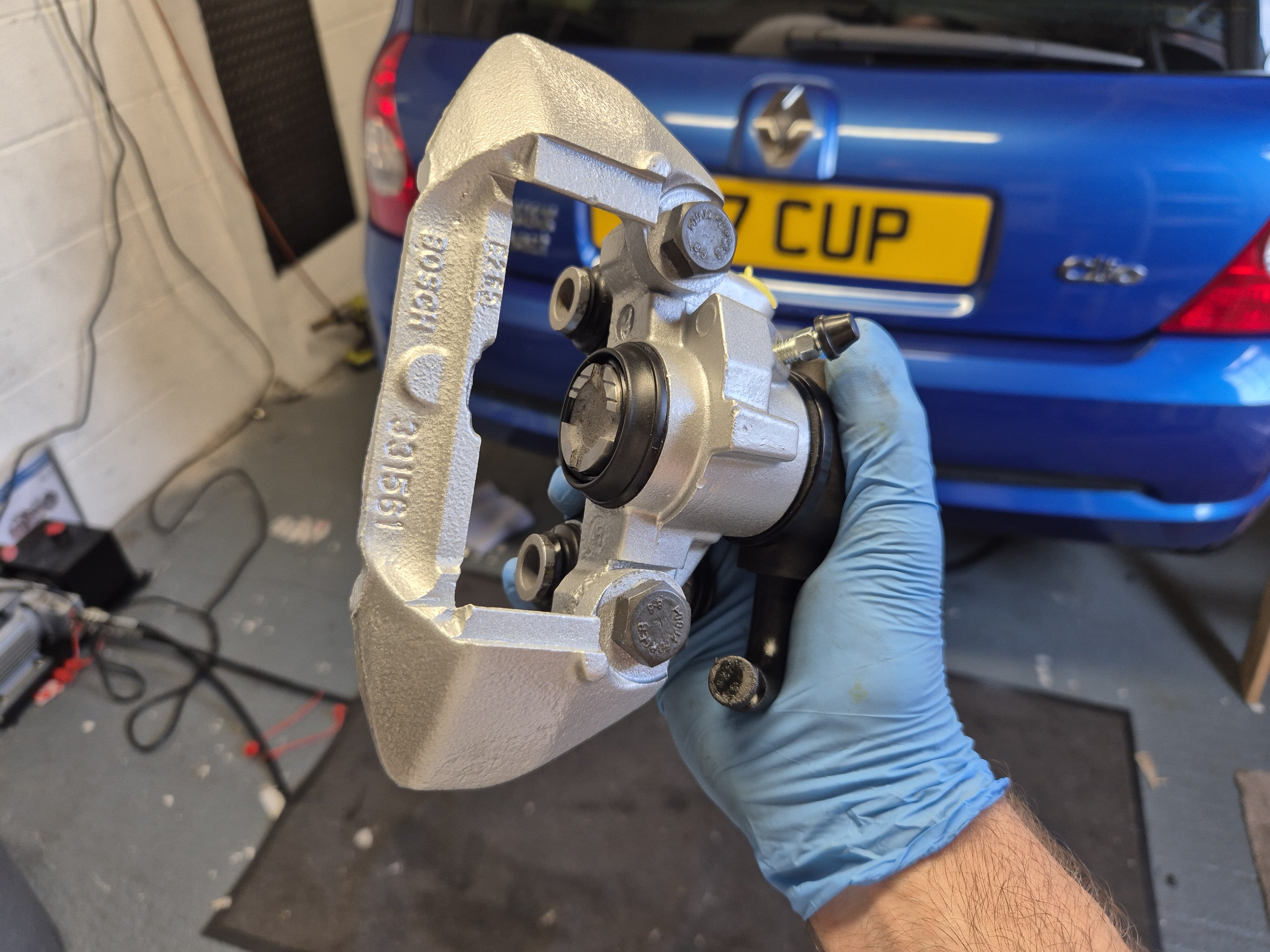

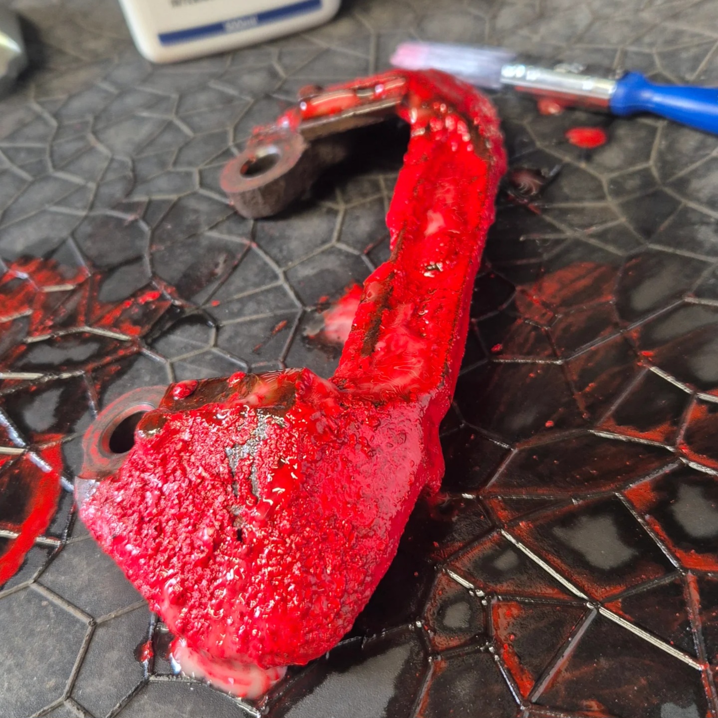

The one odd caliper wasn't doing it for me.
Stripped
Repainted
And with all that, I'm pleased to say the knocking has gone! Cheap caliper was at fault all along.

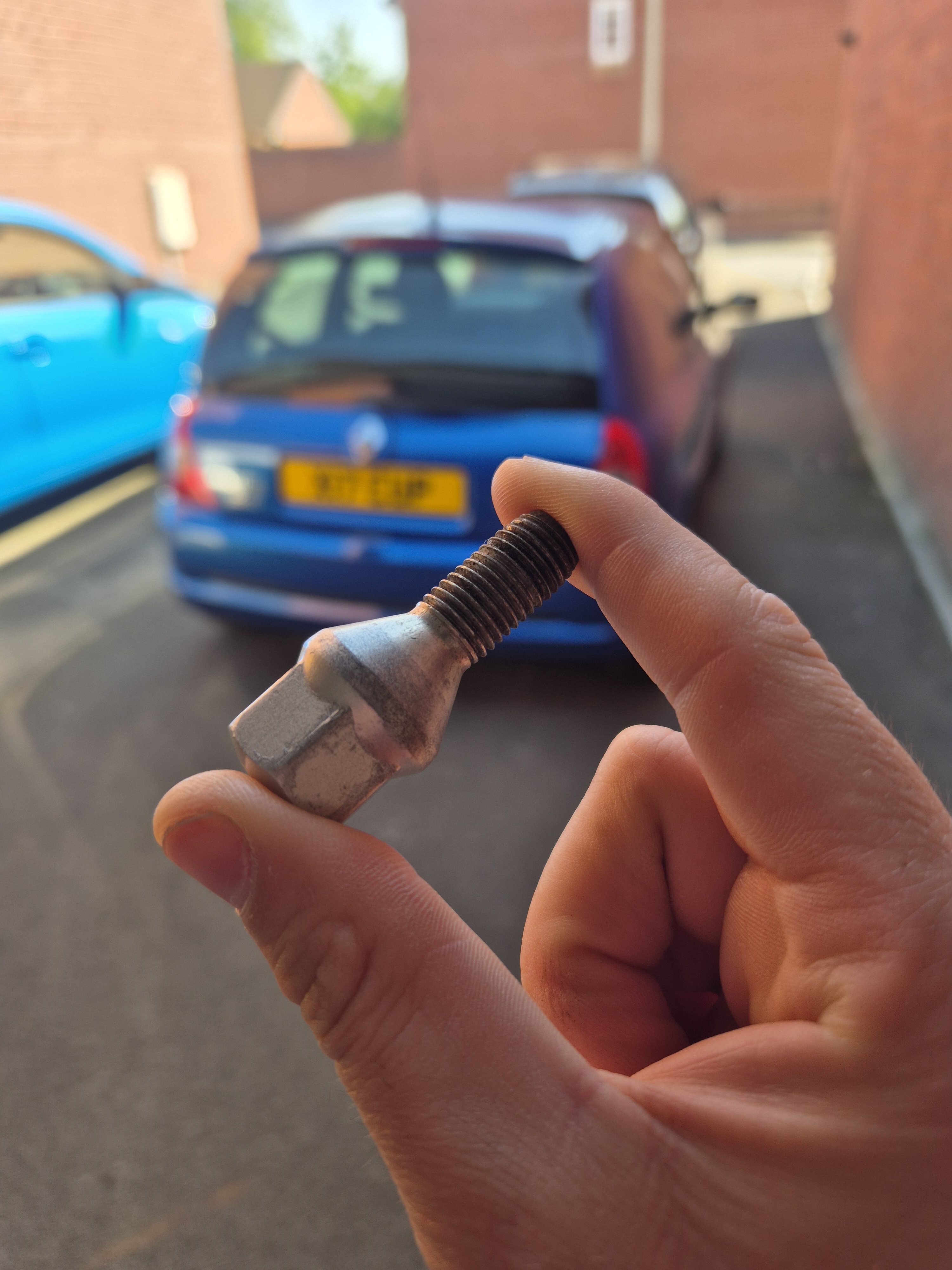

The collar in the locking wheel nuts had broke so I wanted to fit the standard bolts. I had 3, no idea how I'd lost one, but I had.
Put a shoutout on here in the wanted section and @Krarl came up with the goods. Sending me one in the post.
Yes, this update is about a wheel bolt.
Final piece to the puzzle.

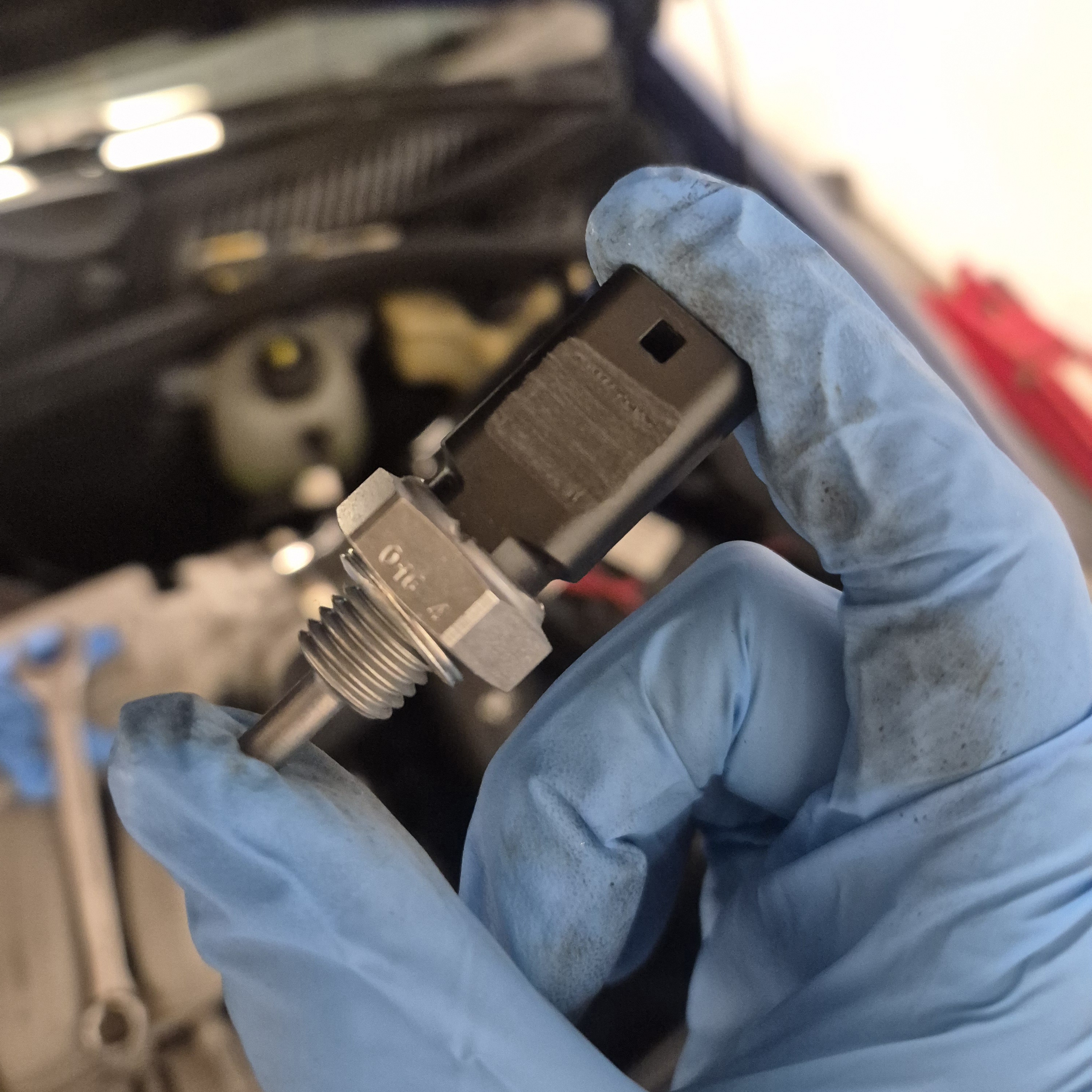

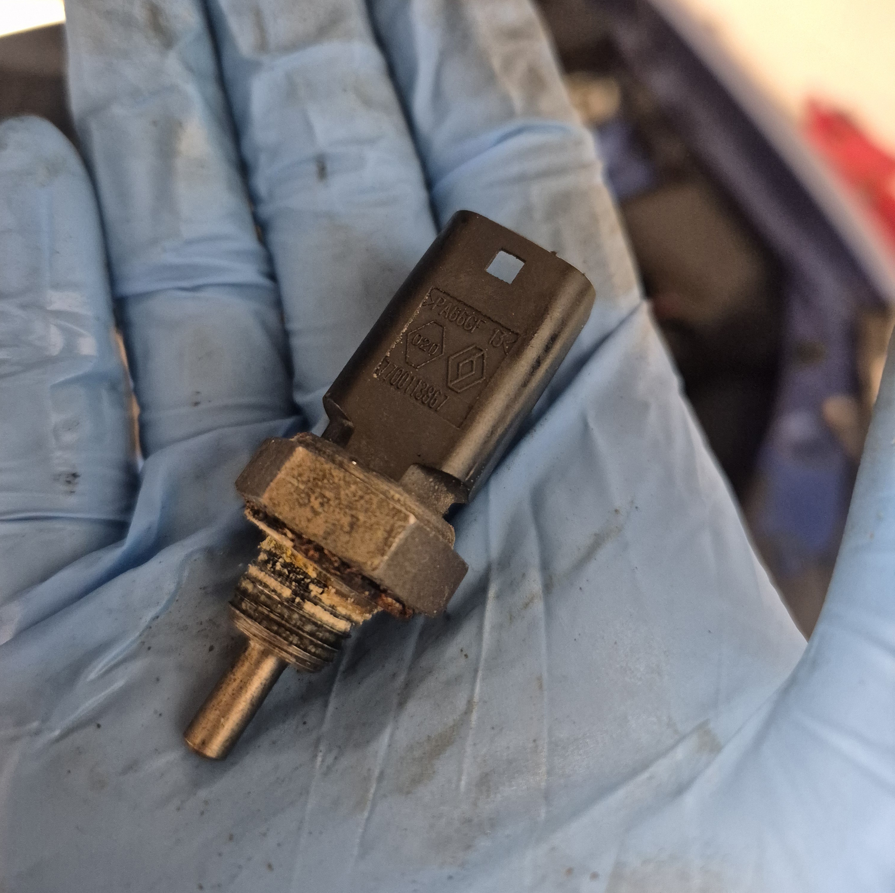

Fitted a new CTS as the temp needle sits just above half way, even before doing the thermostat and radiator, it's always sat just above.
I've noticed that hot starts it doesn't turn over as sweet as it does from a cold start and also MPG hasn't been the best. So hopefully this remedies it.
Old (obviously)
New one arrived from Autodoc.
It looks to be an OEM part with the mark scratched off. It's a FEBI item.
Not tested yet, will update.

Nissan do the exact same CTS as the Renault part. It retails just under £25 inc vat if you get any problems with the Febi
Went for a drive in the Clio last night and.... No change. Needle sits just above 90. It doesn't ever fluctuate and the only real reason I changed it is I read here that a dodgy CTS can cause hot start issues.
It's not that my hot starts are THAT bad, it just feels marginally lazier than a cold start.

Fitted a new one when I did the rad and coolant change.
It was the same (just over 90) before I replaced the thermostat too. It doesn't fluctuate or anything, I'm OK with it. I just wanted to see if it would fix the slightly lazy hot start.

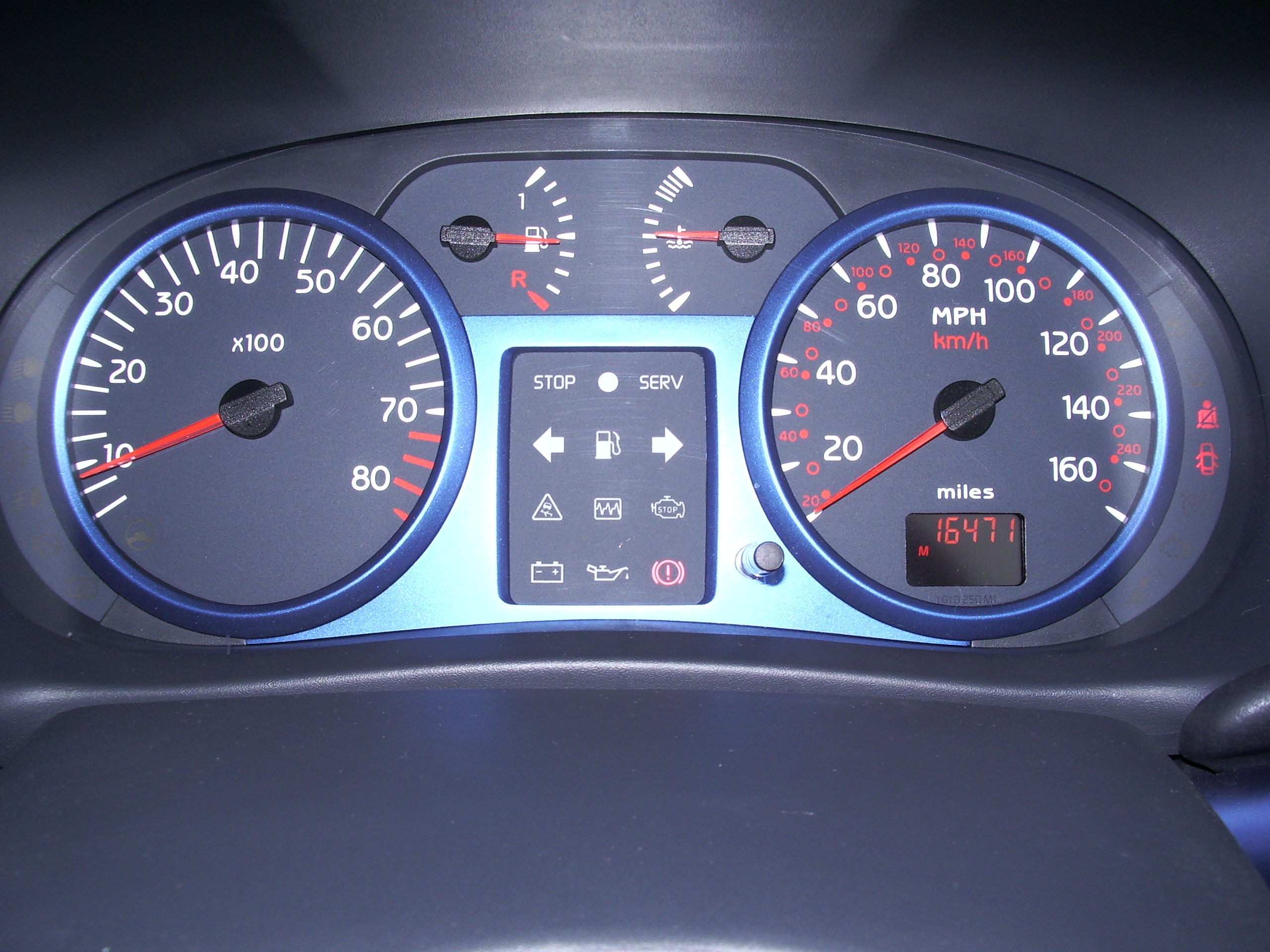

This is where mine sat when I bought my car. It sits slightly above the middle although could be the angle I took the picture.
How far above the middle does yours sit?
Thats normal/correct temp gauge position for these, every one ive driven lands in the same postion when fully up to temp. The cts rarely fails from experience, lower readings are due to weak thermostat.
Longer crank when hot could be due to fuel system or tdc issues at a guess.

The rear knock that plagued me for so long was down to a faulty reproduction caliper. I sourced a second hand one from here and it fixed my knocking problem, however it came with its own issue. Whilst painting it silver, I noticed the seals were shot.
So I sourced a reconditioned OEM caliper through 'the brake specialist' on ebay, and used this caliper as a surcharge against the freshly rebuilt caliper.

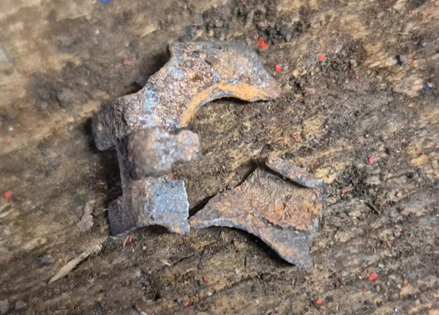

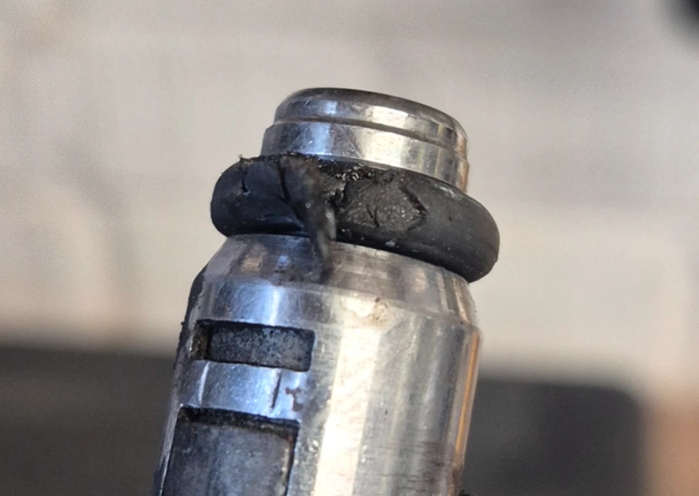

I opted to start with the fuel. Now, on page one of this thread I said I'd fitted 4 new injectors. What actually happened was I did buy 4 genuine injectors but as it was only one that was faulty at the time, I replace that one with a spare I had knocking around that I knew was good.
Flash forward to today and I swear your honor, I have indeed fitted the four genuine injectors. I'm glad I did as the one injector, the seal looked like this....
and the retaining clip fell apart in my hand

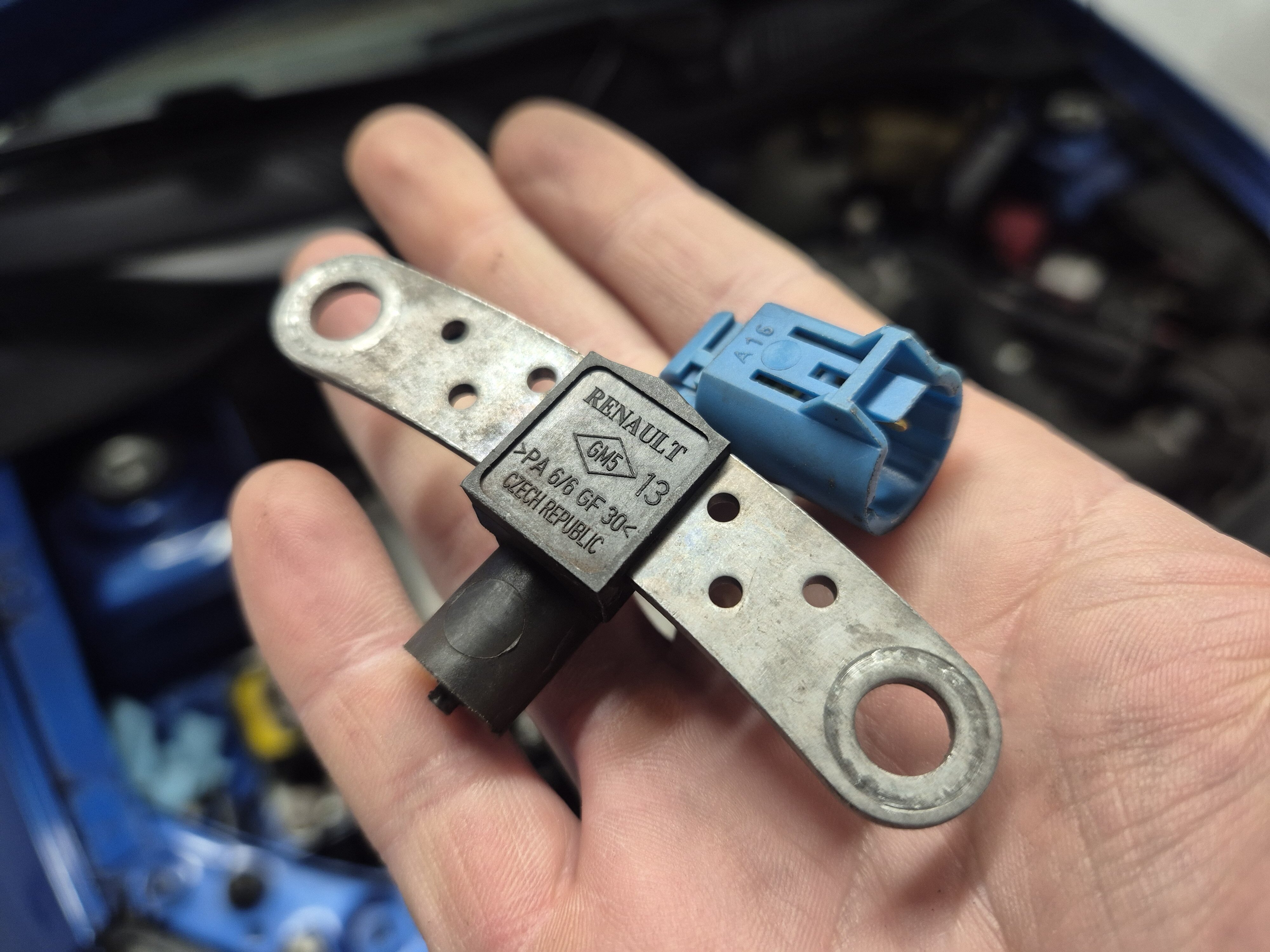

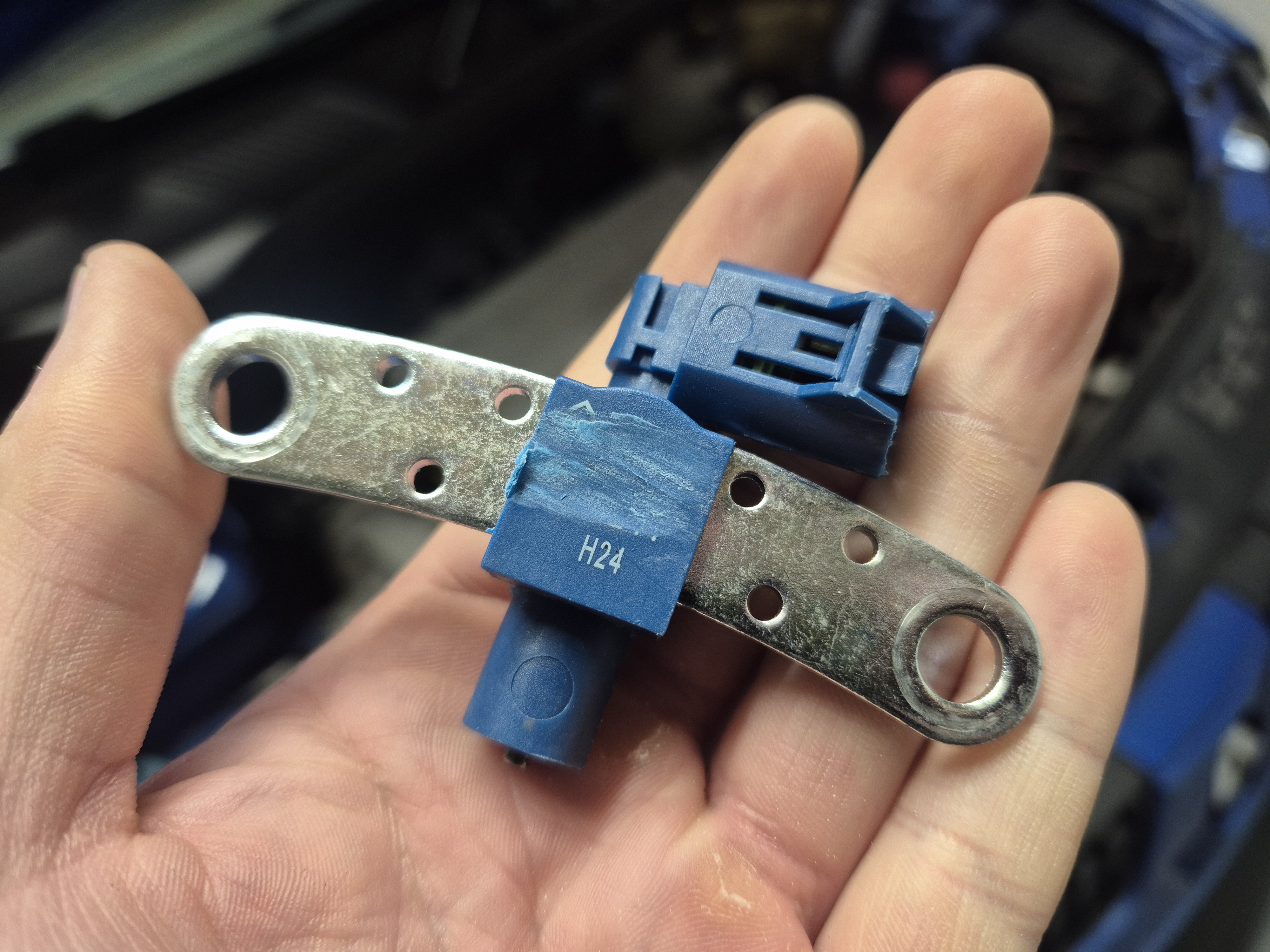

I also fitted a crankshaft sensor. The one on there was a blue plug one, but I found this Febi item for sale on ebay, brand new for £10. Got to be worth a shot?
Old one
New one
*squints to see what's been etched off*

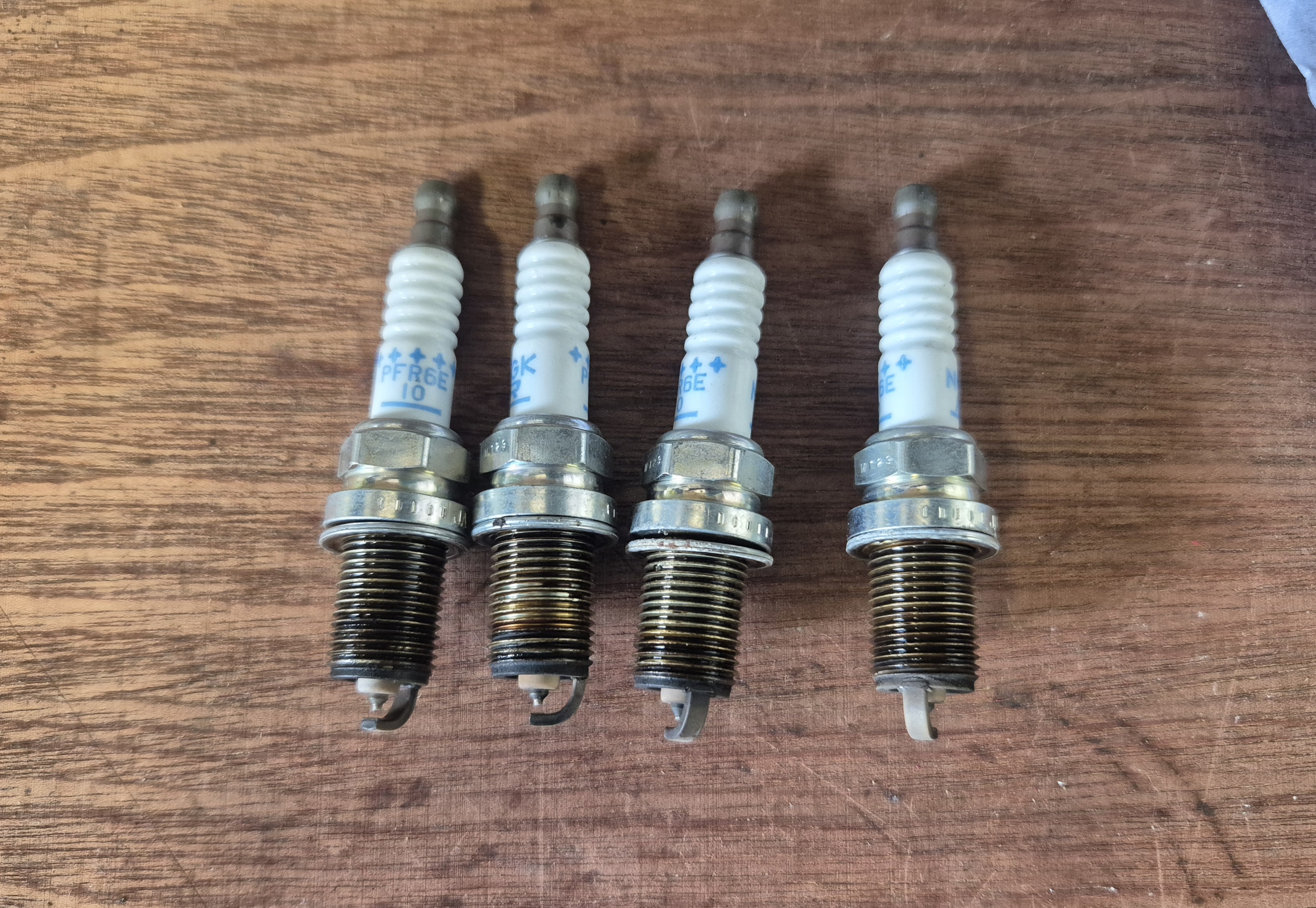

Spark plugs.
These are the ones I removed and look pretty good and I felt a bit of a mug replacing them, but I did. When removing them, two were quite loose, almost finger tight.
Dropped in a fresh set
Cold start it seems to have a bit more gusto or feels stronger in starting. Placebo, possibly.

Plugs always come loose on f4r if not torqued to spec. 28nm from memory, so need to be a bit tighter than usual.

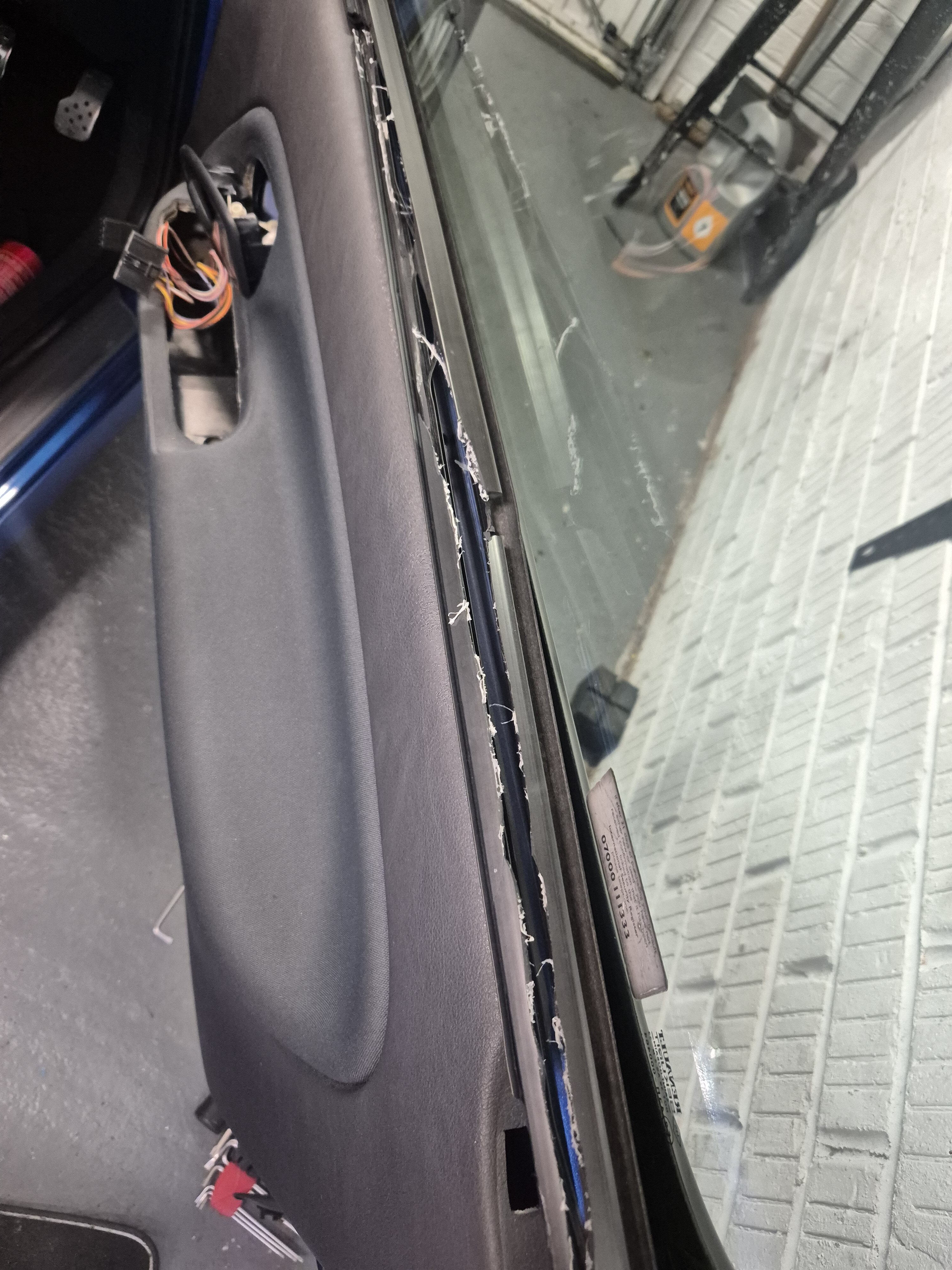

The inner door seal thing cracked a while a go and my OCD couldn't deal with it.
I had tried to glue it but it looked s**t.
Picked up a fresh one from a breaker.
