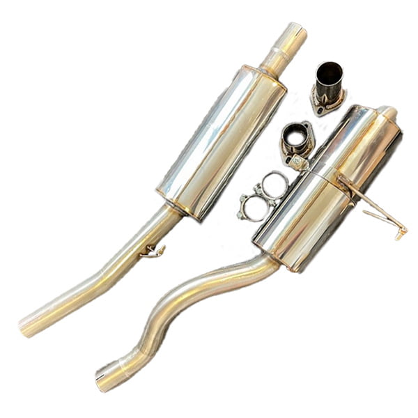

One thing I've noticed recently is how boomy or droney the exhaust is. It's a stealth KTEC resonated exhaust, sounds fine when going for a rip around some b roads but on a motorway journey or sustained 60/70mph my god, it's awful.
Recommendations for something not as droney?
I'm pretty sure mine is the same system, and it isn't droney at all. It is however, pretty loud, and definitely more raspy than typical. But it also has a sports cat rather than the standard cat. In the past on my 182's, I've found that changing from the standard cat to a sports cat makes a big difference to noise, and does add a bit of raspiness.
Honestly, I'm quite surprised how loud my cup is, it has a pretty large resonator and reasonable back box, but it's probably louder than my 3.0 Z4 with the back box deleted and tiny standard resonator. I guess it could be related to the lack of sound deadening in the Clio compared to the Z4 though.
bowen86
I like the KTEC around town or on a blast out. But my god, motorway speeds it's just DRONE.
I guess everyone's tolerance to noise and what they find acceptable is different.

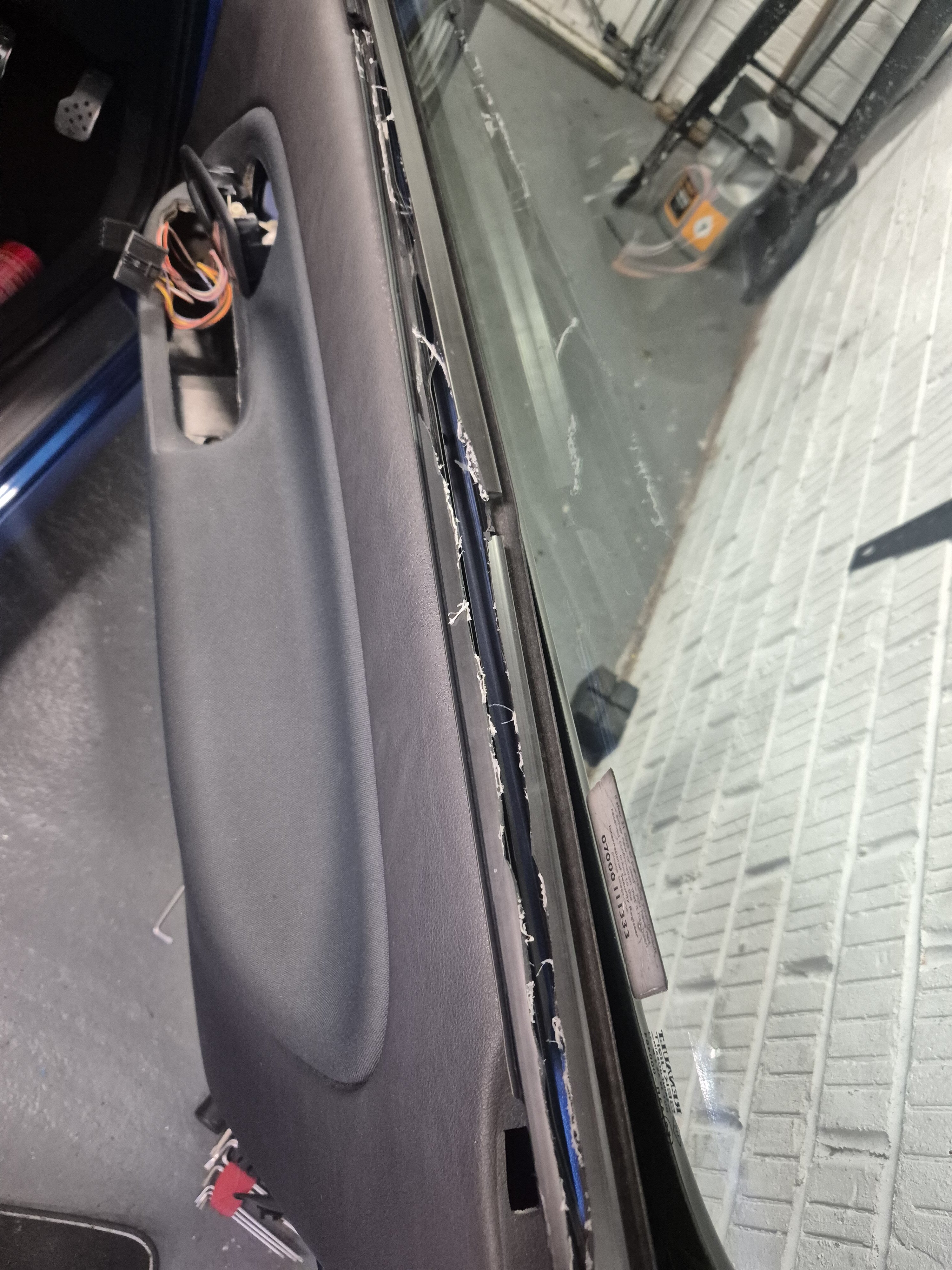

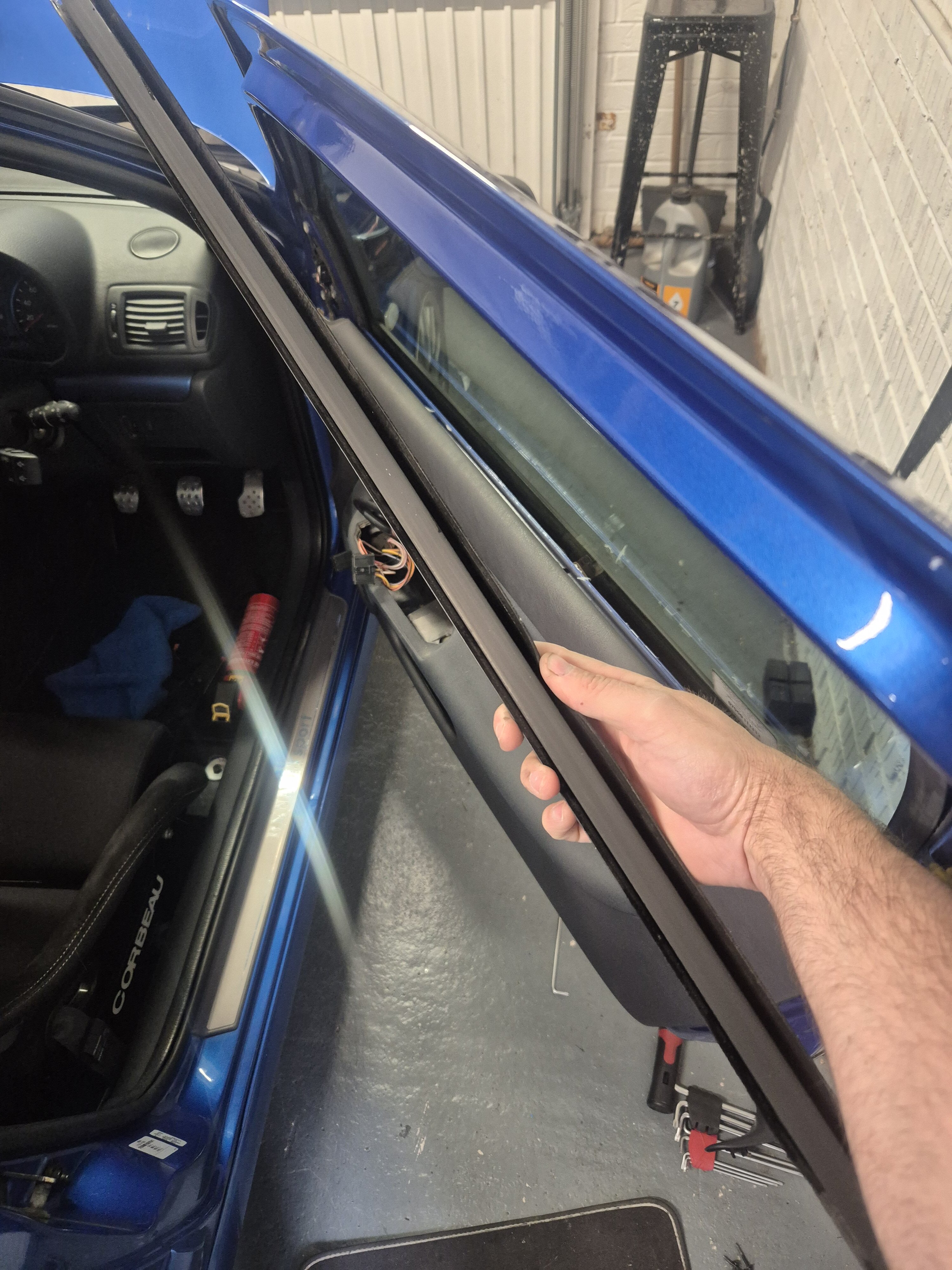

The inner door seal thing cracked a while a go and my OCD couldn't deal with it. View attachment 1743941
I had tried to glue it but it looked s**t.
Picked up a fresh one from a breaker.
I have the same model exhaust. Just mad deep base all the time. I am 45 not 17 so prefer the quiet life now..

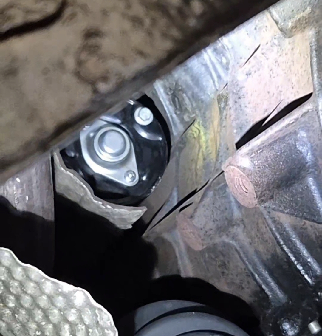

The hot start issue hadn't got any better or worse, so I bit the bullet and had a new Bosch Starter fitted.

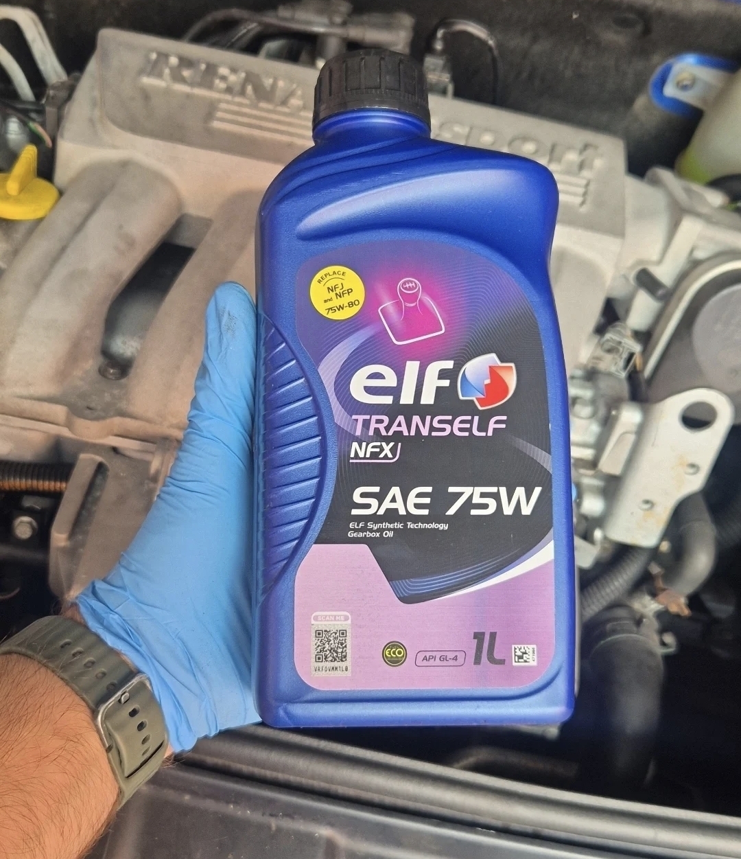

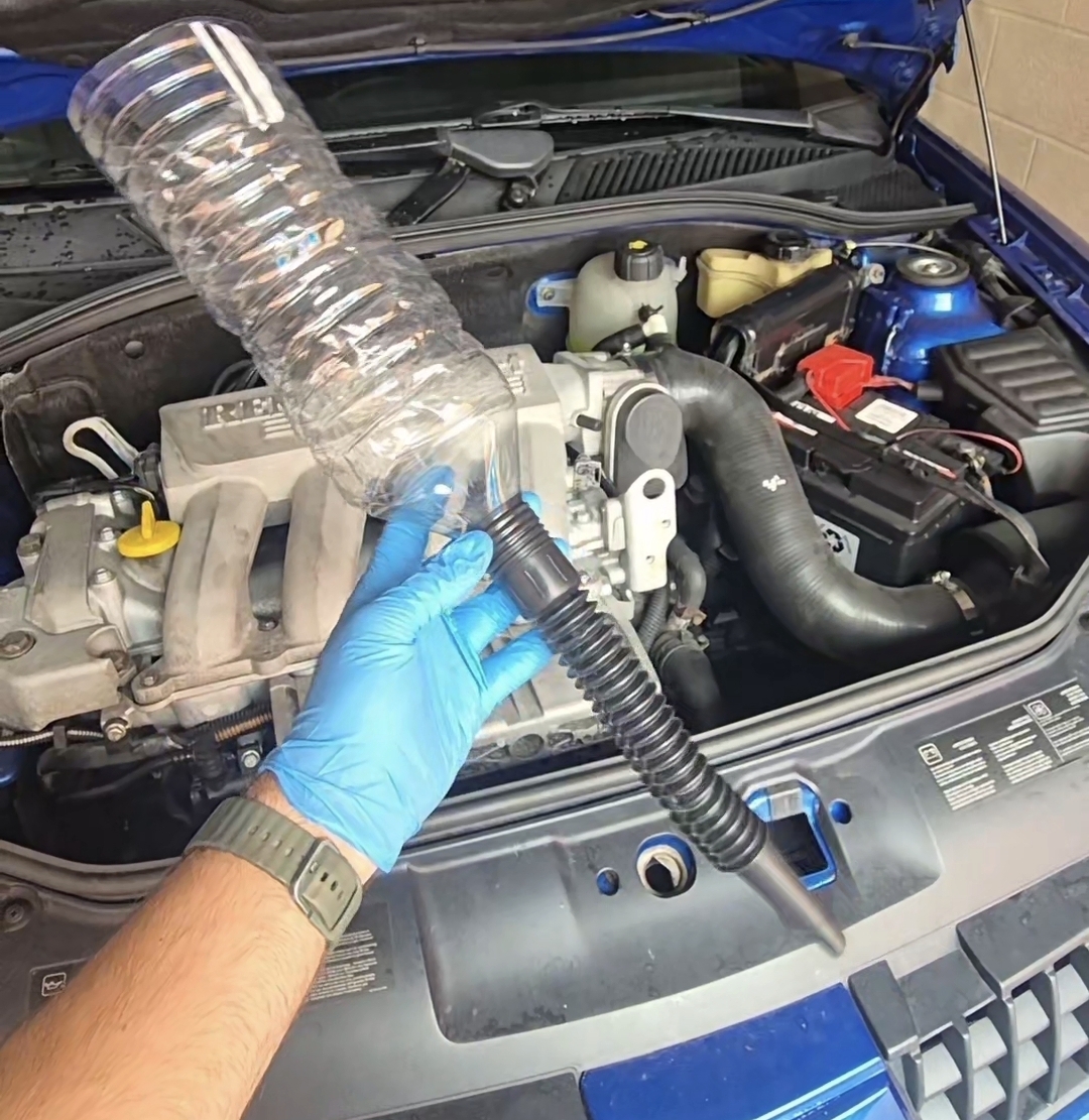

Serviced the gearbox

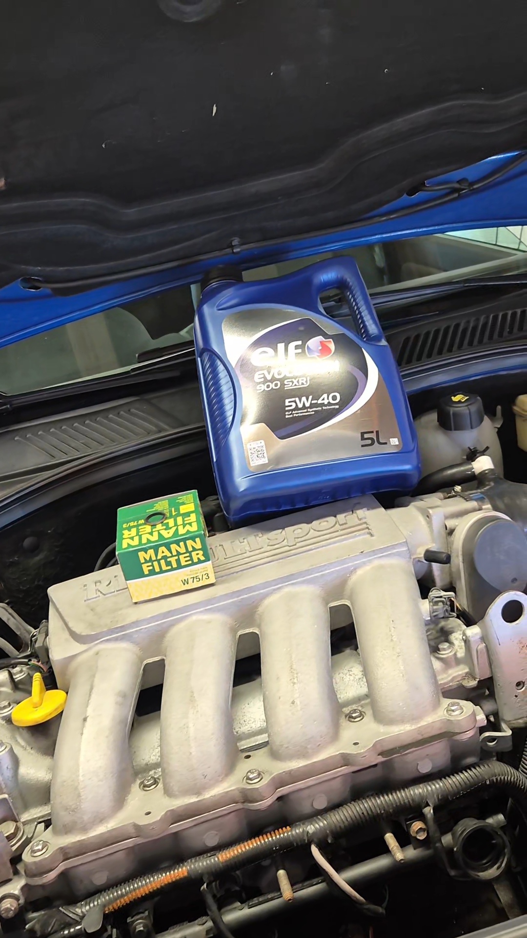

Fresh oil and filter

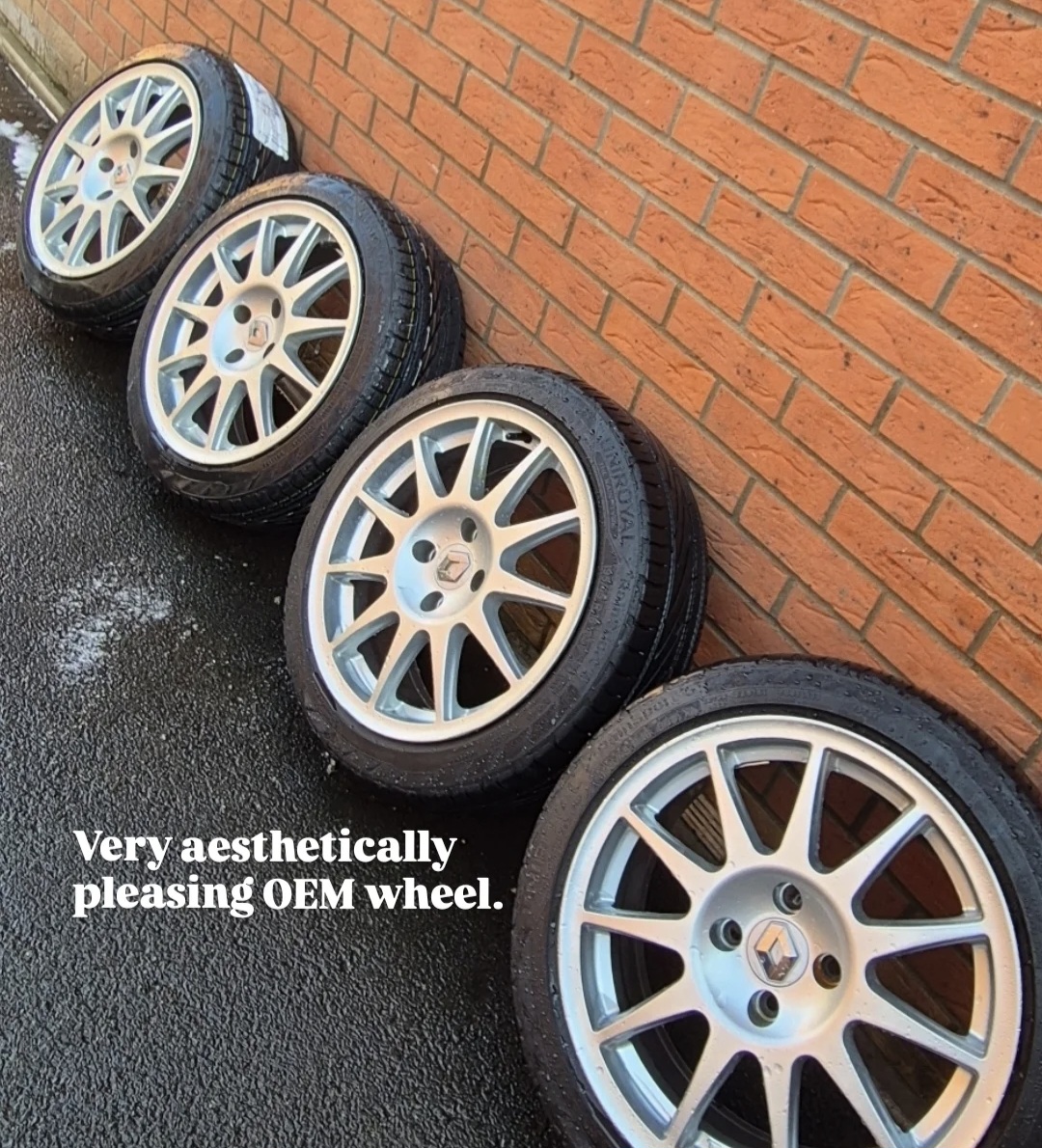

New tyres

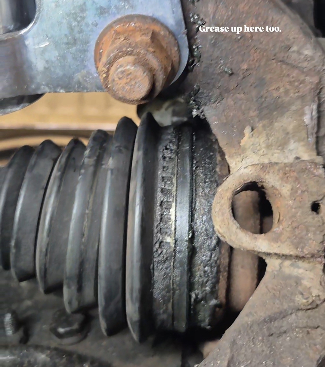

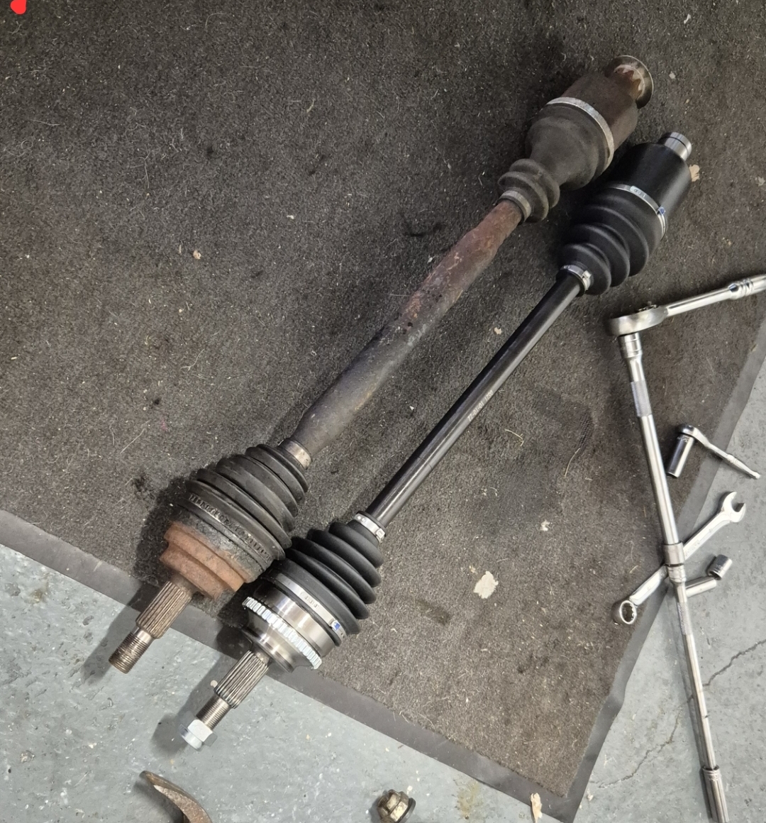

I noticed when washing the wheels the drivers front wheel was covered in CV grease. It looked like the CV boot has slipped off.
I fitted a JR shafted. I've had no issues with these shafts from the previous three Clios ive fitted them too.

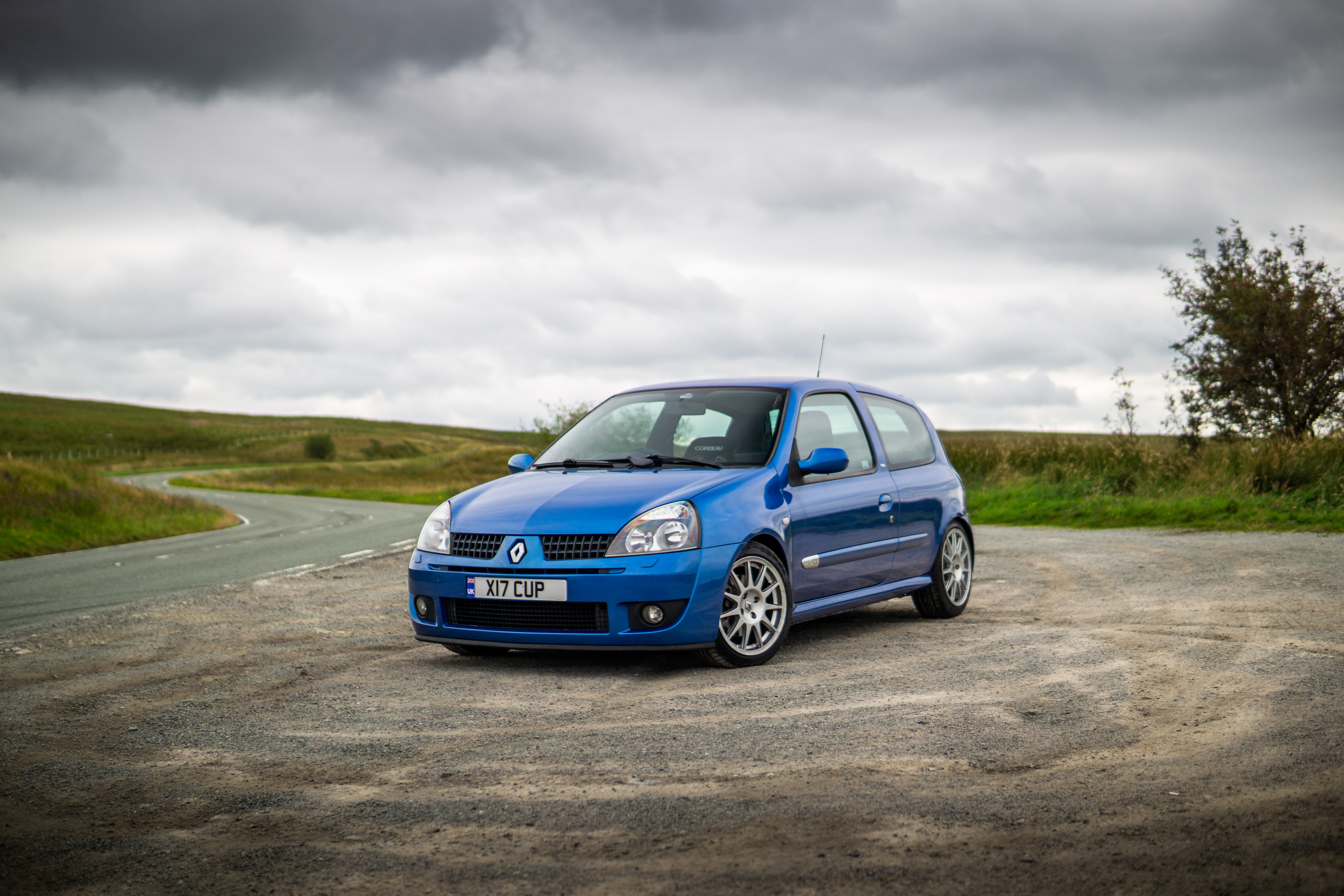

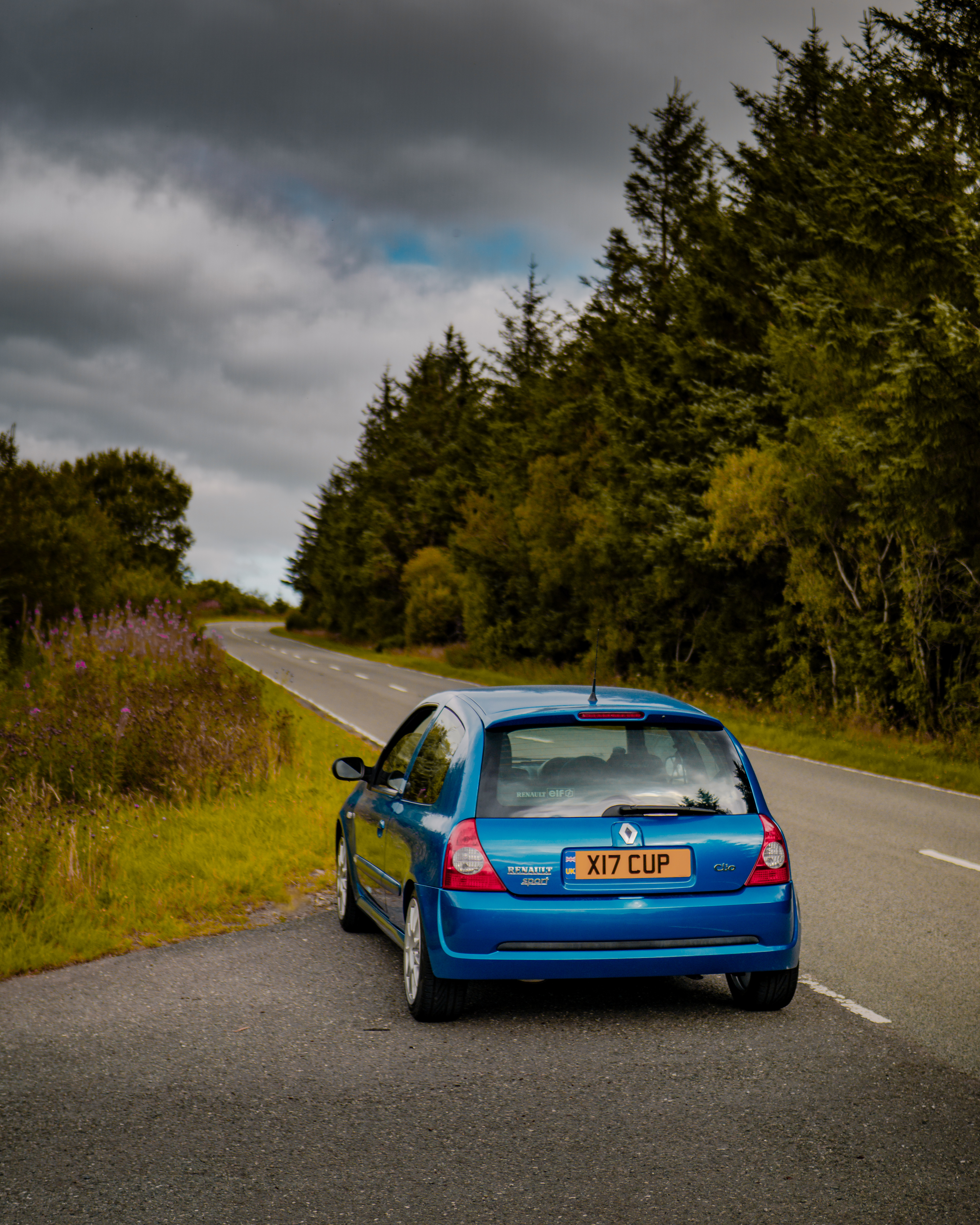

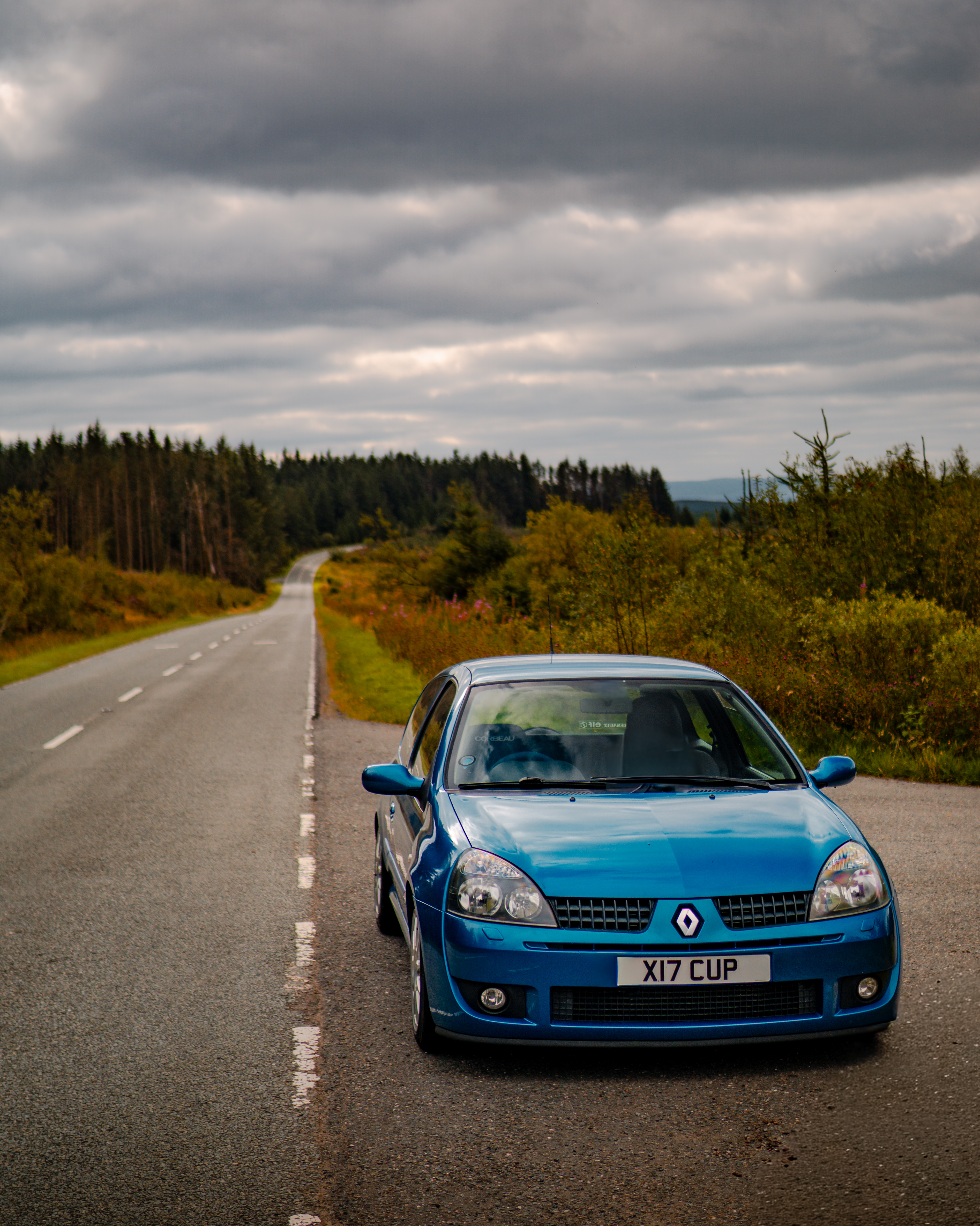

After all the above was done I needed to give it a bit of a shakedown.
So I drove from South to North Wales around the Evo Triangle, horse shoe pass and some of the amazing roads that bless North Wales.
420+ miles to a whole tank of fuel.
Clio was really good. Apart from some rattles and the archliners rubbing on full lock, it was a great drive out.

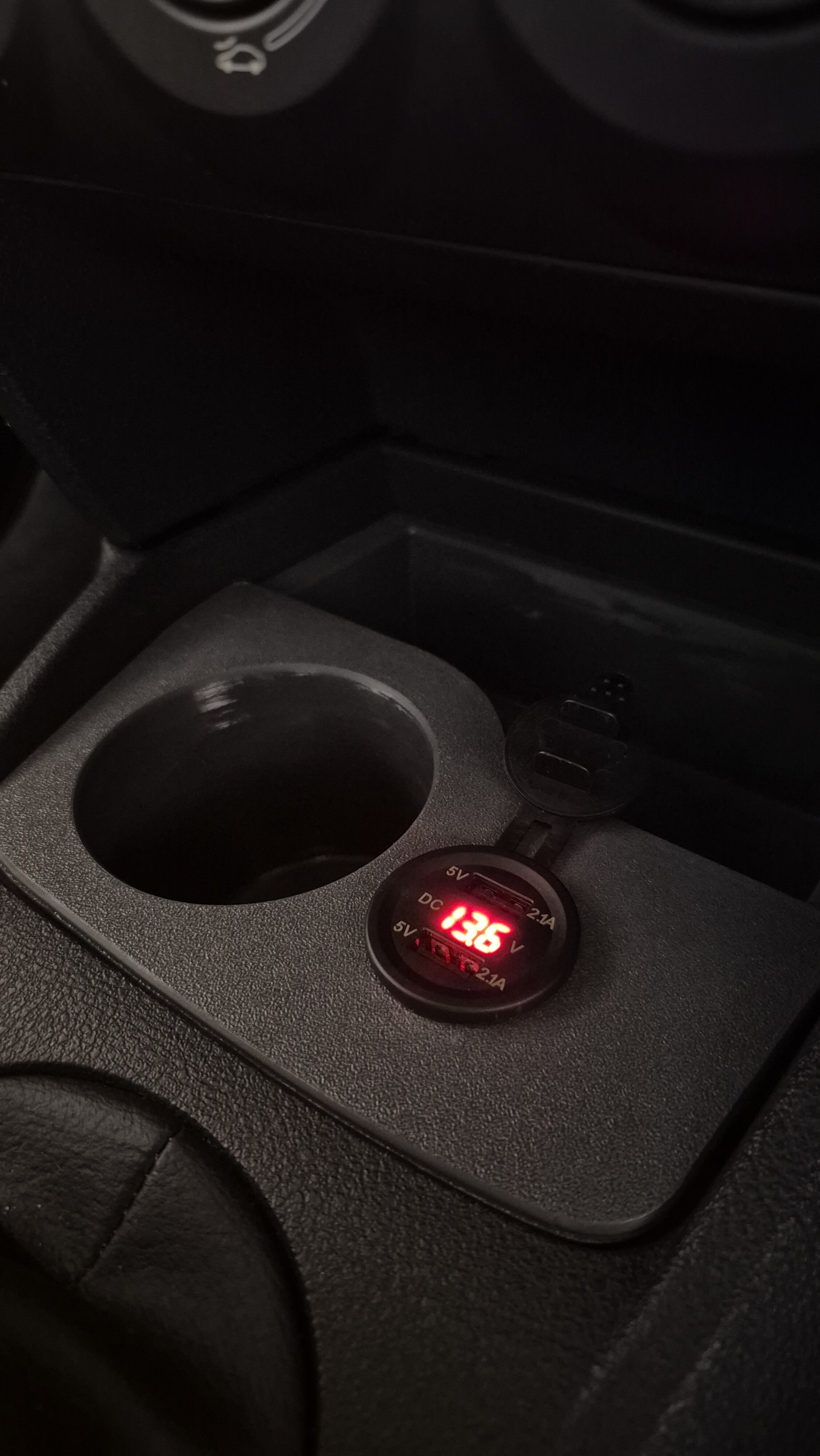

£6 from ebay, cheaper than Amazon. Went for red illumination over blue or green to at least try and blend in with the dials and look kind of OEM.

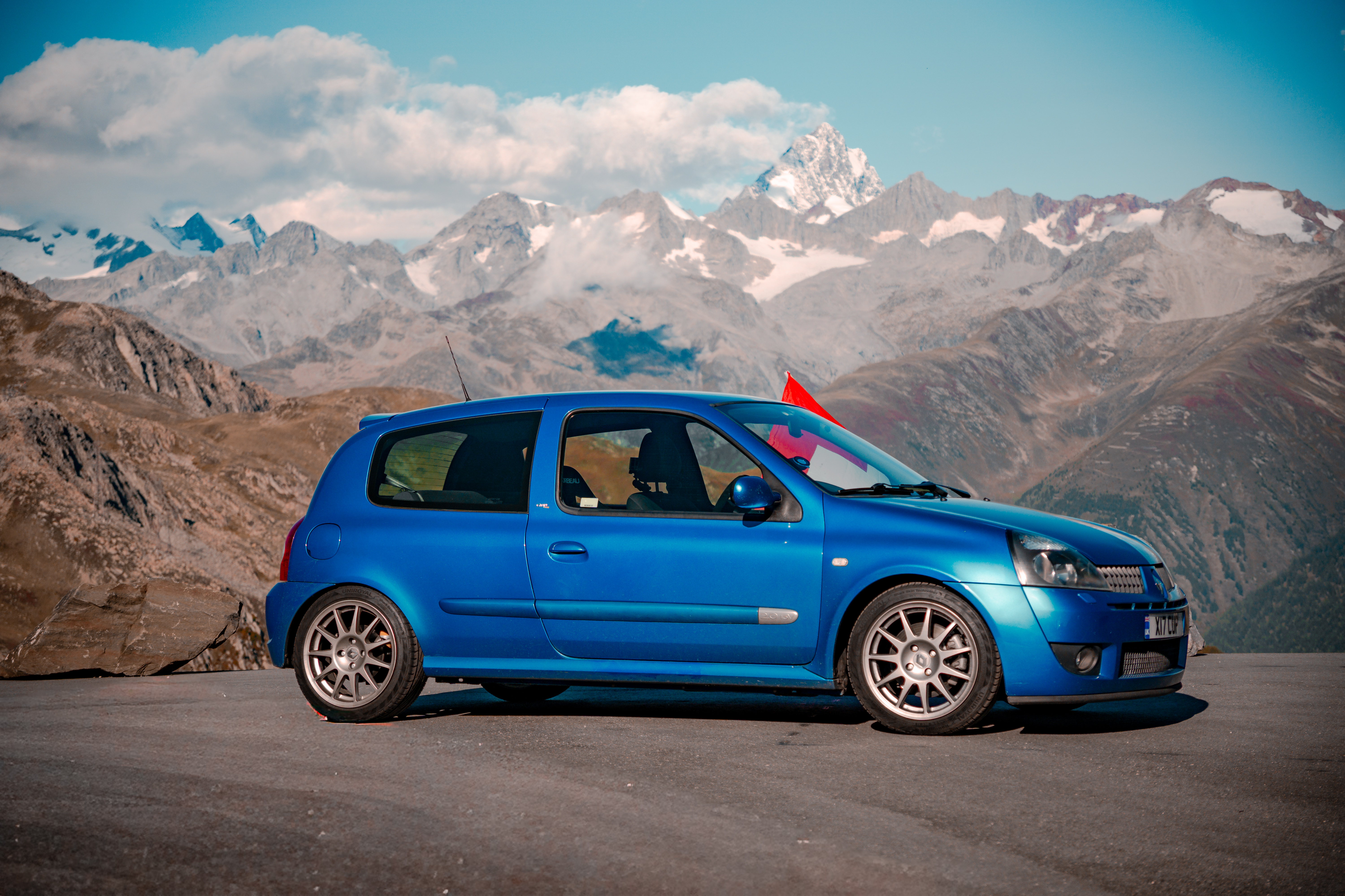

Day 4 - We fueled up headed out of Sedrun for the last time, through Andermatt and south towards the San Gotthard Pass.
We stopped for breakfast and coffee surrounded by incredible views.
Next was west through the Nufenen Pass which was my favourite.
Pictures completed at the top, then we headed north to the Furka and Grimsel Passes and out of the Alps.

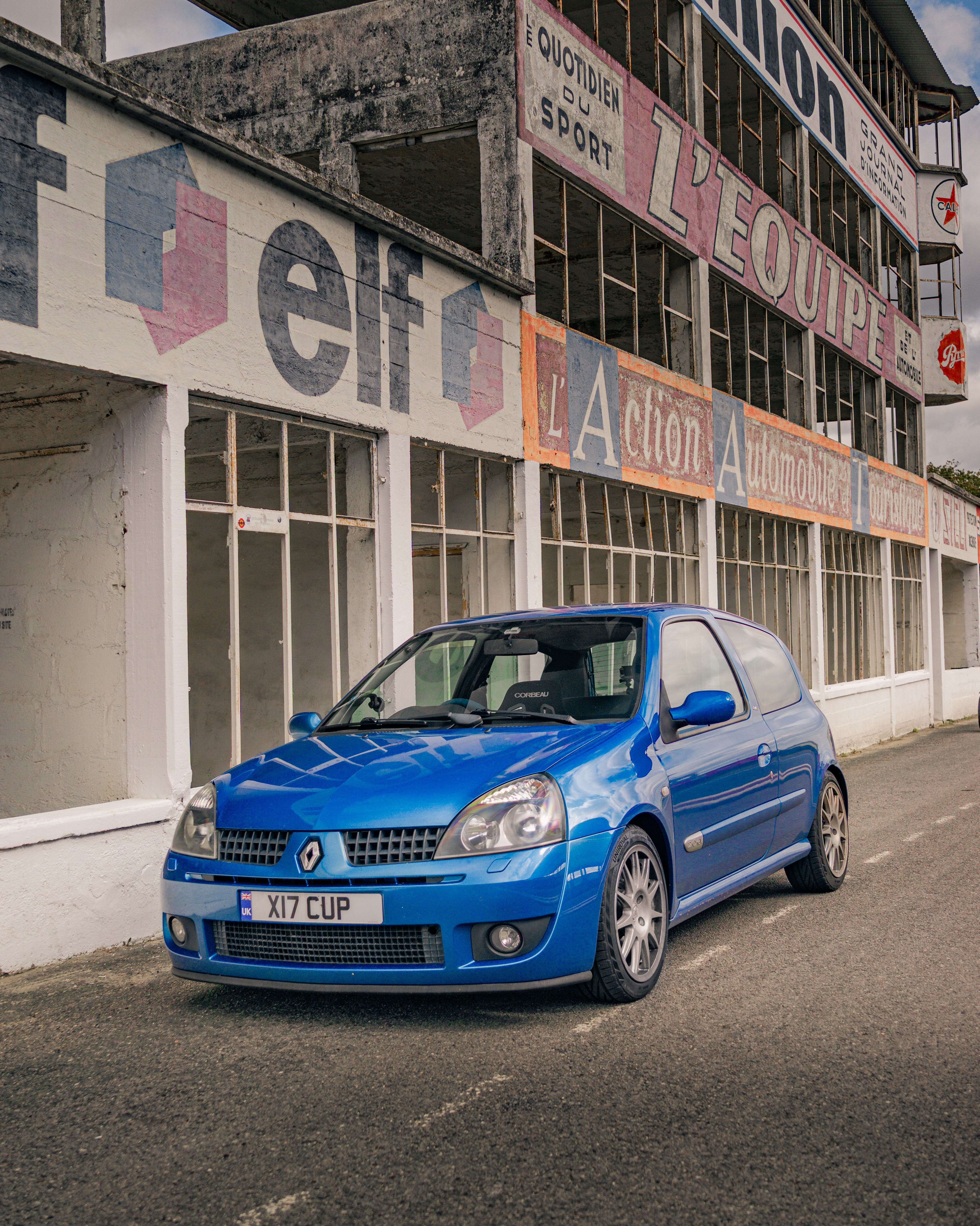

Day 5. The long road home.
Driving through some really old French villages that reminded me of Band of Brothers headed toward LeShuttle.
We stopped off at Reims for photos and lunch.

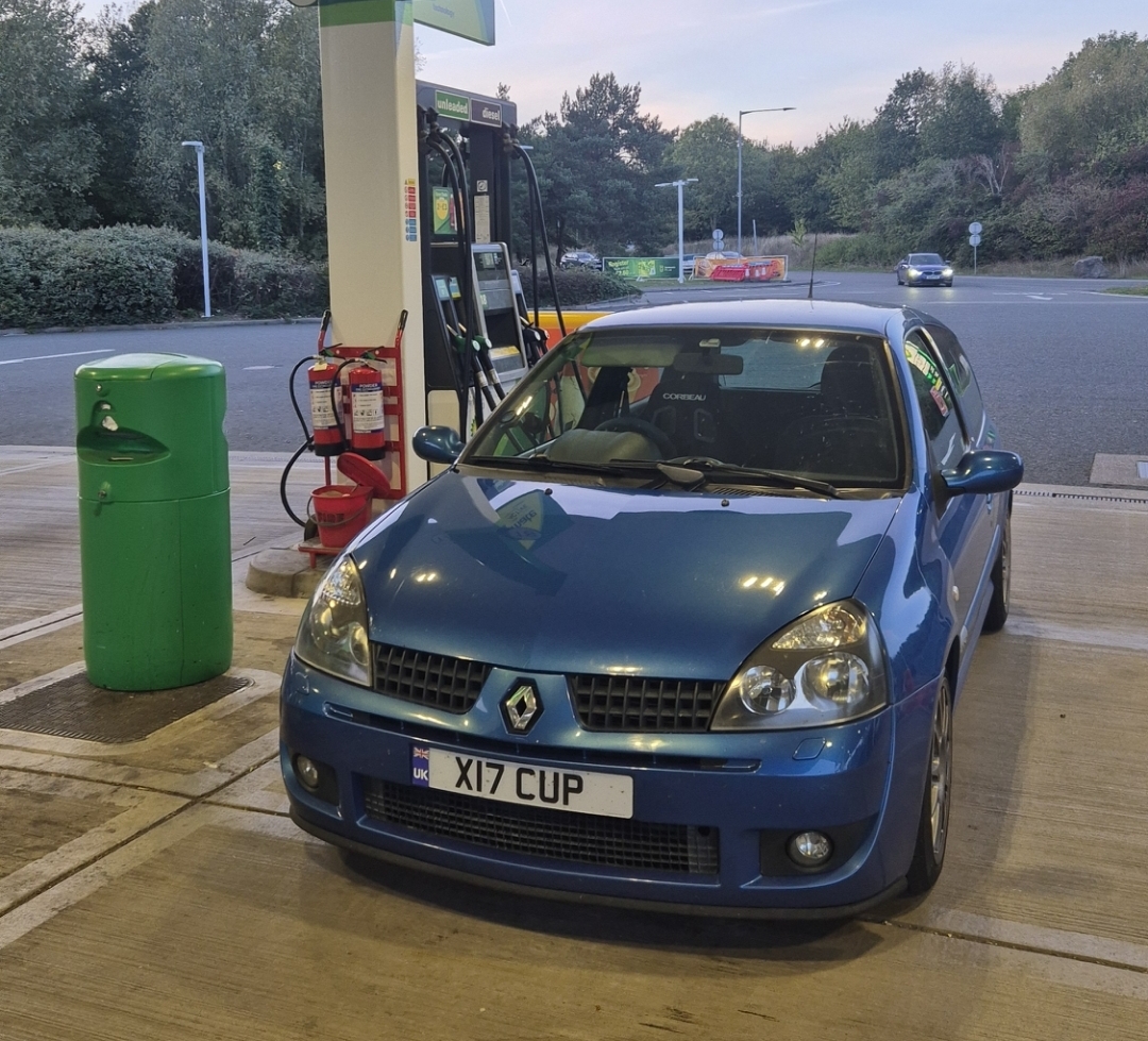

Back at LeShuttle we managed to get an earlier return journey which I was thankful for as I still had a near 4 hour journey on UK soil from Folkestone to South Wales.
Sat at LeShuttle, staring in awe at the little Cup that could.
At Reading services.

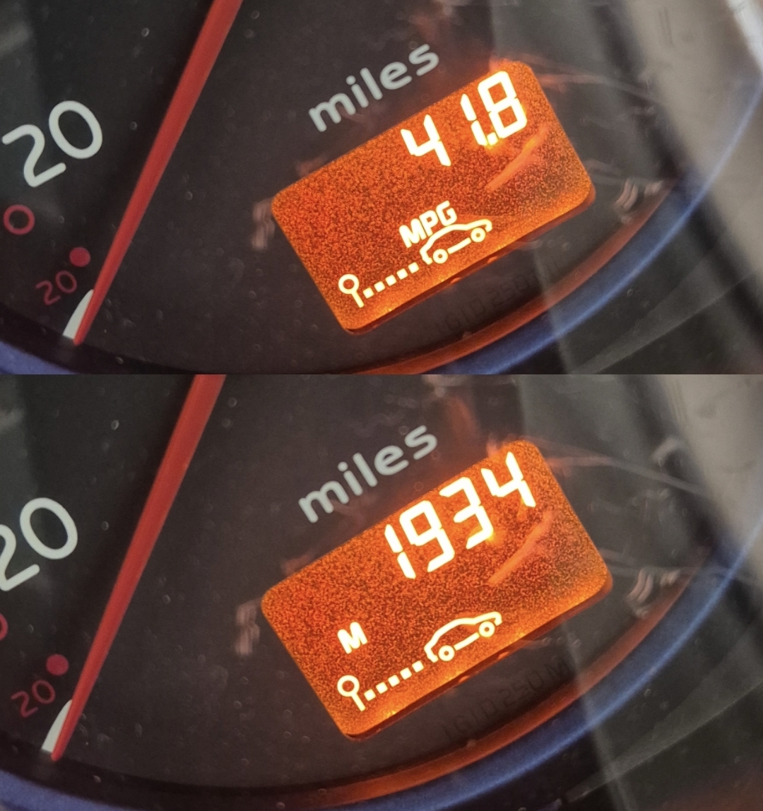

All told:
41.8mpg over 1934 miles.
The weather, the scenery, the roads the company I couldn't have asked for a better time.
What did surprise me was how the altitude affected the cars performance. I was worried something was wrong but I wasn't the only one who noticed it.
I was probably driving at 7/10th's, the corners and the sheer drops make for an exhilarating drive, but one not to be taken lightly.
What I would do differently, better tyres and brakes. I was on RainSport5's that weren't suited to the situation. I had new pads but not new discs.

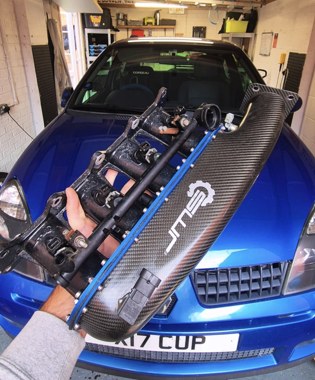

Plans are to show the Clio some love by getting the belts and dephaser done.
ex-Chinese Dave
Great question.
Open to opinion and thoughts here tbh?
182 Manifold?
I'm not keen on opening the engine up to fit cams unless I need to.
If you are sticking with a standard CAT and exhaust it will probably limit power gains, but saying that you know how happy I am going back to a standard exhaust. I'd personally go for the driveability angle.
bowen86
Group N timing? I have a timing tool..
Belts are due soon anyway, so this is an option.
100% I'm not making it a track car or going for peak power, just want a good all rounder.
Matt Cup
  Iceberg 172 Cup

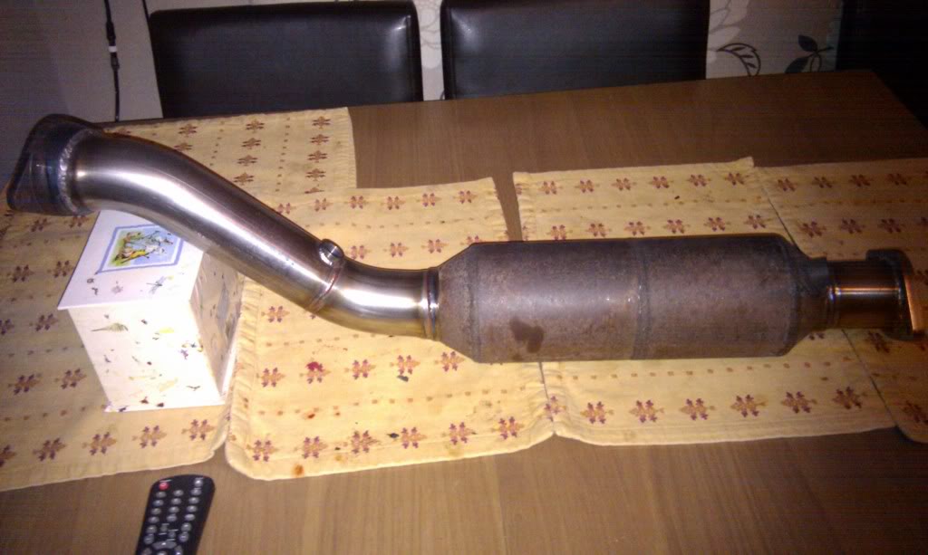

The 182 cat is effectively a sports cat anyway tbh.
Another option if you don’t want to go down the 182 manifold route is the BTB cat mod (if they still do it that is?!?!) I had this on my old Cup.
Brigsy
  T.Turbo
As far as i know RS2 inlet is more aimed at peak numbers at high rpm. I think you lose a bit of low down torque too with the shorter runners, but no expert. Id do cams too and 197 injectors, decat/exhaust etc to compliment if fitting.
Grp n timing is nice but a few quirks. Rough idle, occasional cut out etc so also bare that in mind.
Being honest, if your not too bothered on peak numbers a simple map on current setup might be best.
MAXRUNDOWN

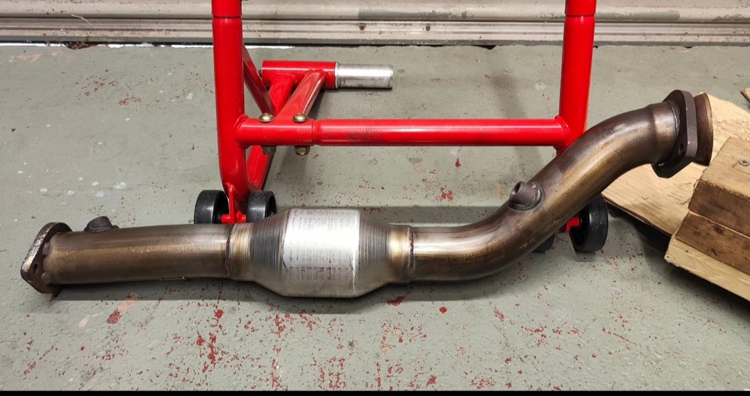

I've got really nice condition 182 manifold in the garage, I got a 172 milltek downpipe cheap which I had a magnaflow sports cat welded in. I think most of the gains of the 182 set up come from ditching the standard 172 cat anyway.
gez 172
  Defender 110
100% get some cams in there. You’ll want to be revving that all the way out to listen to that inlet do its thing 🎺
I’d also do a raised limiter and ARP rod bolts…
