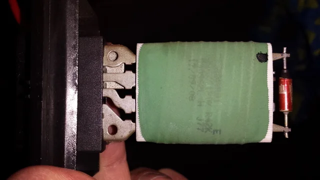

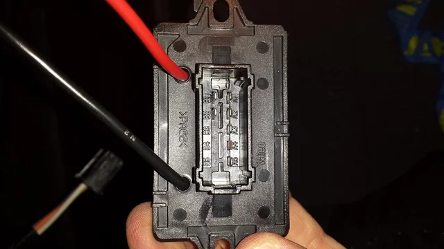

Ok after unscrewing the unit I took a few pictures (below). I presume this is the control unit for
the fan speeds, As only setting 4 works I guess it could be a fault with the circuit under the
green poxy? Would it be easier to replace the unit and splice the red & black wires to the
new unit? I cant fully follow those 2 wires or replace without taking the whole dash out.
Thanks
Cheers for the reply lemonnobby, I thought as much just need to find out how much one of these units is gonna set me back.
Could another option be to solder a new thermal resistor and remove the old one at the end of the unit?
Thanks
