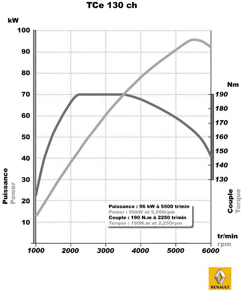

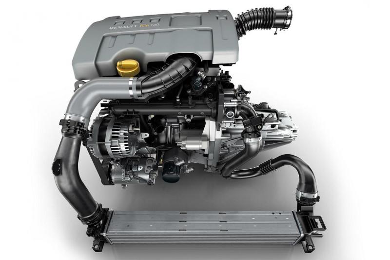

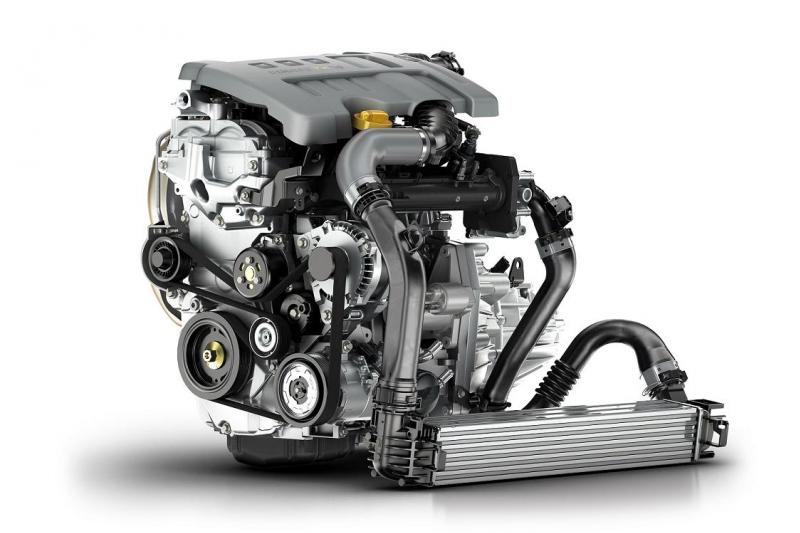

If you wait until begin of next year you can get the 1,4t (TCE130) that´s in the MéganeIII.....;)
Source: Renault.com
