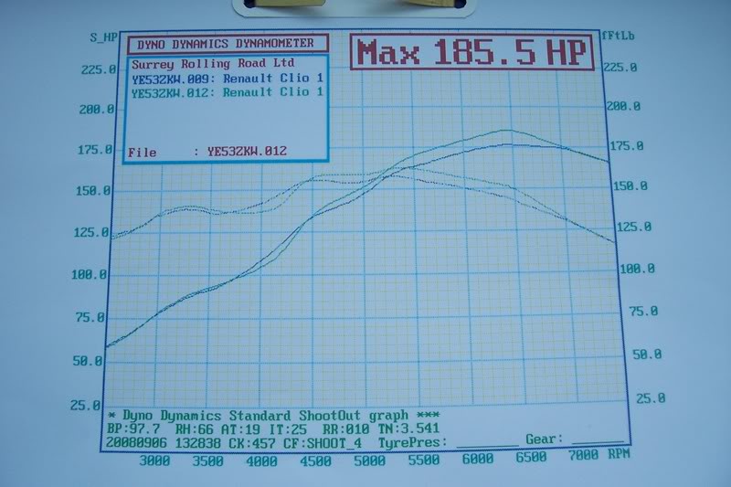

The 172 engine's torque drops off fairly quickly at high revs, more noticeable after a remap.
I think there's something wrong with it tbh...I mean...look at this (the video confirms this graph)...it's not supposed to drop off like that is it...
Only realy driveable up to 6,500 if I want to get anywhere in a hurry ;)
that torque is quite normal bud. theres only ways to make it hold on further up are cams, itbs head work or a turbo ;), rapid as hell tho pulls very well
