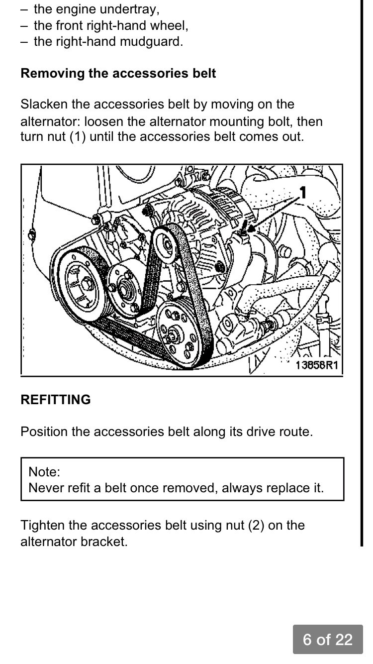

Also with regards to Aux belt, the workshop manual seems to suggest doing it through wheel arch. Anyone confirm? (Lazy)
Yes, it was said above to go through the arch?
Bit rusty these days Schwep? You used to be tuned in from what I remember!
Haha never used to do any of the work myself! Trying to learn!
It was said to go through arch but to take taker bumper and light off which I can't be bothered to do.... :)
