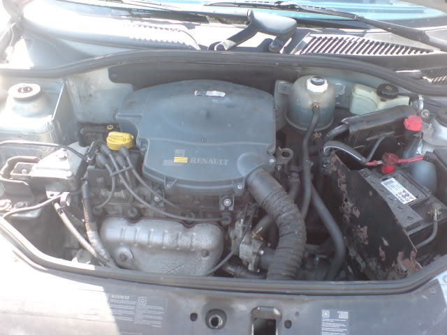

16v engine?
  mk2 ph1 1.4 S
now this is logged as a 1.4 16v but it seems to look different to the 16v engines ove seen....
whats the story?
  mk2 ph1 1.4 S
fook sake!
means my cars got a hidden past then! i.e engine swap at some point grr!
unless because mine is the sport its just s different airbox?

I used to own a Ph1 "Si" 16v which had no sunroof, 172 dash, aircon and dual optic headlights.
My friend owned a Ph1 "S" 8v with a sunroof, 172 dash, no aircon and dual optic headlights.
Whoa, whoa, whoa - I'm pretty sure my engine looks like that (in work at the mo) and I've always been led to believe it was a 1.4 16v too.
W. T. F.
I couldn't care less to be honest, doesn't make it any less of a car - just don't understand why I think it's on the v5 that it's a 16v.

In early 1999, a sportive 16V version engine was introduced, and eventually, all the older petrol engines were upgraded to more powerful and more economical 16-valve versions.
1.4 L (1390 cc) | E7J | 8-valve I4 | 75 PS (55 kW; 74 hp) | 1998-2001
1.4 L (1390 cc) | K4J | 16-valve I4 | 98 PS (72 kW; 97 hp) | 1998-present
This is when they introduced the 16v "Si". Which replaced the "S" 8v

With the plugs in the side of the head id guess it 8v, though im not 100% on small Renault engines
  mk2 ph1 1.4 S
yeah mines is a 2000 plate 1.4 S badged...
when i put in for insurance it came up with 16v in the title for the car so i assume thats correct?

if people want to fire me their reg numbers or chassis numbers i can confirm if they have 8V or 16V engines
RXE is an 8v
The original picture is 100% an 8 valve engine, I've done a couple of top end rebuilds on them in the last few months
RXE 1.4 16v k4j
Look like a 8v
E7J 626 (maybe but maybe not ;) )
I don't think the insurance told you that i bet the 'S' made you think its a sports car :)
