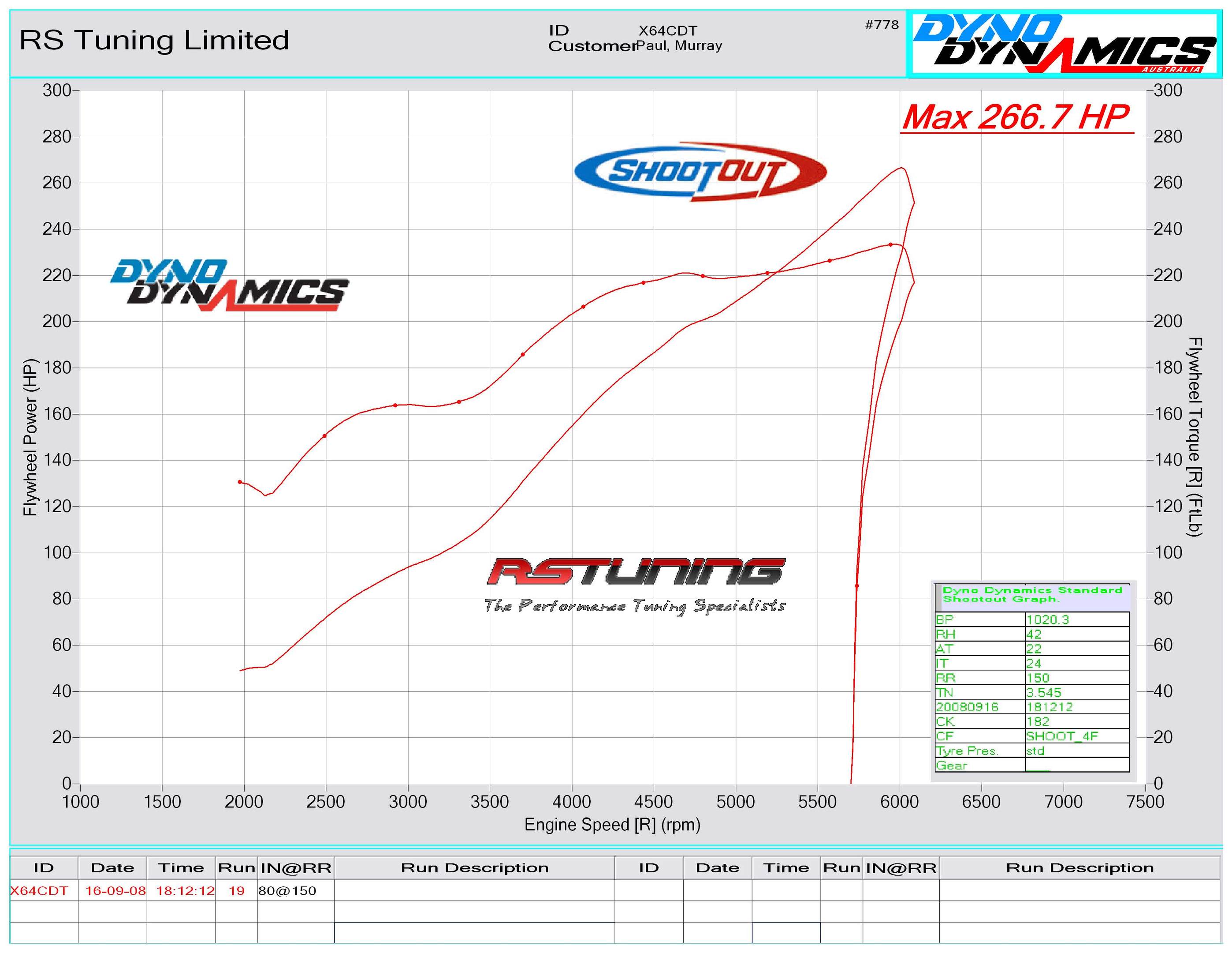

Im getting my 172 suercharged at RS Tuning in about 2 weeks time now. Paul is mapping it on the standard ecu and will be running approx 250bhp on standard internals
dont ever remember saying that you "cant" use the std ECU. We have run the 1st on Omex for obvious reasons.
Stock ecu mapped with the rotrex, NO restrictor hence the rate the power is climbing and why i lifted off where i did!

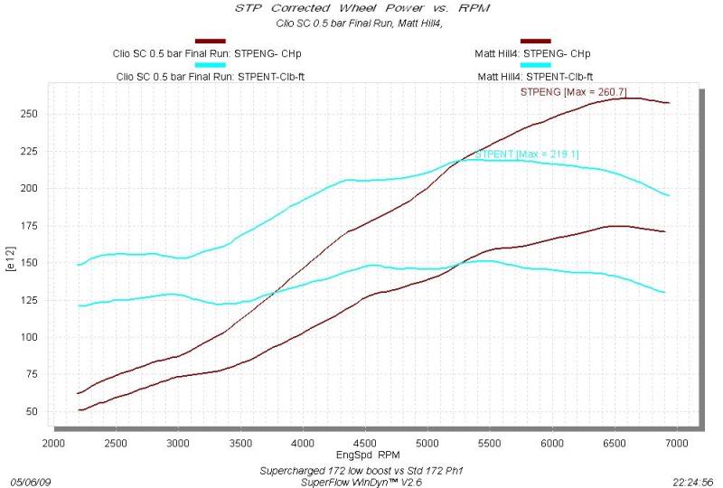

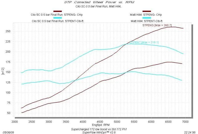

@ 175 peak I would expect it to be the standards clios tourque & bhp curves against the s/c clios results
edit: bottom of the graph explains all "Super charged 172 low boost vs Std 172 Ph1"

why's the supercharged clio so low at lower rpm..thought they were better lower down and without reducing the compression i thought that it would be level with or above the standard car..
or am i reading it wrong
