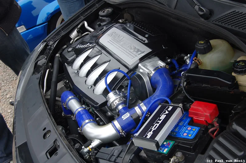

Well after reading up about this in the Fastchip thread, I thought such a thing should have its own dedicated thread - so here it is!
From what I've read and understand the kit will turn any 172/182 into a 220bhp beast even when running only the standard cat and exhaust, so with the turbo fitted I'd expect a decent decat/sport cat and exhaust system would push another few ponies from it.
Reason I'm vaguely excited about it is because it's the first kit I've seen that is actually affordable and justifyable in my book, so I maybe looking at this over the next few months with interest, although I don't feel winter would really lend itself very well to such investment.
Anyway here's the spec and a few pictures nicked off of the other thread:
Flyer:
Conversion pictures:
Product:
http://www.mbcarperformance.nl/catalog/index.php?cPath=680_927_1359_1360
So thoughts and opinions?
