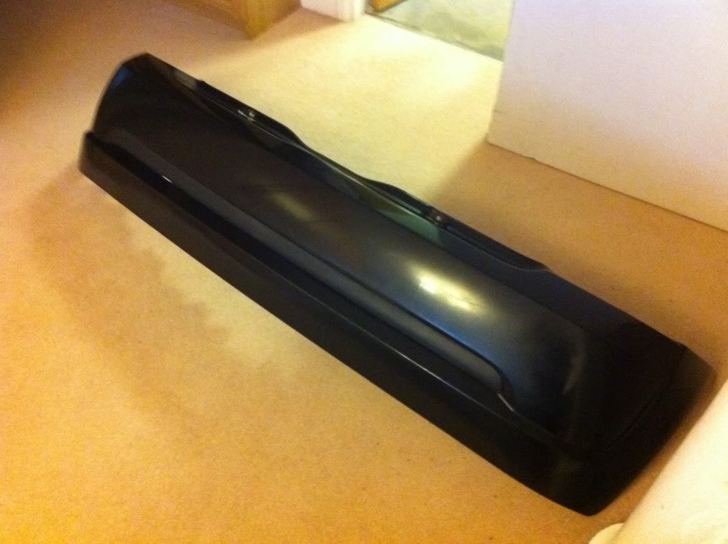

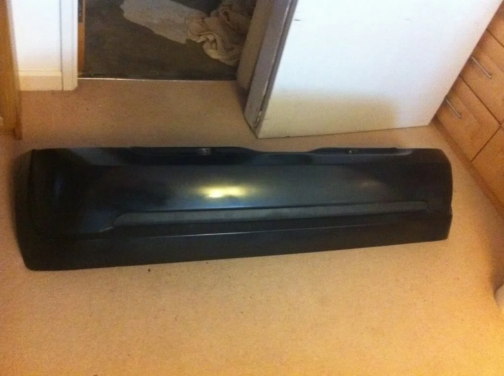

Picked this up off rob91 yesterday and I have started having a go at refurnishing myself without sending it for a full respray. There was a crack on the left of the bumper and some of the lacquer had peeled off. I will probably make a balls up of it but I will have a go at anything.
Just filled the crack on the left and a few other bits, sanded down and gave it its first coat of primer and all the paint decided to lift in the 'curve' on the left. So i have taken out all the crap paint gave it a sand and filled it to get a smooth finish.
Hopefully fingers crossed I can get it all to blend in, i know it will never be 100% perfect but worth a go. I will add more pics as I go along.

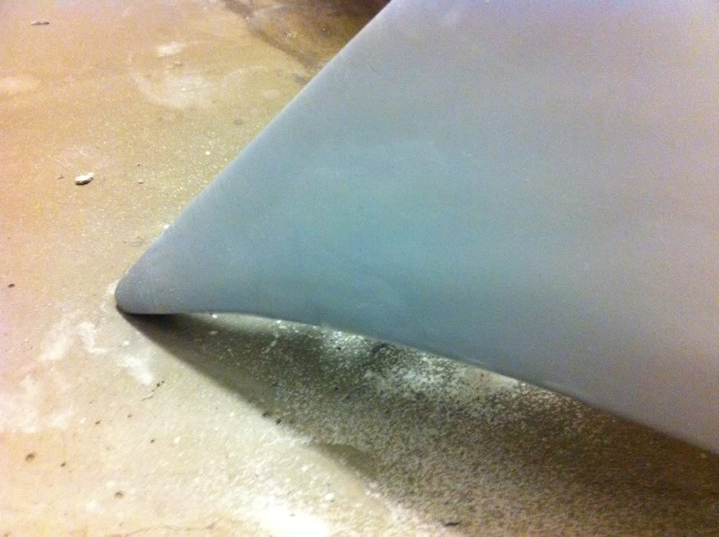

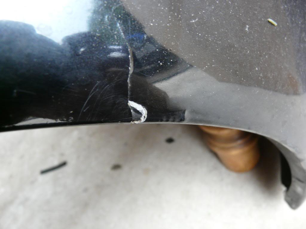

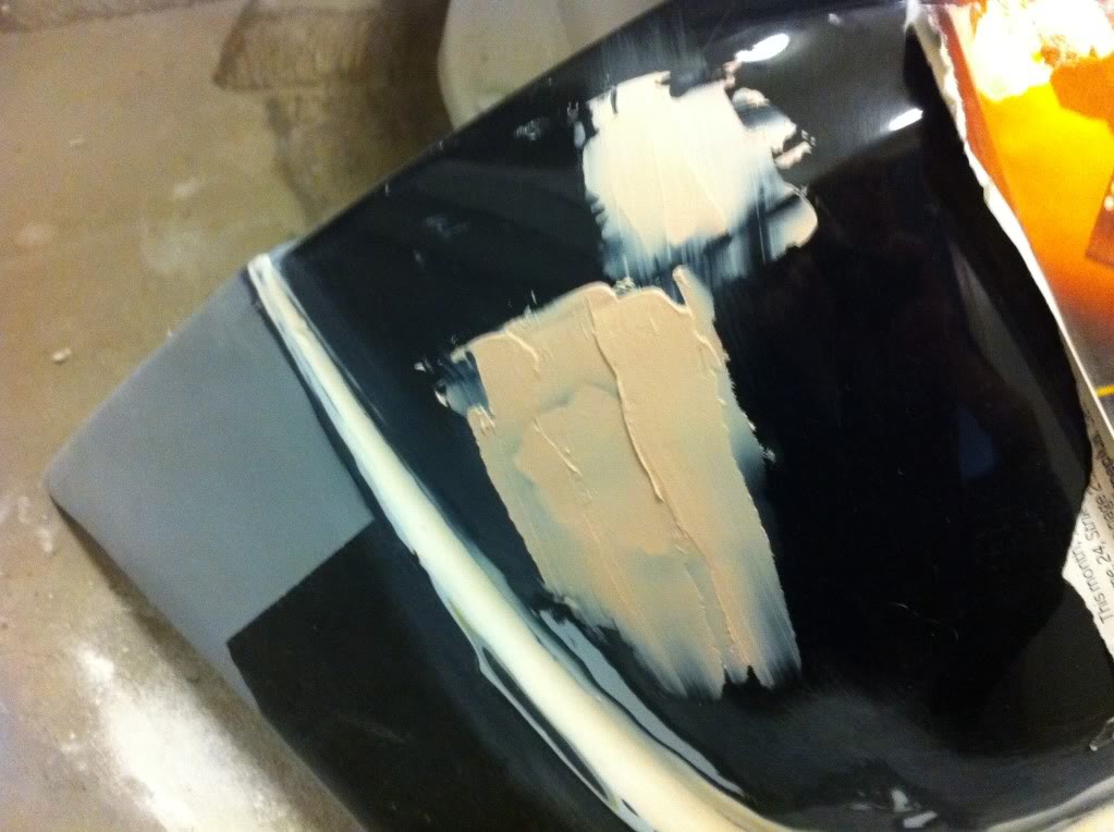

First off it was only a small crack, about an inch long. Basically I fibreglass'd the rear of the crack to give it some strength and then used body filler to fill the gap and smooth it out. It seems fairly strong and it isn't noticeable at all now.
This was the original crack, the crack was right on the far left of the bumper where I have primed in the original picture:

A closer shot of where the crack was:

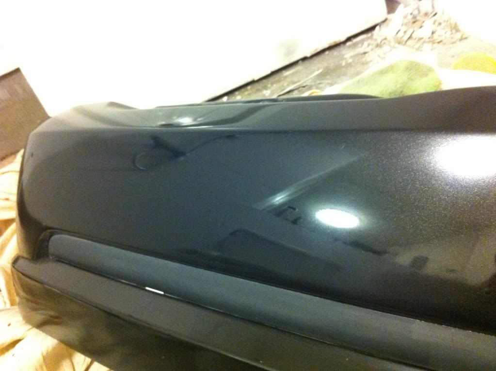

Now i keep finding flaws, there were two spots where the whole paint layer had bubbled. Took off the paint and filled, i am not doing any more now or it will never be finished :)

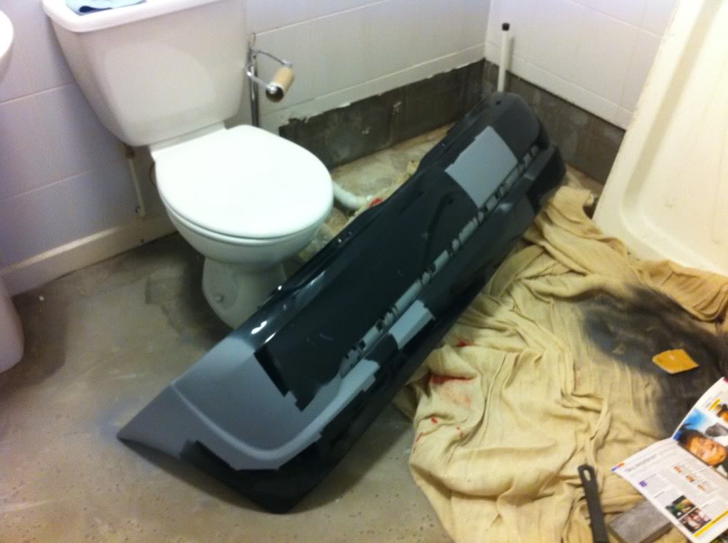

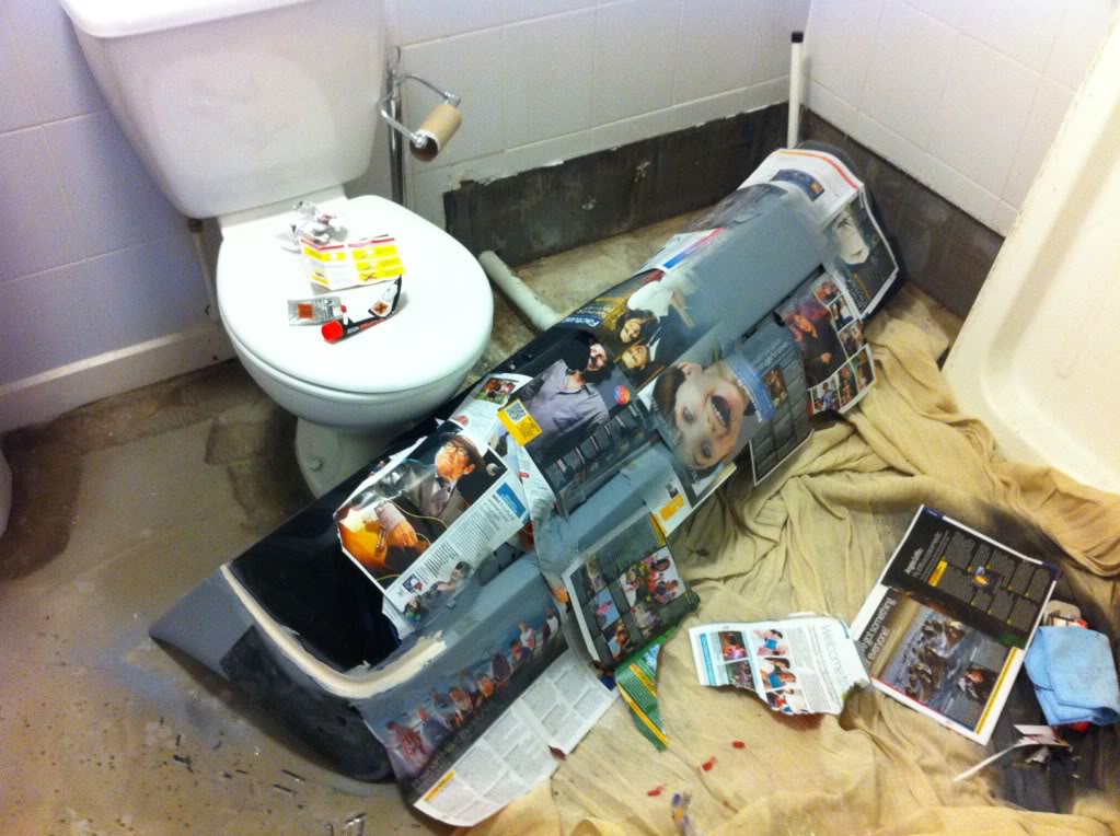

This isn't as easy as I thought it was going to be. Now I have sprayed it black I can see where I have not sanded down enough. Also as Kerry said above, there is a fair line where I have covered up the bits I didn't want to spray. Lets see how it looks when I get some lacquer on it tomorrow.
I can see me taking this to a body shop :eek:
I wouldnt have masked it off tbh,
Wet flat the whole bumper, primer it, wet flat then colour, then lacquer

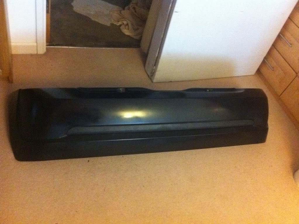

I have been wet sanding all the way using 1200 grit (its the lowest i could get locally) through but I am wondering if I have done it enough. As far as the polishing goes, I think I know what i am doing :S
Hmmm 1200s fairly light grit, when im flatting coats i use 1500, and when im flatting to polish back up either 1500 or 2000
The lacquer would be too tacky atm to flat imo, needs a few days to cure before flatting and polishing imo..
If youve laid the colour on well, and the lacquer on without it clouding anywhere, after its cured you should have a good chance of flatting and polishing.

Cheers for the help mate, I have just wet flatted the whole thing again now, doh! I'm going to leave it now until tomorrow. If it is still that bad i am going to get it done professionally I think.

2 major mistakes from the start... ir order for a layer of anything whetehr it be filler , Fglassz, primer , paint or whatever you need the surface to have a suitable key to it in order for teh new ''coat'' to stick. otherwise it wont bond.
for the filler you needed atleast p320 for it to stick at all and imo that is still to fine.. and you need the srrounding area to also be keyed eg... 50p sized dent.. sand atleast a cd sized patch around it.
2nd mistake
you primed right upto the masking tape line, this is not good as it leaves a trace even after sanded ''smooth'' it also leaves a solvent buildup which can still show through the base coat after flatting.
ideally, get some p320 an flat the full thing back to key it up, then ghet some uplo or similar high fll primer, gives 3-4 good coats of this.
flat back using p4-600 no need to go any finer.
from this point by the time you have bought enough paint and lacquer you may aswell just have it done properly< will be almost same prive a 100x better finish

you should have colour sanded the full bumper then give 3 lights coats of laquer with 15 mins between coats. leave to dry naturally for as long as you can to let the laquer set properly. Then give it a t-cut with colour match stuff.

I hit a minor setback Phil, I went through the lacquer yesterday lol.
So I now need to re-lacquer the thing again haha. I'm in London tomorrow and Friday so should get more done at the weekend
