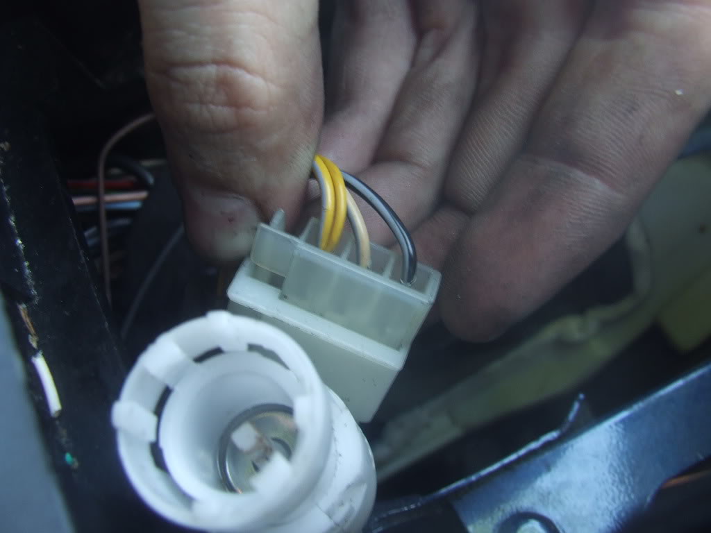

yep, the only 'mod' it needs is the speed sensor
its a nice variable speed fan too :) so you pretty much never hear it
  '92 172, Lotus Elise
on the speedo cable there should be a plug with 3 wires (yellow, white black), the middle one is a signal wire and needs to be connected to pin 53 of the 172 ecu
  R5 GTT
Just found out the gtt seed cable is a variabe reluctor and does not put out a signal like a modern hall effect or optical speed sensor. Anyone got any ideas how to convert this type of signal?

the ecu needs to know the speed to control the fan and limiter atleast
not sure if it calculates load or overrun etc using it or not?
from the few pics ive seen of r5 clocks, the speedos look the same (or atleast interchangable) to the mk1 clios
worst case you just swap them over and run a clio cable!

The r5 cable is defo 3 cables I will see what happens.

anyways, does your speedo cable have a connection like this:
