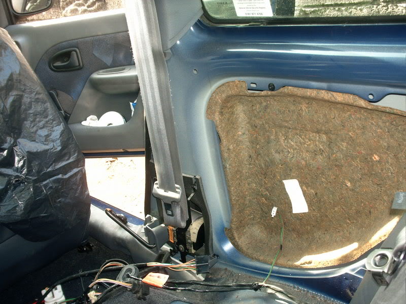

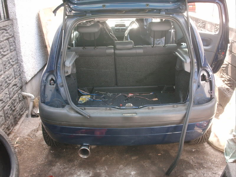

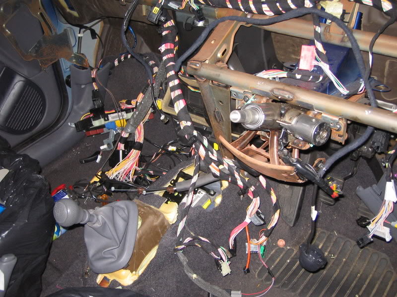

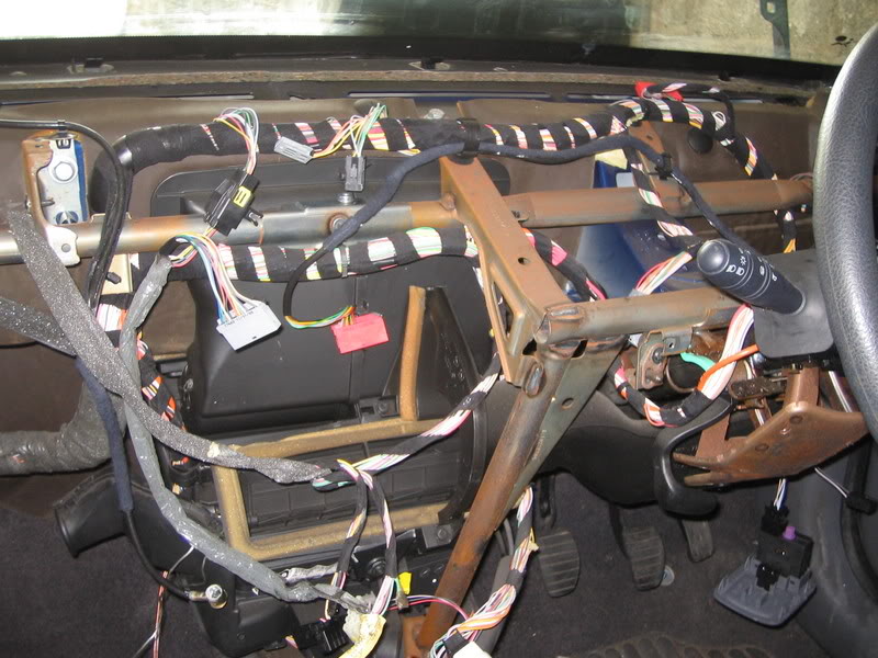

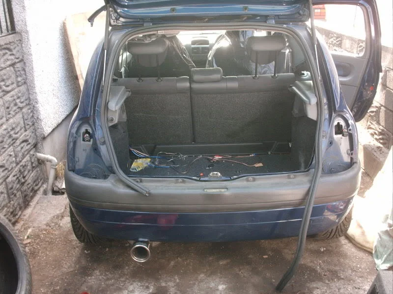

i think i spoke too soon about the electrics.seems like them wires that run down the drivers side are for the right hand side of the car because ive only got the left rear sidelight working and the number plate light and rear wiper. and also when i switch the ignition on theres like a beeeeeeeeeeep sound coming from the throttle body!is this normal?i dont know if it starts because ive got to make a bracket for the altrenator and change the oil first.
  clio (sleeper)
i also wanted to know what the thing is that connects to the airbox and is fitted down by the wheel arch?its got like a valve that opens and closes?:s
  clio (sleeper)
yes but it doesnt stop.it keeps doing it all the time the ignition is on....and the wiring down the drivers side....what does that power?just a little help needed save me stripping the interior again

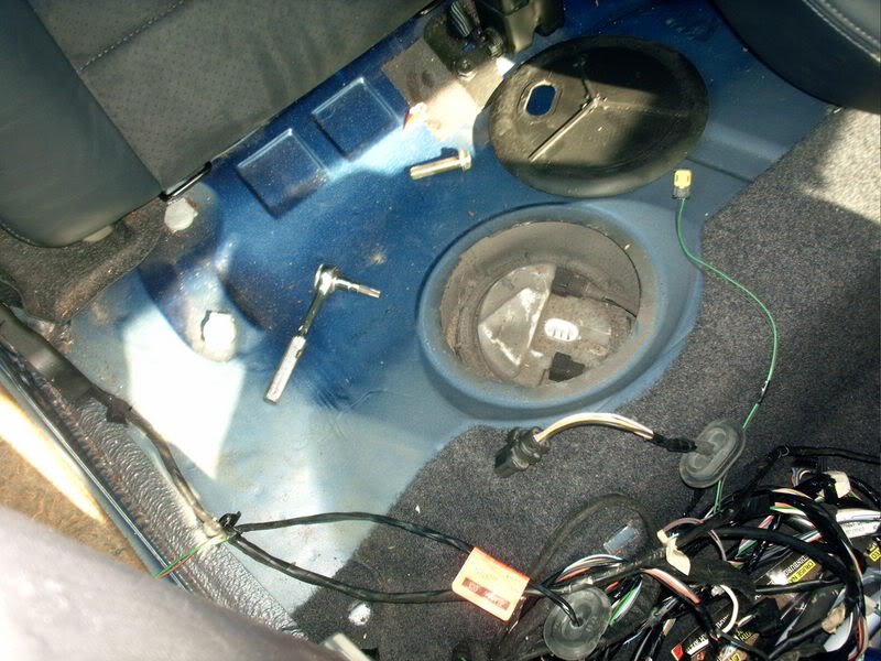

the fuel pump isnt priming when the ignition is turned on.it isnt an imobiliser fault or the imobiliser kicking in i think its due to the rear wiring...ive left the wiring down the passenger side as standard because it simply plugged straight into the new loom could it be that?or could it be the wire running down the drivers side?which i still dont know what they are there for...all that works on the rear of the car at the moment is the left sidelight/indicator/brake light and the rear wiper and number plate light.so im guessing its the wiring running down the drivers side?but i was told that the fuel pump wires run down the passenger side?
if any of the above makes sende to you.lol please could you help me out

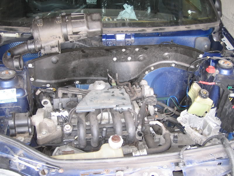

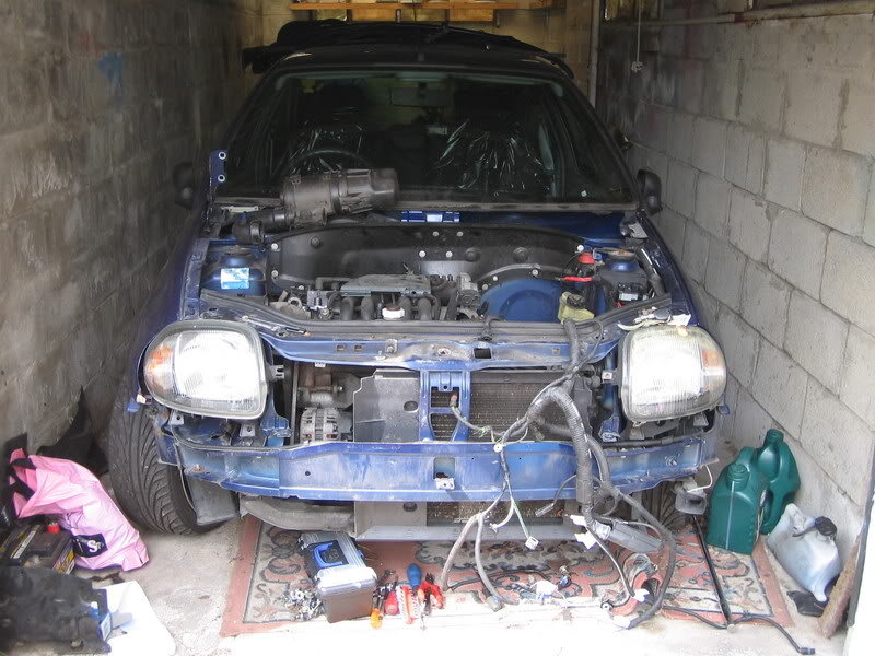

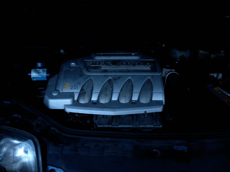

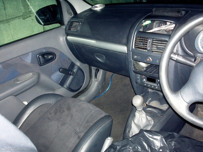

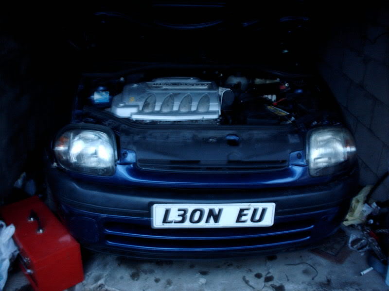

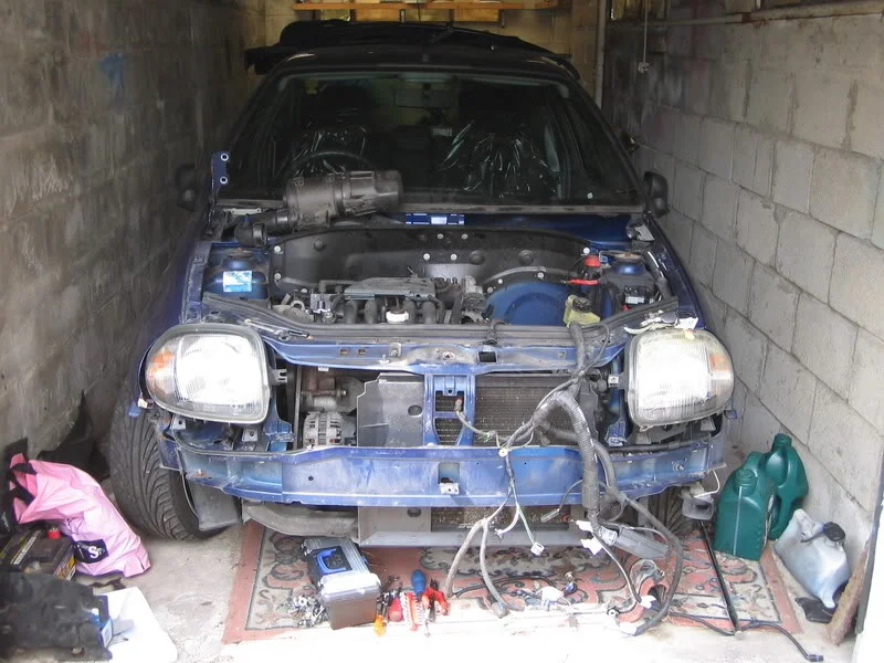

Right heres some pics of my car for you...tell me wot you think...taking into consideration a few weeks back i didnt have a clue.lol
BEFORE:
DURING:
AFTER:
just a few bits and bobs to tidy up but the main thing is shes running sweet :D

my car is a mk2 phase 1..
the engine is out of a mk2 phase 2.

  • the standard fuel pump works fine!
  • the rear loom has to be changed along with the front looms(the phase 1 has 2 rear loom running down both side, but the phase 2 has 1 loom which runs down the passenger side only and goes under the rear seat for the fuel pump and round the boot for the lights and everything) (its one complete loom)

  • the rear light cluster need to be changed if using the phase 2 loom(or you can cut and re wire as i did)
