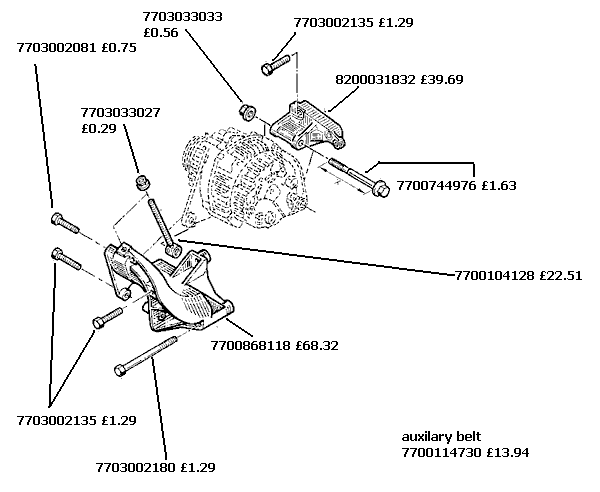

This is what you will need to convert a 172 with A/C to a 172 cup without A/C set up
You will also need a lower ampage alternator
  clio (sleeper)
thanks for that mate.i take it their main dealer prices?
i wasnt expecting just the brackets to be 151quid!shocking!
thanks for the help though mate

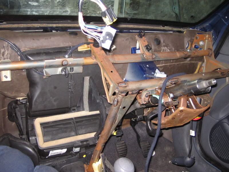

right folks,my 1.2 engine has sadly passed away!(timing belt snapped) so the conversion is under way!im not in a big rush so im doing it bit by bit.today i took out the old dash and took off the bonnet and bumper and ive located the fuel feed and return to make things easier later on...i will post up pics of my progress as i go along..ive also purchased a full scorpian exhaust system off here and some exhaust wrap for my manifold(all kindly funded by my fiance:).lol )...pics will be up soon..stay tuned!

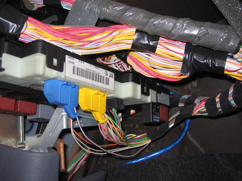

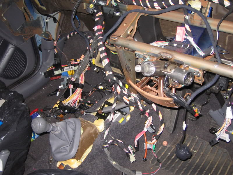

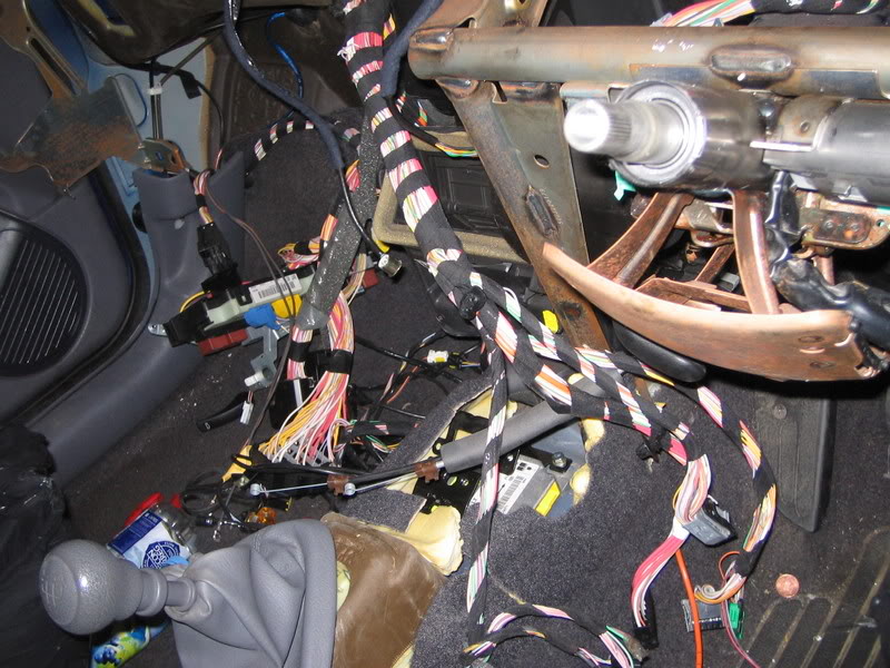

well today i removed the old engine loom and installed the new one...and due to mine being a phase 1 and the loom is a phase 2 i have to change the wiring for the front lights..but il do all this when its up and running...the dash loom is nearlly out...but i think im going to have problems with the loom to the rear of the car...i have the loom to go to the rear passenger side but theres wires going down the drivers side aswell and i think theyre for the petrol pump so thats going to be a pain in the neck when it comes to wiring them up:mad:
other than that the loom is pretty easy to do it just looks harder than what it is because theres so many wires!!!!
also my car has hydrolyc pas not electronic as i first thought so ill nedd pipe convertors for mine to fit the new engine!!!
ive taken the aircon pump off (now for sale) and made my own custom bracket to tension the belt rather than spending out on a cup one
il post up pics soon for you all to see the progress.:)
The loom goes down the passenger side of the car and then round where the back seats are the wires for the pump etc go along.
I'm sure the drivers door wiring goes this way.
  clio (sleeper)
ah right so i might be ok then coz ive got the loom for the passenger side.but here are a few wires going down the drivers side too.what would theese be then?
Side impack sensors and door light switch. I forget I think seat belts on a seperate loom though not sure this late at night will check tomorrow.

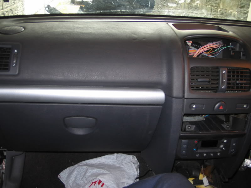

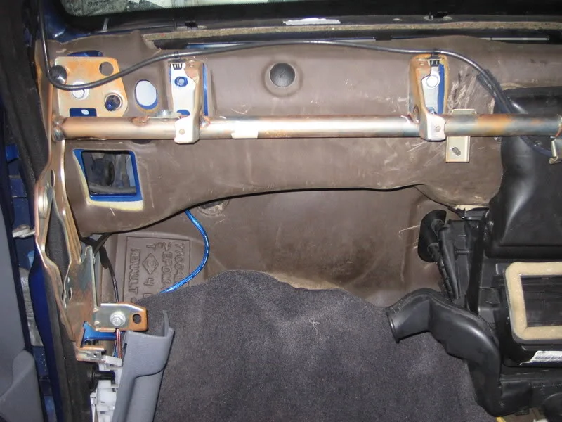

today i installed the new interior wiring loom, new dash, new pedels, new clocks and the engine is ready to come out apart fromt the mounts and exhaust!
the old rear wiring loom plugged straight into the new wiring loom so that was easy, just hope it works now!

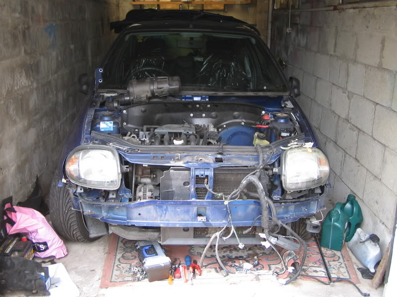

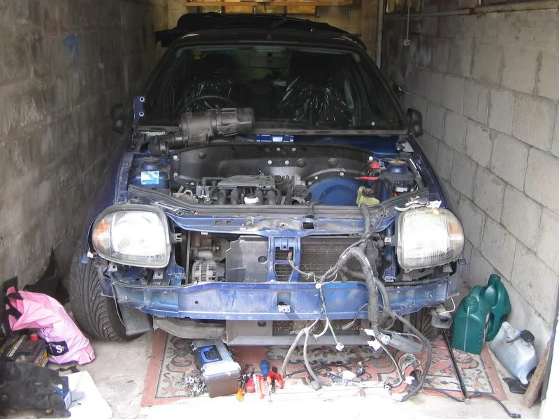

right so heres a few pics for you all to see what a mess my car is at the moment.today i got the 1.2 lump ready to come out and tomorrow me and my dad are dropping the new lump in.so new pics will be up tomorrow!

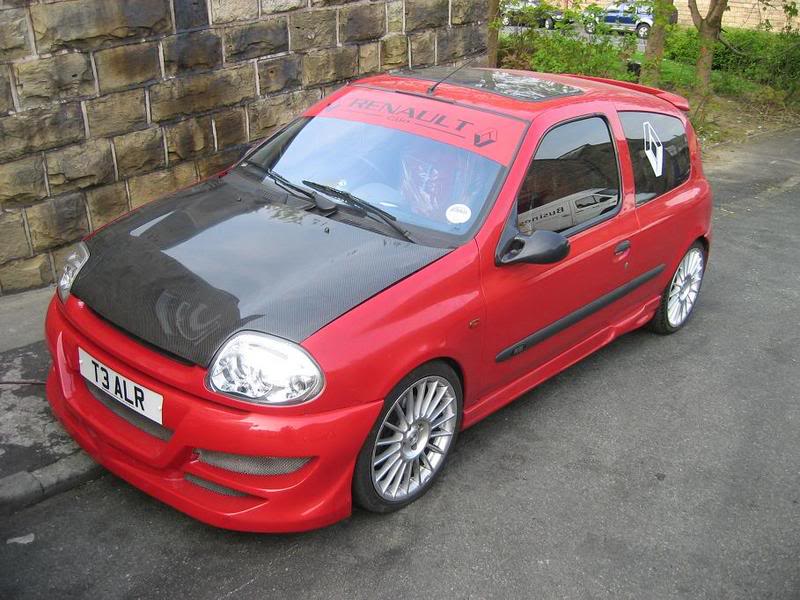

Just done this for a customer ( £3k conversion ) - taken us 1 and a half days to do. Not to my taste ( bodykit ) but it goes well.
Come on lads your dragging your feet !!

im stuck on something at the moment .ive dropped the engine in and i fitted the new hubs and discs but i kept the standard shocks and the wheel seems to stick in at the top.isit because i need to change the wishbones?or isit the shocks?
  MERCEDES CLS AMG
Change the wishbones - fit polyurethane bushes in them whilst your at it ( powerflex ) have you used the standard sub frame ?? i would also change the shockers as well mate
  clio (sleeper)
yes ive kept the standard subframe.i just measured the wishbones and their the same.so im guessing its the angle the mounts are on the shocks that pull the top of the wheel in!can i keep the standard subframe with the new wishbones and shocks and antiroll bar then?
are the subframes the same width?
  Lionel Richie
subframes are the same, the only difference is the 172 one is double skinned in places and has 2 holes for the lower front gearbox mount
you'll have to drill 2 holes into your 1.2 one, thats what i've done, easy peasy
  clio (sleeper)
mine fitted straight in though :s strange.but how come when i fit the hubs and stuff and put the wheel on the top of the wheel is sticking right in and the shafts arent straight as a result of this?
  Lionel Richie
hang on have you fitted you subframe with the 172 engine and box in the car yet?
you'll have to tell me EXACTLY what ARB, wishbones, hubs, driveshafts, struts you're using
  clio (sleeper)
right ive fitted the engine to my existing subframe...im using standard wishbones(but i have the 172 ones ready to fit..their the same size) and im using standard shocks....and im using 172 hubs,discs and calipers.so it must be the shocks are a different fitment even though they fit into the hubs yeah?
