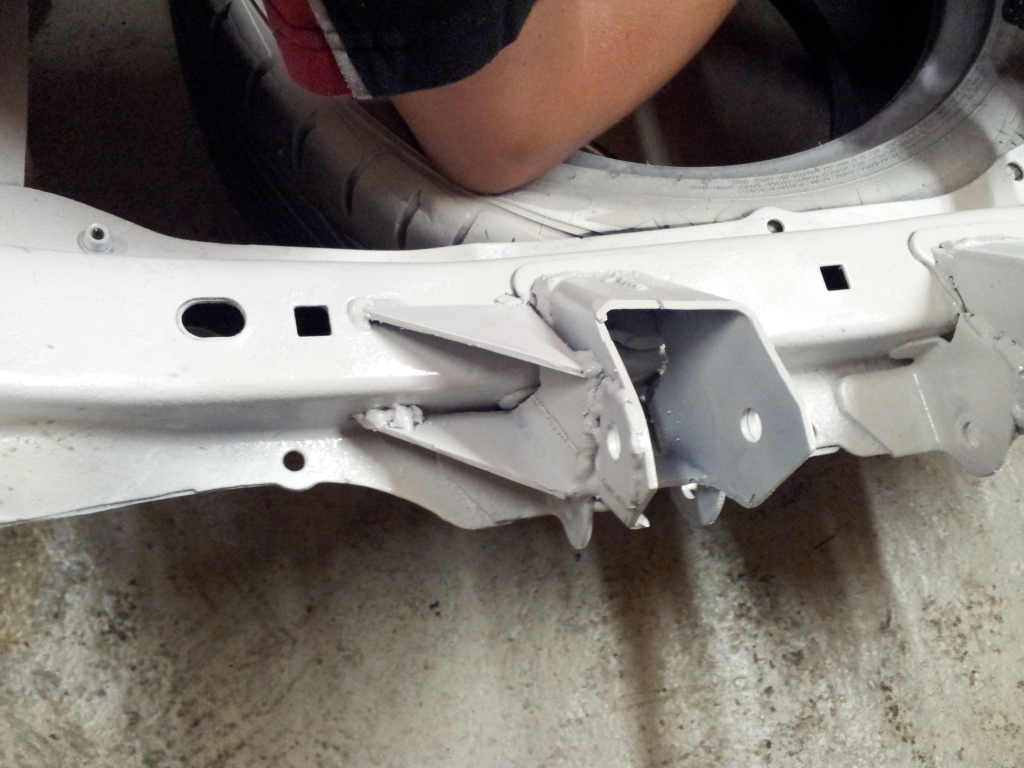

The holes in the subframe that the wishbones bolts to on the 172 cup are further out.
So different subframe, hence the longer driveshafts and and track rods.
Is that definately true about the subframe?
As it doesnt make much sense to me given that the cups have 20mm wider track book figures IIRC than the non cups and the wheels are 10mm wider offset, so that implies the hubs are in the same place in terms of width.
I thought the longer arms were possibly due to the wishbone having more caster meaning that the track rods are pointing forwards more on a cup?
I've got mine and Emma's in this weekend at some point so ill get them both on the ramp and have a measure :)
My 172 cup versus a ph1 172 subframe. I guess they could be like that on all ph2s?
http://www.cliosport.net/forum/show...ack-rod-ends&p=9121769&viewfull=1#post9121769
Sounds like we will know soon if its all phase 2 or just the cup.
Personally I think it will be all, just because the cup quoted track is only different on the front by the amount of offset in the wheels, but that could be renault not publishing accurate data I guess!
If you have the subframe off anyway, widening the track on those holes is certainly easily done.
Or just move the back one outward if you want caster increased.
Shame they are a bit of a pain to alter while its on the car, but if you just elongate them and then weld a plate with a drilled hole in at the point you want it would be quite easily done.
