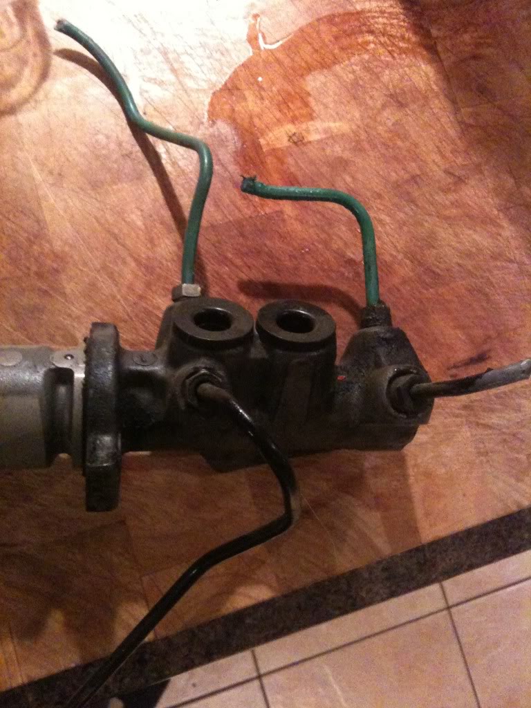

Does it have 2, 3 or 4?
Switching over to non-ABS and thinking how the hell I'm doing it if only has two ports?! Surely it has 3 or 4?
Also any pics of one would be awesome :)
Cheers
Cups have four as there is no ABS pump, one outlet for each caliper. I have one next to me here...its the same as Mk2 non-sports/Mk1s with no-abs, apart from the piston. The Cup is the one to go for though as it will have the correct size piston to keep the pedal the same as it is now

I'm guessing the shape is exactly exactly the same as the standard Ph1 one just with 2 extra ports?
yup as what jord said,

Ye, im not sure if it will fit a standard one tbh, but to be on the safe side i got that too, as im removing abs aswell, just not sure how MOT will test it though,

I'd imagine, as f0xy said, tthat they're the same without blanks then it fits on underneath the ports doesn't it?
