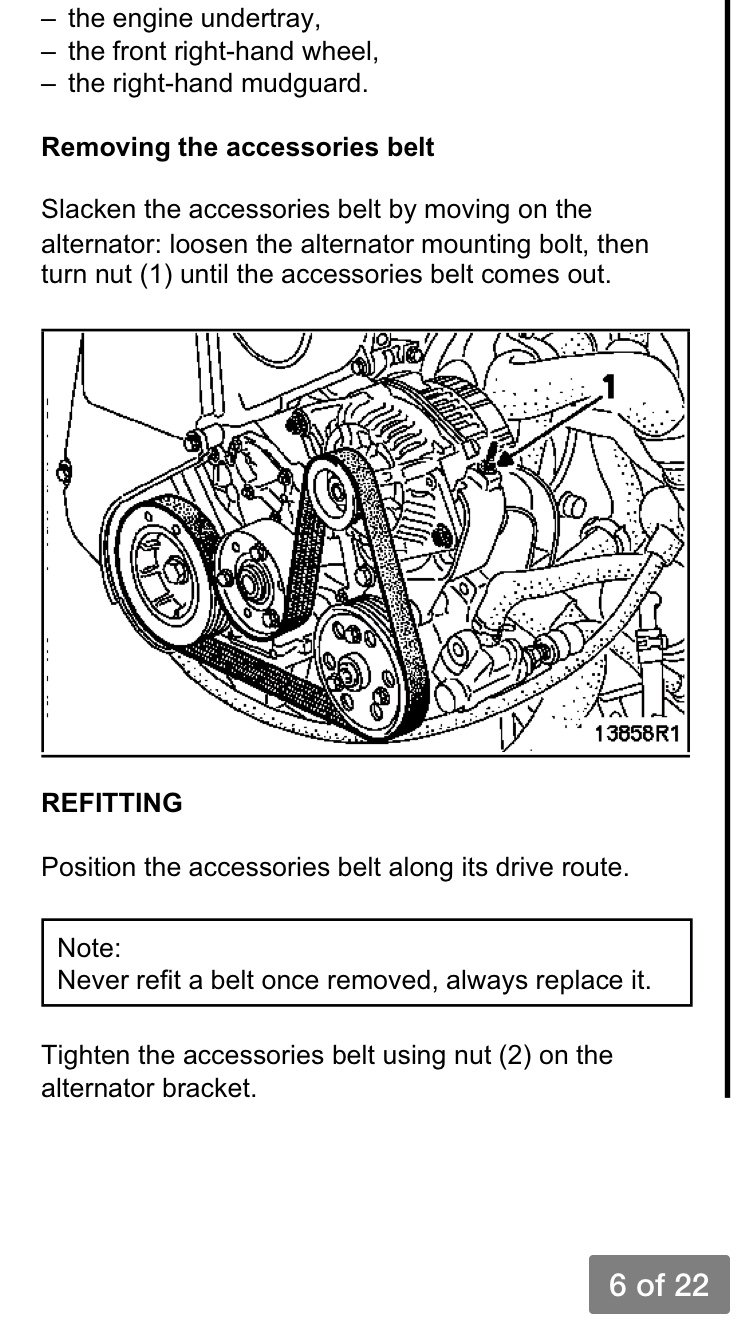

Finally getting round to doing this myself this week.
I have the workshop manual -
Its my first time doing any sort of belt so I just want to confirm - first turn alternator to slacken belt, loosen BOTH alternator mounting bolts (or just the one underneath nut 1?), then turn nut 1 as pictured.
That sound right? lol
Thanks.... Again! ;)
When you say big fixing... I'm just looking at the 2 black bolts in the diagram either side of the pulley?
