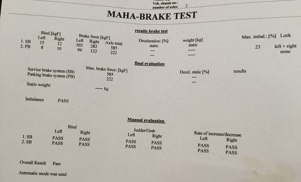

I've now since found the VOSA document on here and will be taking that with me for my re-test. However, i'm concerned the fact the rear brakes aren't recording anything - does anyone have any advice please?
I've got a picture of the brake test here:

Does the handbrake work? Seems to according to that. Like I said do the turn by hand test. If they lock solid I can't see the problem. Stick a wheel brace on one of the wheel nuts and see if it turns while braked.
The 172 cups are specifically excluded in the MOT through the above document.
The rear brakes are pretty much isolated by tying off the brake bias valve. This is to stop them locking under heavy braking due to the lack of ABS. Rear wheels locking = very, very bad.
Show the tester the above document, and ask for a retest.
Thanks for the help guys. I jacked the car up today and the handbrake works perfectly. However, when I press the brake pedal it doesn't seem to make any difference at all.
