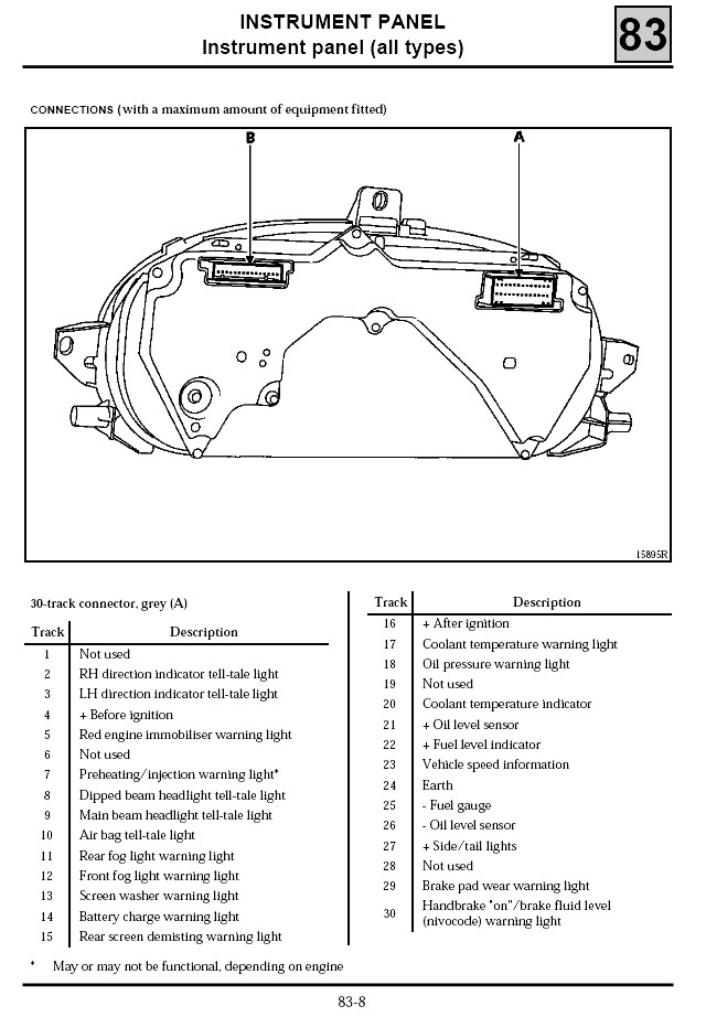

But you could get the pinouts of the dash and wire in a smal buzzer behind the instrument panel I guess.

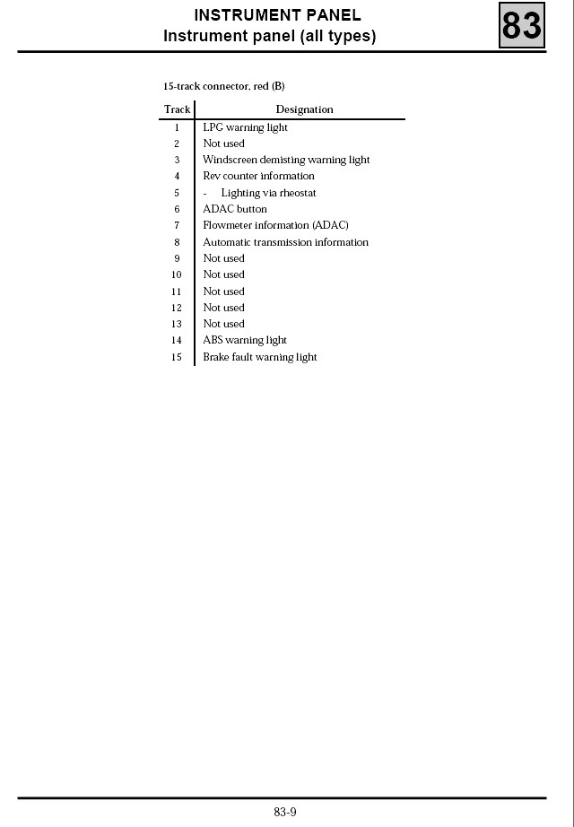

What he said - Find the wire that supplies the power for the light and wire a buzzer in should do the trick i suppose
BoatNonce
Looks like it's controlled by the gauge itself. You'd have to take the panel apart and solder directly onto the shift light LED.
  Clio Cup
Itll be 4 wont it rev counter information
Maybe pop the cluster out take it for a drive with a multimeter see what comes up when the shift light comes on
unless its under one of the - Not used ones and they just arnt telling us
Not quite. 4 will be a pulsed signal which is constantly telling the rev counter what RPM to display. More likely there's a microchip in the dash display somewhere which looks at the signal and when RPM = >6500 (or whatever it is), turn shift light ON.
