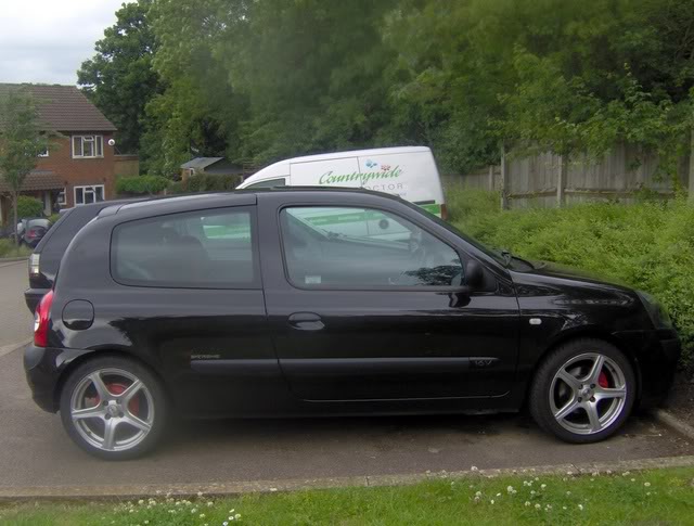

This is what it looked like on 35mm drop springs...
