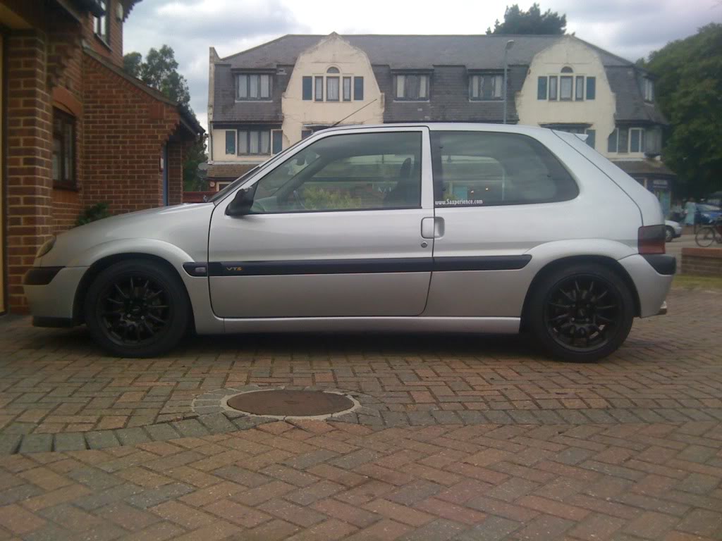

Hey guys, currently has a saxo vts which i love to bits and have made it a little minter however i just feel the need to move on. I have been looking at 172 cups for a while and this is the car i want, was a hard choice over the mk1 focus RS but i am still wanting to track my cars and crashing a RS will not be ideal.
just wondering what to look out for on them, the first thing that i will do will be a service from ktec, and the belts doing if not already done. Just any advice would be awesome cheers.
sneak picture of the vts in its former glory.
