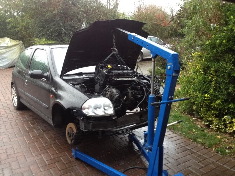

I took my turbo engine out yesterday, takes a few hours if you are just going fairly steady at it:
You will not be able to get the engine off the box without either taking them both out as a pair and then splitting or taking the subframe down so you can pull the box out, there isnt enough room to move the box over on its own without lowering that side of the frame.
