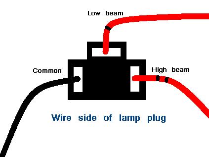

hi guys i got the 172 front lights and i want to put them in my mk2 p1 clio (non sport) they fit fine but cnt get them to work i know there is a guide on here if anyone could link it to me that would be great!

but for wiring I found this image more helpful:
If you've wired them up wrong before, or you've only got one headlight or similar, you've probably popped one of the fuses.
You'll need to put in a fuse for the dual headlights too (if you want the dipped beam to stay on when you use your high beam).
If you're still stuck just ask ;)
