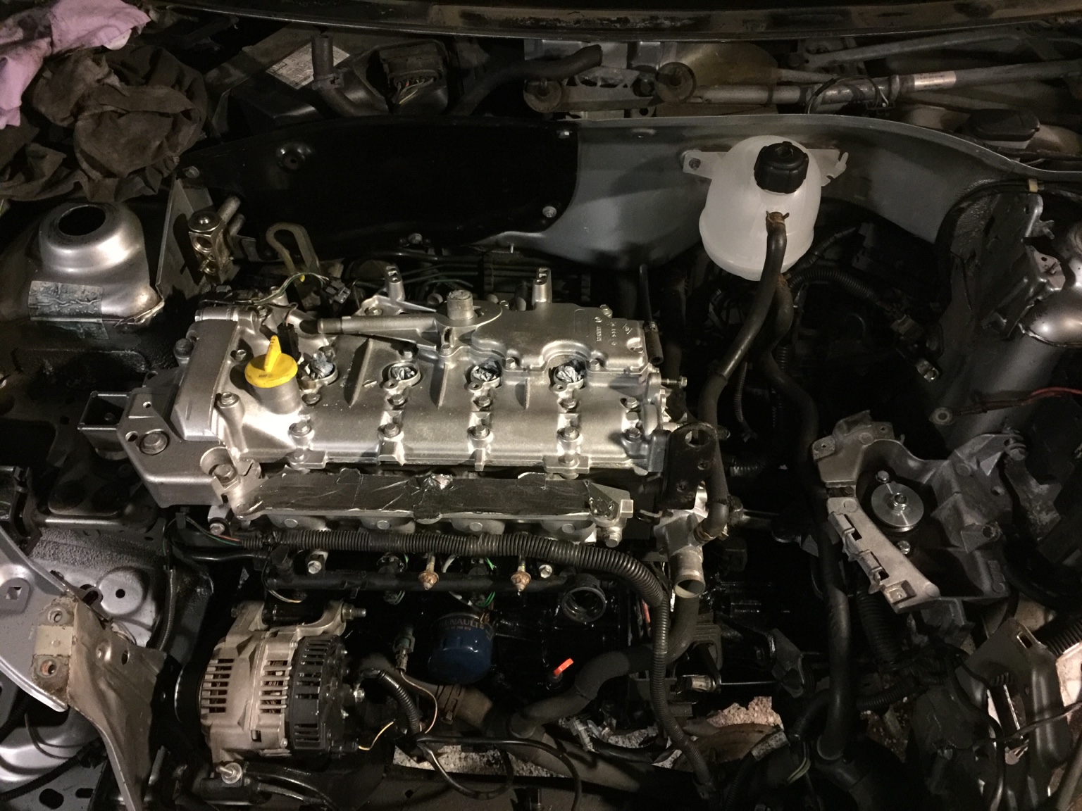

Is there a way to tell if I have a 172 engine in my car and not a 182 engine? Without it going on a rolling road

Take the inlet off.
If you have a flat plate you have a 182, if it has a big hole coming up 172.

So what am I looking for? :P
That's a 172 engine.

Cool thanks!
My current 182 just doesn't feel as fast as my old one.. The seller did have a 172 at his garage so it's just a thought that's come to mind!
Judging by that photo, I definitely have a 182 engine.
