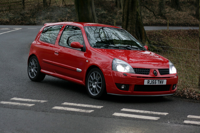

lovin the trophy! like the way the reg plate sits in the recess....was gonna do the same to mine but i heard they are illegal.
1 thing that bugs me on the trophy...why didnt renault paint the washer blanks red & not leave them black?
I think that washer blanks look fine in black, not really a fan of all the colour coding!
