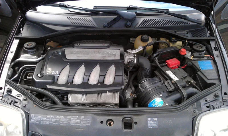

you can see it on the right there near the positive battery terminal, if its like mine it maybe hanging down the left hand side of the battery or under the filter housing
Blimey, never noticed that was there.
Mine's sort of loose, when I press it it does not lock in place but springs back.
Just took the cutoff switch off the car to test it. The outer most 2 pins seem to be connected to each other no matter if the switch is pressed or not.
