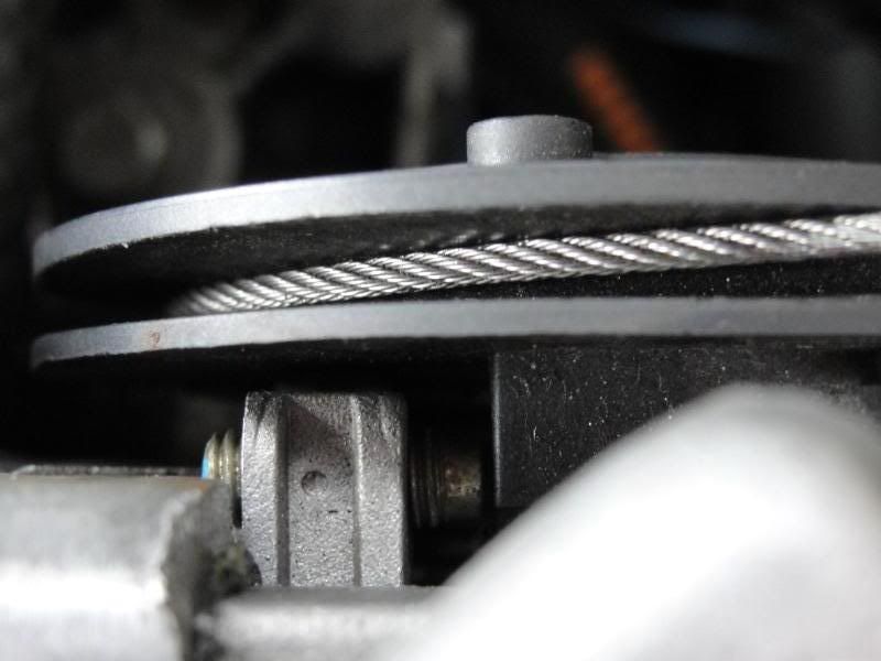

pretty sure there is a screw on the throttle body on ph1 that determines where the throttle body returns to at idle and can be adjusted with a small allen key. if you look top down at the throttle body whilst in situ, its at the back on the top. turn the black plastic disc by hand and as it returns to idle you'll see the part i mean as it rests against it, ill try find a pic
http://i108.photobucket.com/albums/n16/zzz555/4.jpg
Apparently changing the position of the screw can really mess things up. The idle control valve is there to modulate how much air the engine gets at idle.
