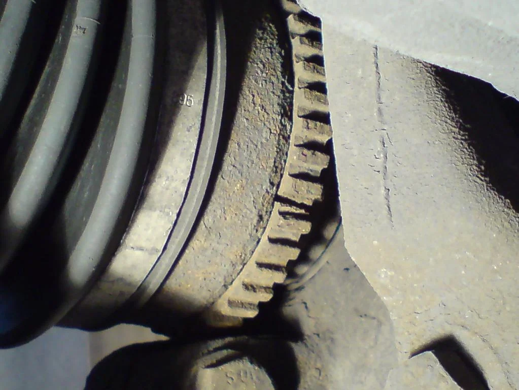

Hi Guys,
Can anyone tell me the part number for a passenger side ABS sensor ring. Mines Cracked and the ABS is doing my head in a low speeds.
I read a thread earlier where somebody mentioned you can buy them separately but i can find a PN.
Stealers told me I would need a whole new driveshaft?!
Dont fancy paying for one of them when its fine, can anyone help?
i got one off ebay cuple weeks ago for £10, just checked there but doesn't seem to be any on, but keep checkin as there was a few on last time
