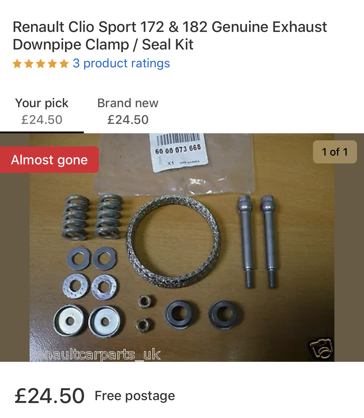

Thanks. Sounds like I’ve been mis-informed then. Does the cat bolt straight onto the downpipe then? Are there any common weak points that blow other than the cat in that area of the exhaust?
It's probably blowing from the fire doughnut gasket ring thing between manifold and cat
Really helpful thanks. Assume this would be the kit I’d need to replace if so:
