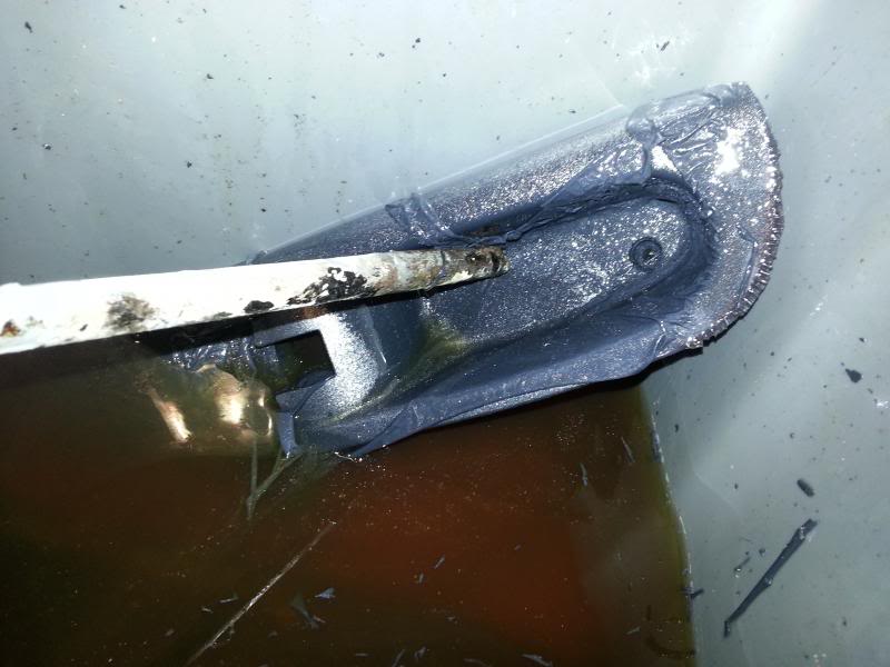

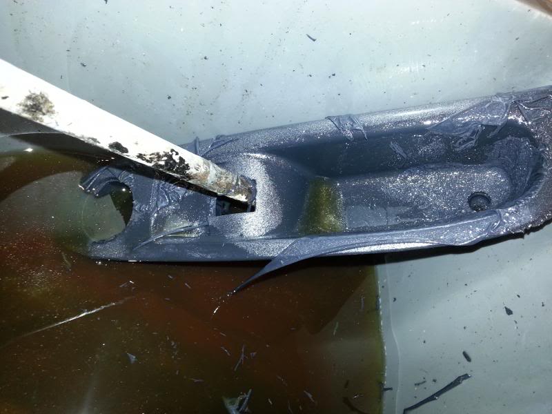

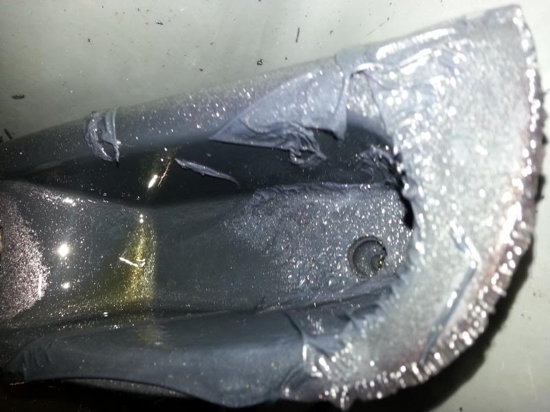

It might sound strange , but soak them in neat Dettol . Its a tip I got off a modelling website . It dissolves the rubber coating on the grab handles and it just peels off .

I left them soaking overnight . The rubber coating just fell off . I only primed mine , haven't got round to finding the right colour I want to paint them .
Thanks for the tip. I soaked the first one overnight last night and I just checked it earlier and the rubber coating has completely fell off.

Nice one . Apparently you can use Dettol to strip alsorts of paint from plastics . No wonder it kills germs if it's that strong lol .

@Kchristmas . It leaves the bare plastic below , ready for a light sand down and prime . It doesn't discolour it . Make sure you give them a good wash in hot soapy water cos that dettol stinks lol
