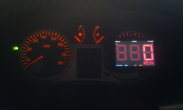

Oh well, since there seem to be no answers I've had to resort to a ghetto mod in its place:
If anyone has any other ideas as to why it's not working I'd be glad to hear them! The ABS rings theory seems to be out as a local Clio owner has tried comprehensively to find a link from the ABS sensor on gearbox speedo sensor equipped Clios using a CAN Clip and can't find anything there.
