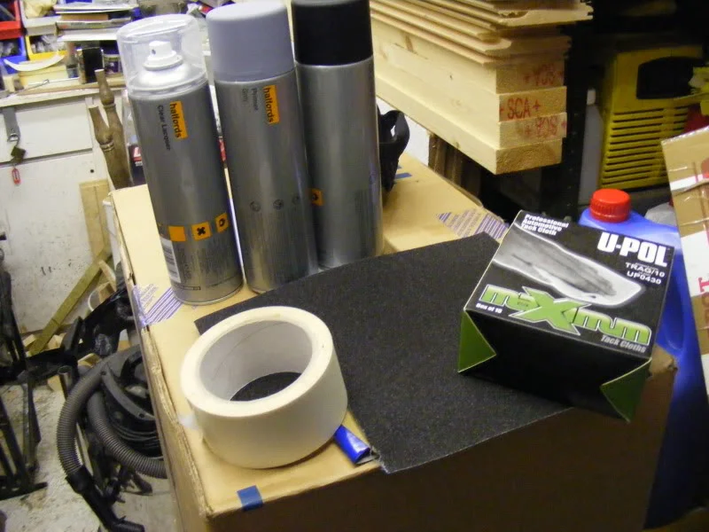

1st up, tools for the job. So far I've spent about £18:

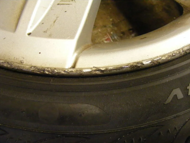

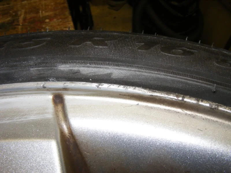

Just to make a point of how badly kerbed these wheels are:

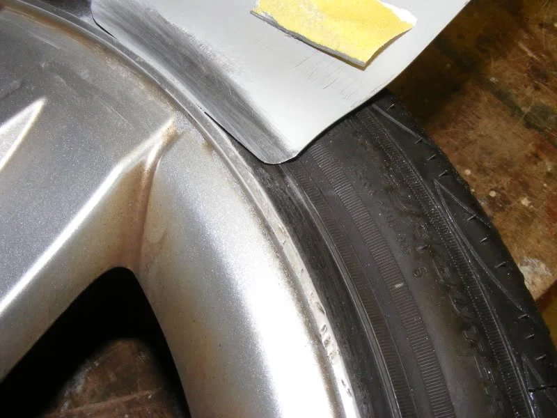

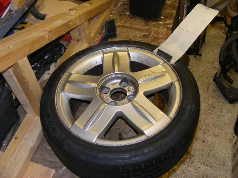

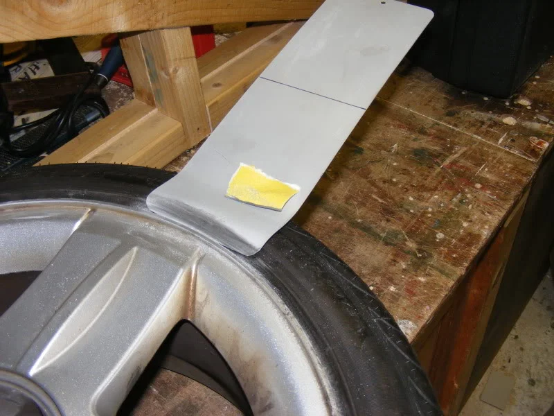

Now the tyres are still on the wheels and I'm starting off with 60 grit, so a wee trick I'm using to be able to go at it properly without sanding my tyres down... a strip of metal between the rim and tyre:

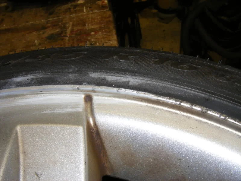

After a bit of sanding (this took about an hour so far, and I've done about a 3rd of the rim :( Sanding by hand ftl) this is the result, I've taken the pics where I'm sanding to show the difference:
I'll update again when the wheel is painted to show the difference. I'm spraying the wheels satin black and I'm trying to decide if I should try polishing the outer rim or just painting it too. I've also got some 10mm spacers so my cousins going to see if he can get me some longer wheels bolts from where he works and if he can they'll go on aswell. Once this is done I hopefully will have enough left in my budget to get myself a standard spoiler so I can get rid of the handle on the back of my car :(

You say you spent £18, but I see 3 halfords rattle cans and they are atleast £5.99 each, so... did you have some of the stuff already? or did you get discount? If so how? I might need some more halfuds bits for my project!

I have some laquer lying around already from when I rattle can'd the S13, so I only bought a can of primer and a can of paint.
  Mustang, S13, AX GT
lol, not quite but getting laquer from autopaint kinda works like a discount, I think its around £3.99 for laquer there instead of £6.99 from halfords. Sandpaper was 97p from wicks, and masking tape dad pinched from work. winner :D
