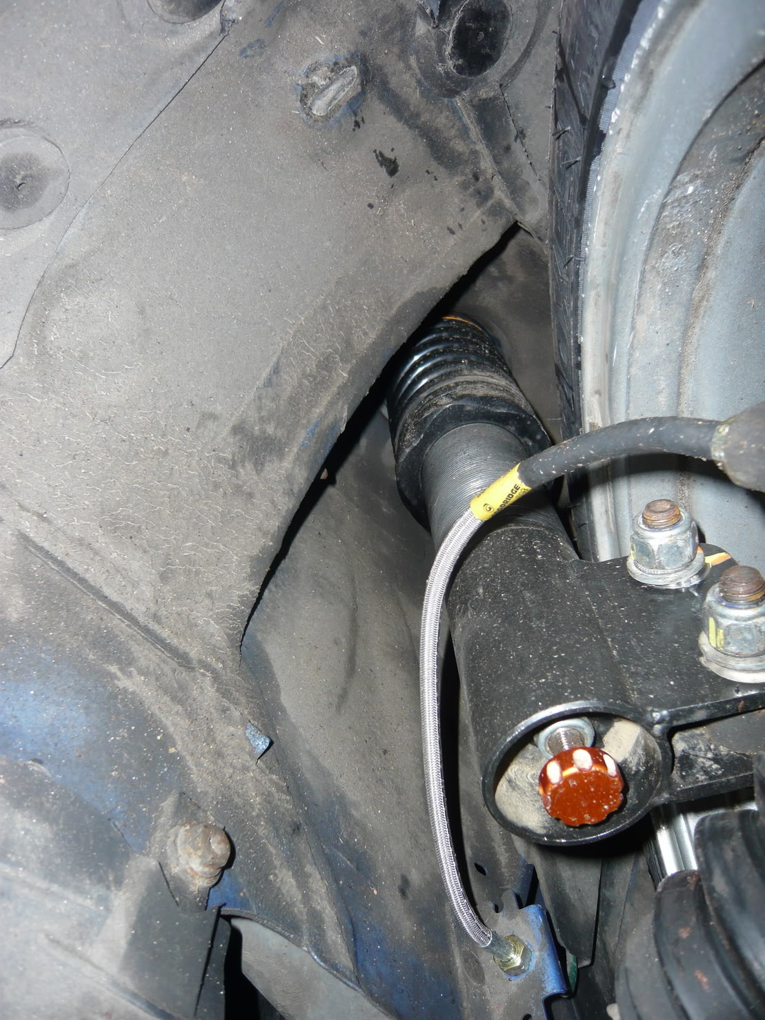

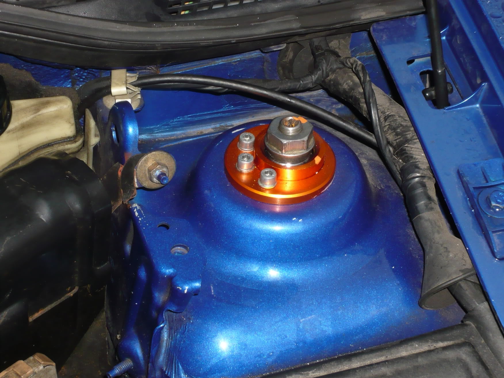

- Remove all dampers and springs. Check supplied AST dampers. Clean up damaged threads and replace missing bolts etc. Strip apart and add bump stop material to fronts. Re-spec springs and platforms for road/track use (was set up for Rally/Stage). Refit to vehicle and check for suspension travel to determine bump stop length etc.
- Set up ride height for cambers, track alignment and steering wheel centre point. Found Geometry to nearside front not consistent to initial settings. After some checks found nearside front lower ball joint to wishbone not to the correct spec for this vehicle. This was causing the wheel to be set back in the wheel arch by 18mm. Modified bolt hole alignment in wishbone and weld secured. Fault corrected.

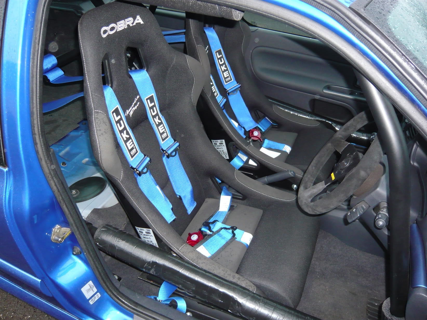

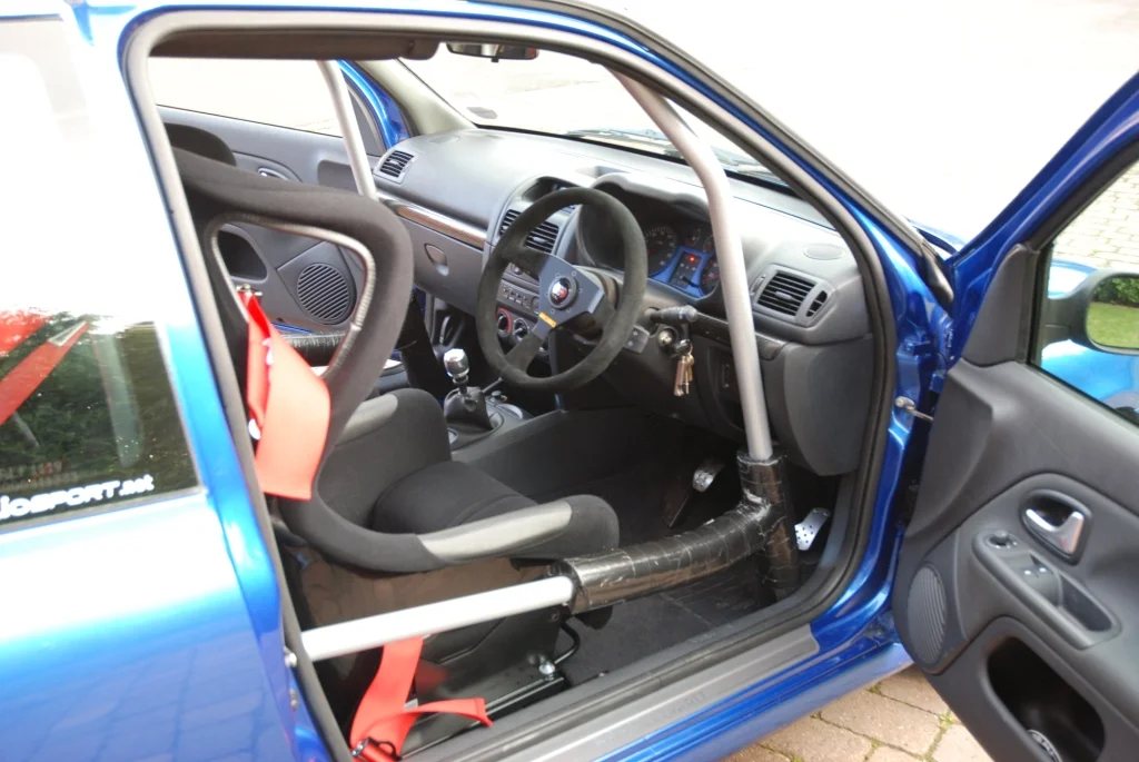

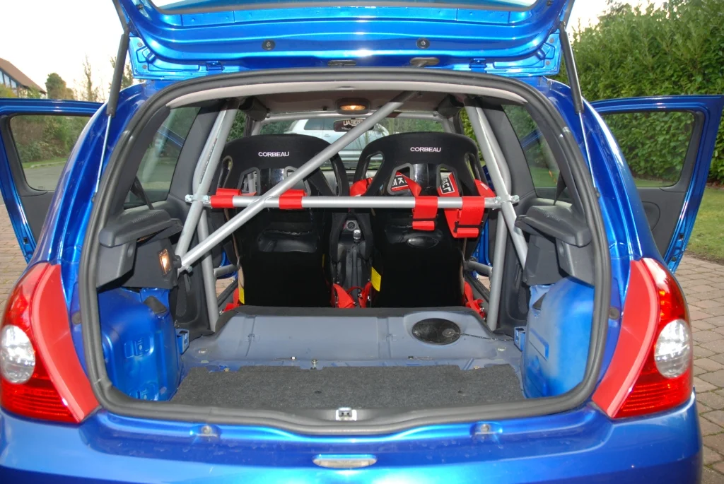

- Strip down suppled seats and side mounts. Cut down steel side mounts to allow a low seat position. Make modifications to standard subframes to allow correct position and a low seat height. Welded steel plates to subframes to allow for seat adjustment and fitting.

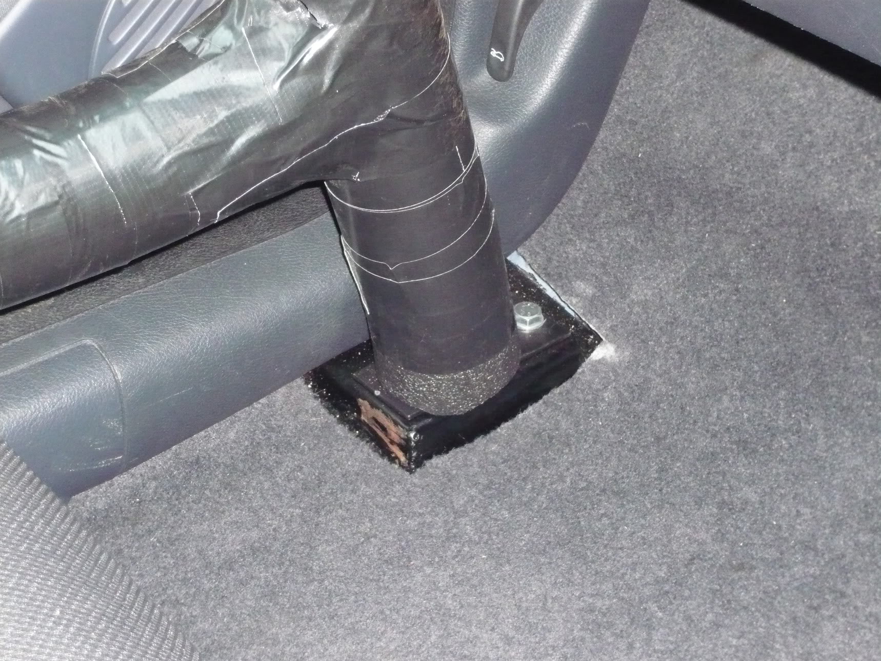

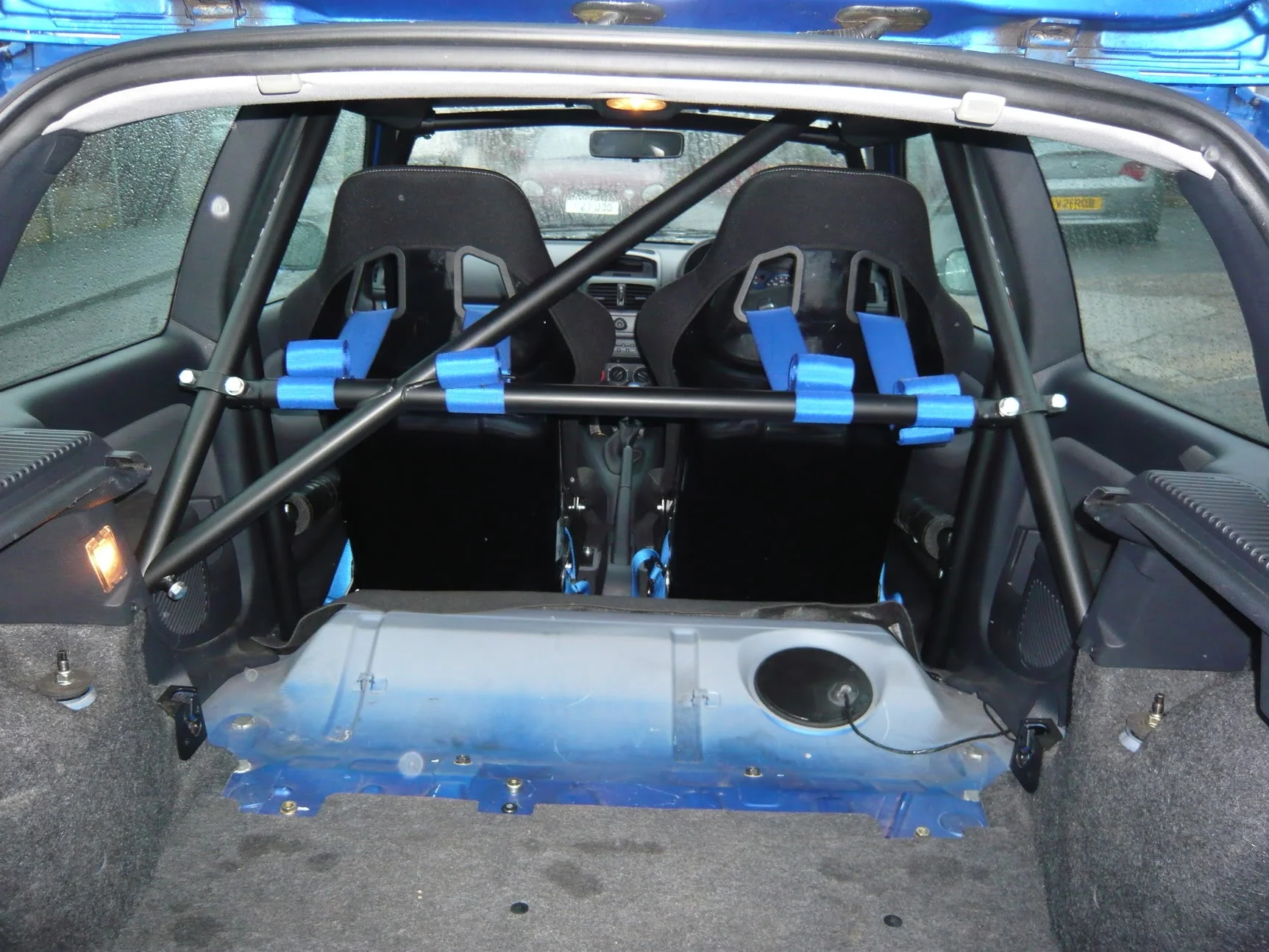

- Strip out interior and fit full roll cage, weld in floor plate towers. Underseal and paint protect bare metal areas. Seal off plates to rear arches. Fit and shape roll cage foam to the cage.
- Fit new steering wheel and boss. Fit two five point seat belts with three eye bolt reinforcement plates each side of the car. Fit new belts to harness bar and adjust to fit.

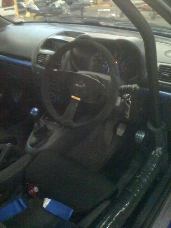

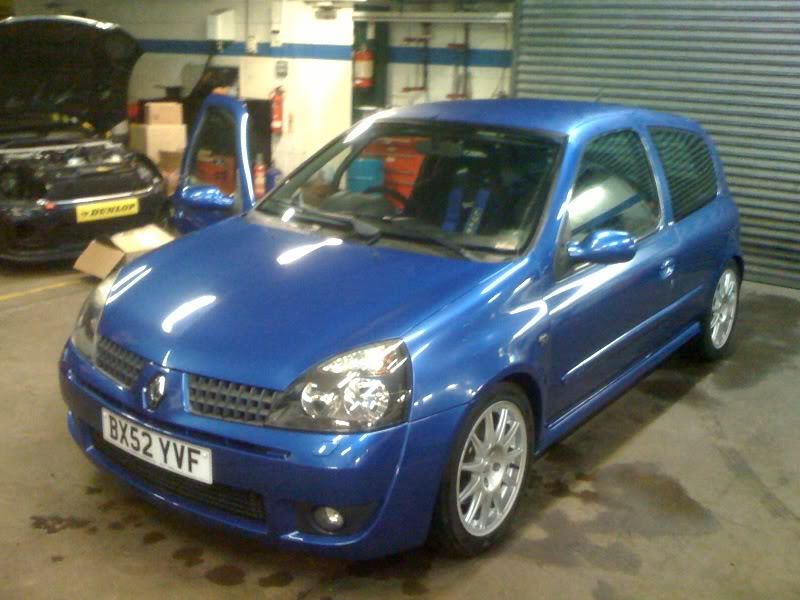

Well i picked the car up last night a couple of days earlier than planed it's the first time i've seen it since dropping off. I'm very happy, it's certainly given the old girl a new lease of life.
I had to drive back from Harlow to Billericay and decided to use the A414 and country lanes which was a good mix of roads. The engine work has made a huge improvement, before it was very rattly due to the engine phaser pulley being shagged, i can't particularly tell a huge amount of difference in performance but it doesn't sound like a bucket of bolts now which is good.

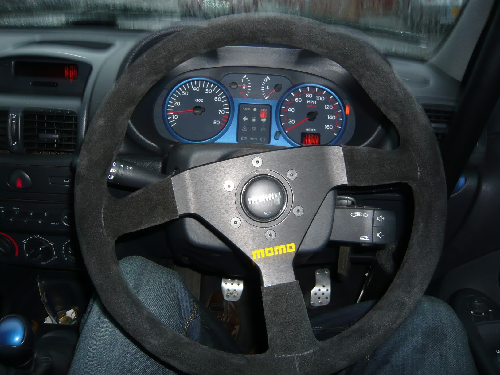

Having the momo wheel put in and the bucket seats has made a huge improvement, i hated the big wheel and driving positon in the car, it felt just so uncomfortable and on top of things, i think it was a pain in the arse to get the seats low but defintely worth the time taken.
It's the first time i've had a caged car and it certainly feels like you're in a proper mini racer now. Not sure it was a good idea having the seat belts removed, bit of a nightmare being at a junction with 5 point harneses.
I was amazed on the drive home at the handling, i didn't give it huge amount of spirited driving what with the car being new to me and having brand new uncrubbed Toyo R1R's on, so i was doing say 60 in a 60 but wasn't particularly slowing down for bends, boy can this little pocket rocket take them at speed with the AST II's fitted, i was really amazed at just how comfortable teh ride is though, i really expected B roads to be a disaster, getting thrown all over the place and horrible crashing noises and it's just not like that.
Brakes i haven't realy tested but i'll book an afternoon at Brands Hatch and get a real feel of the car.
All in all very please.

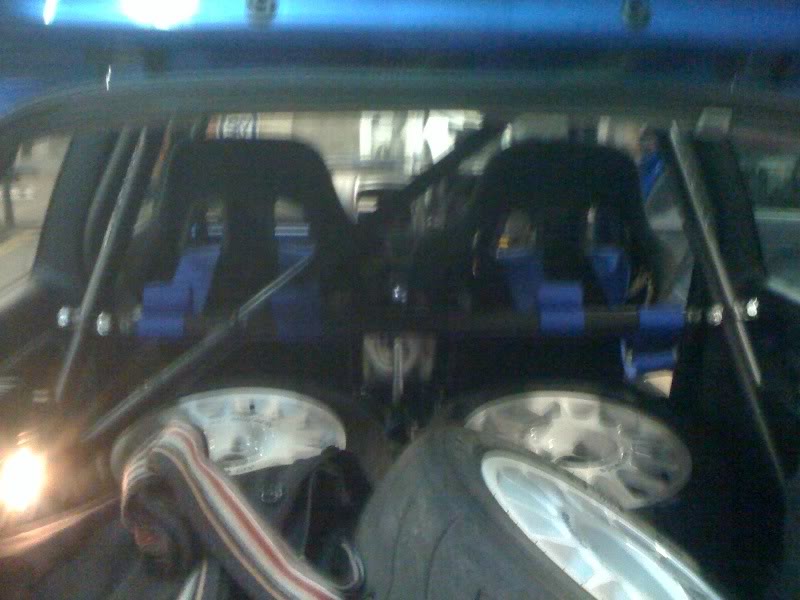

Here's some really rubbish Gen 1 iphone photos i took last night with bad lighting, i'll replace them at the weekend with some decent SLR shots.

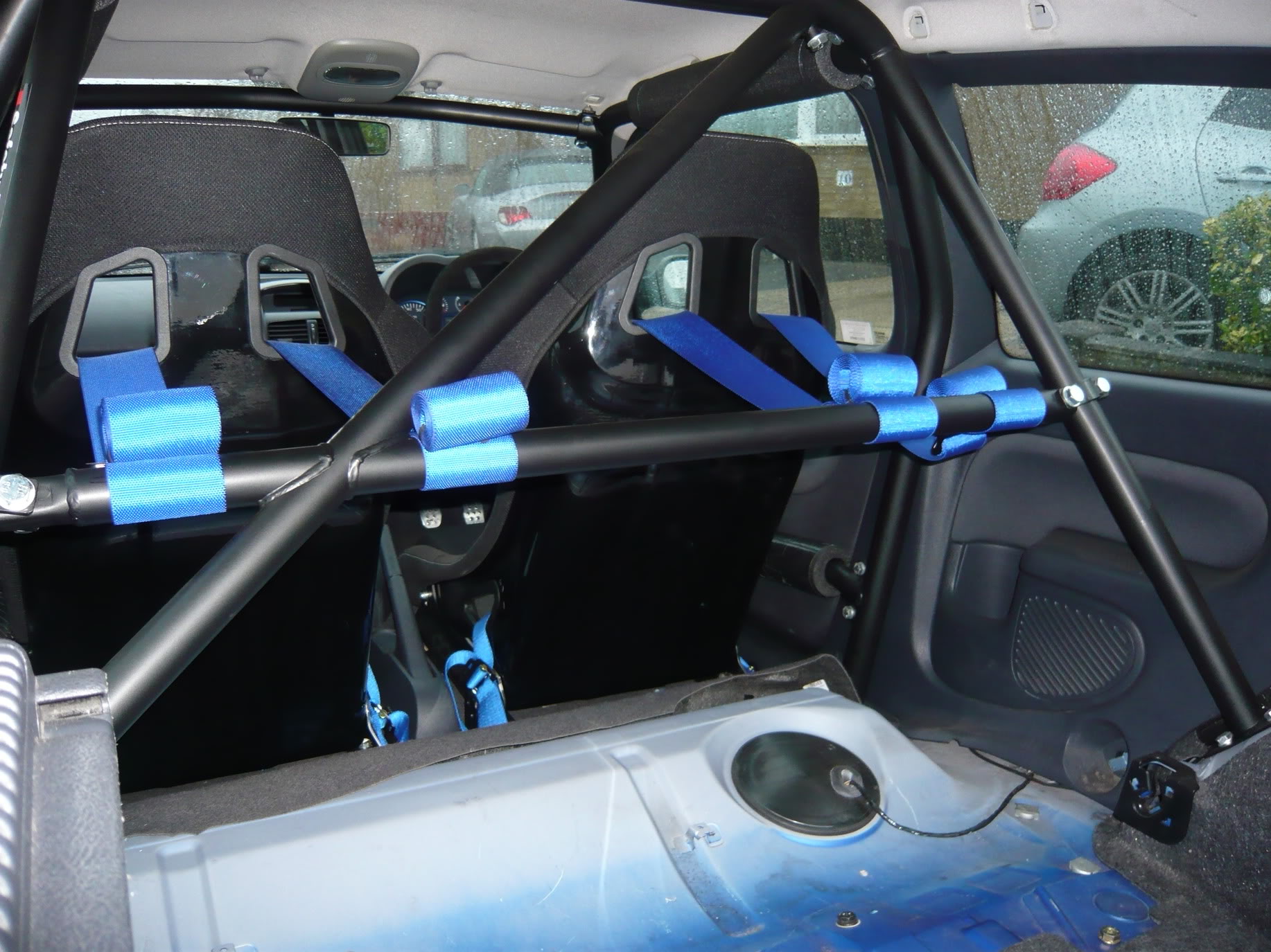

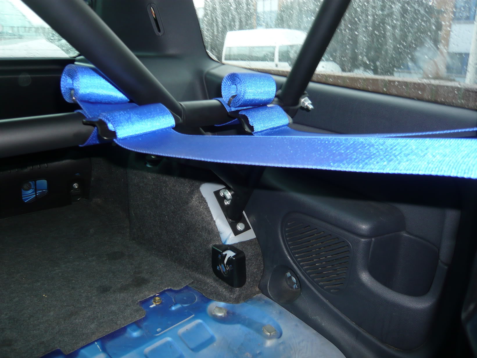

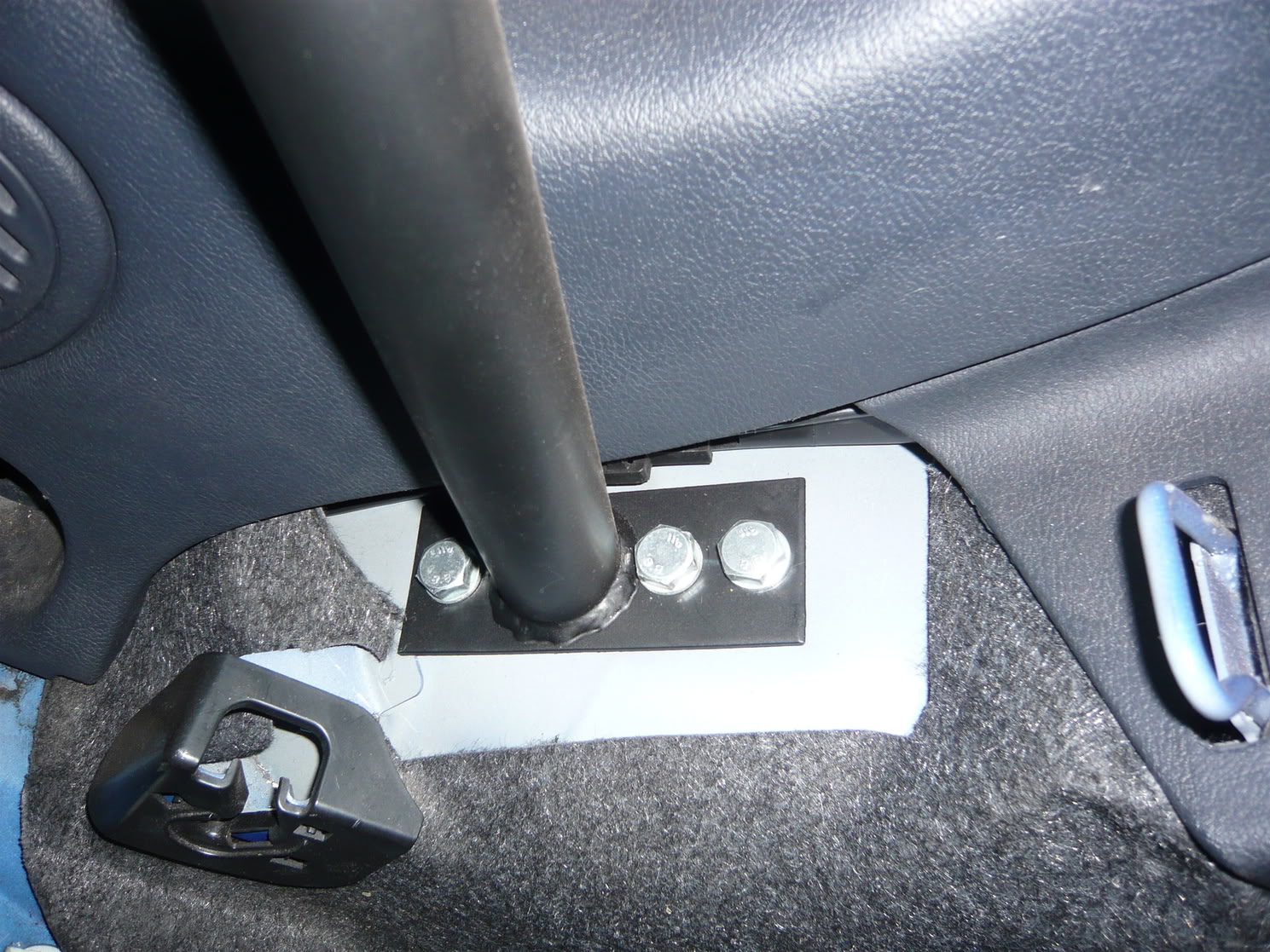

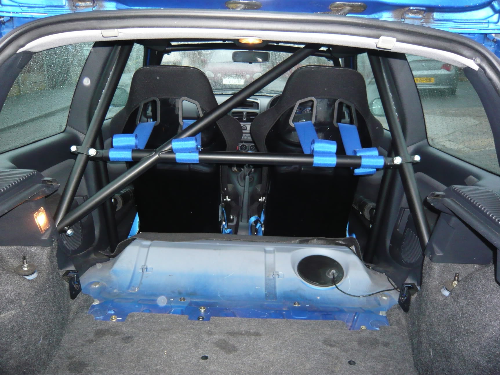

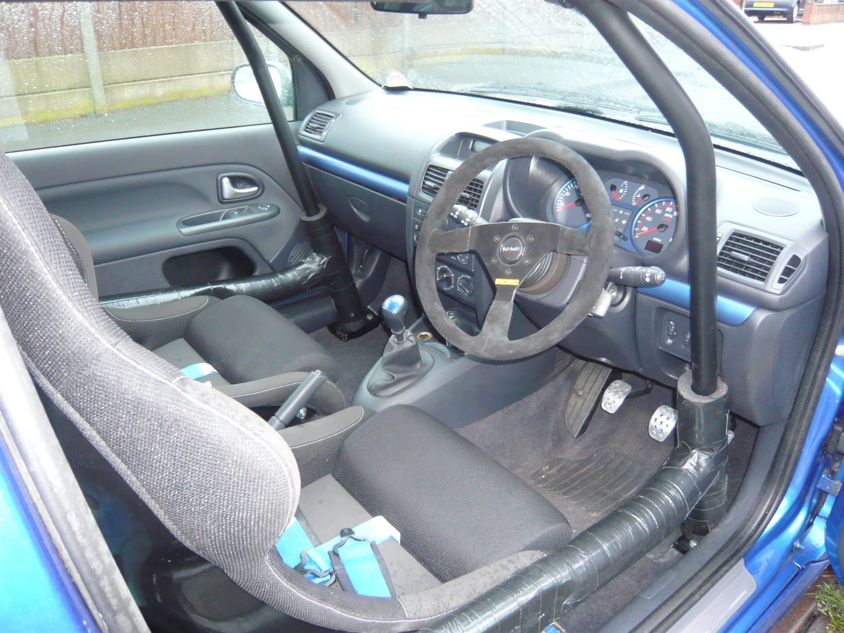

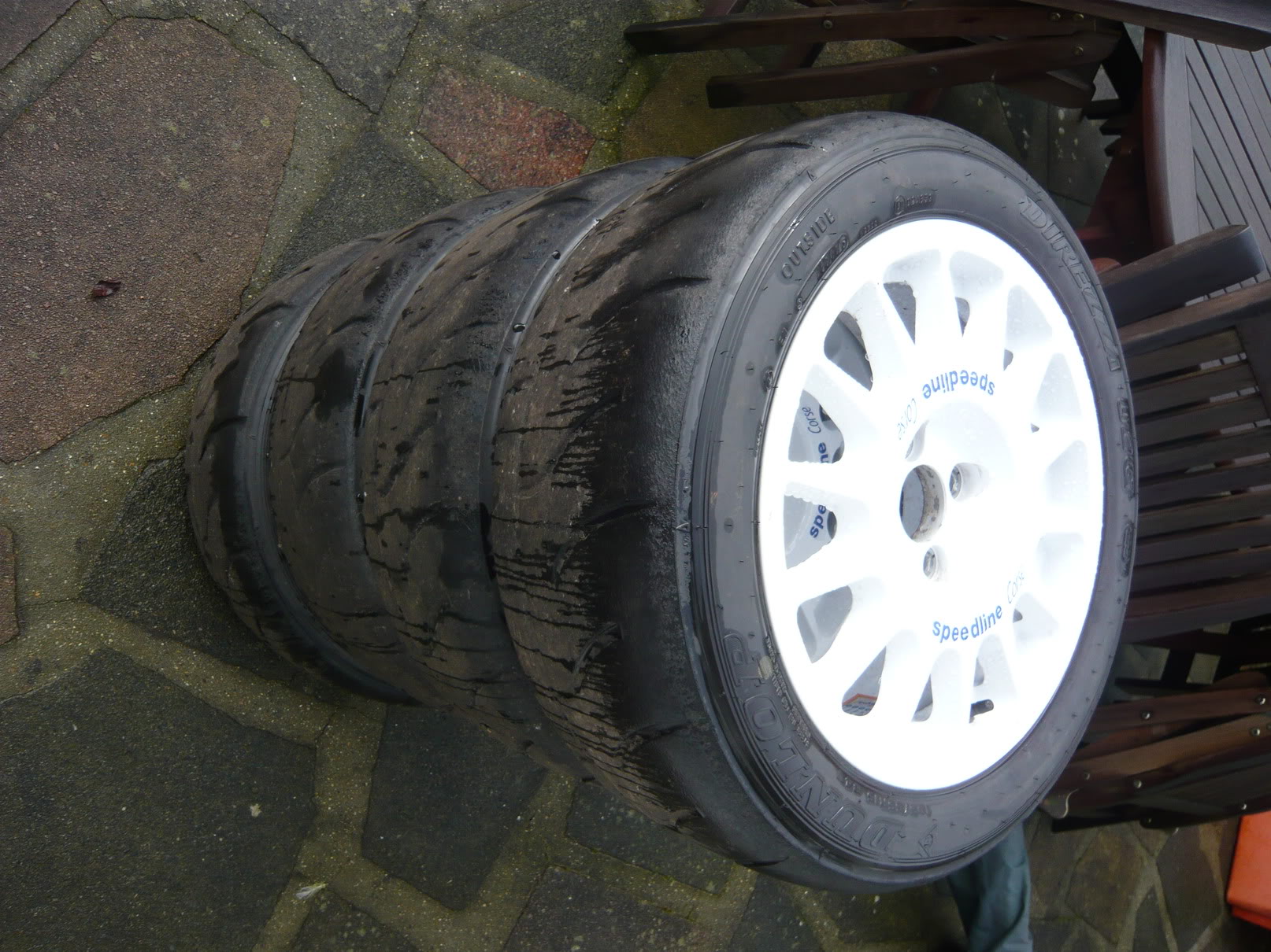

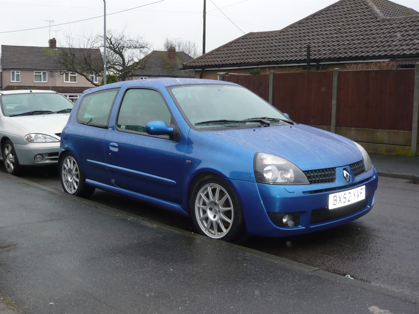

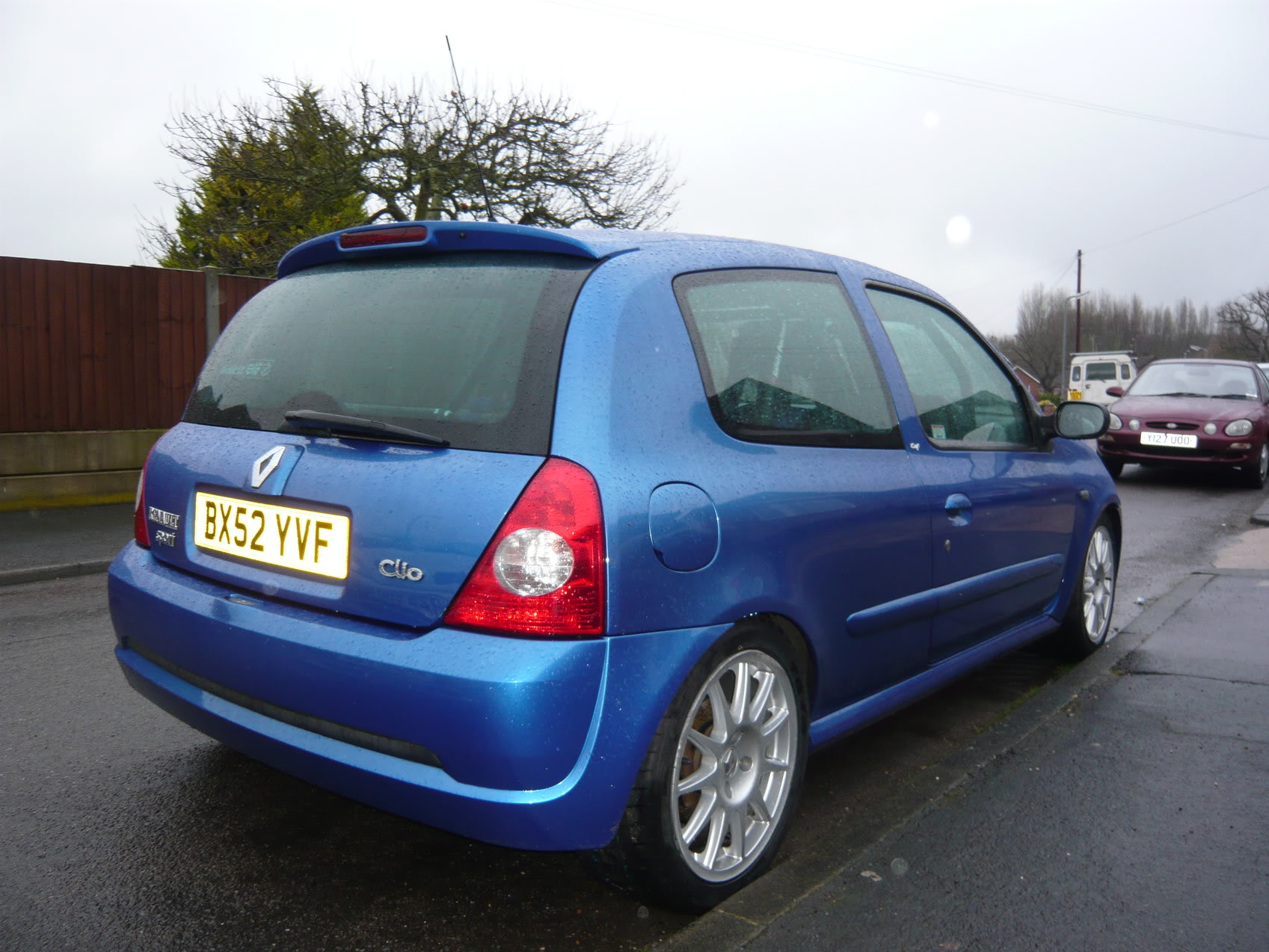

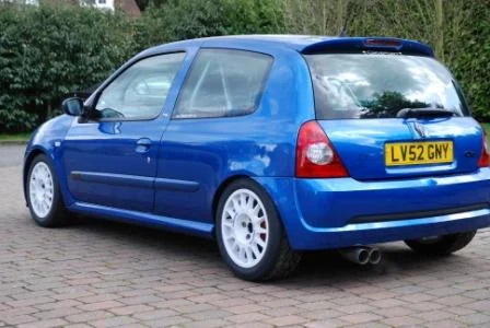

Well it sailed through the MoT, the guy did say that for that it was a grey area witht he top of the roll cage above the screen falling under the top sweep of the window wiper, anyway here's some semi decent snaps.
Dunlop Direzza 02's on 2118's for the track
  MK1 Mexico, Clio 172
Apologies not sure what happened with my English there, i meant to say....
"the guy did say that it was a grey area, the roll cage being under the top sweep of the window wiper, some people might fail it. Anyway here's some semi decent snaps."
How do i edit a post?.... err just seen the edit button, sure that wasn't there before

BTW - love the car - but I am biased as we have almost exactly the same - thanks to Mark Fish. Well worth the money.

I want yours seats Bugracer ^ I like them :)
