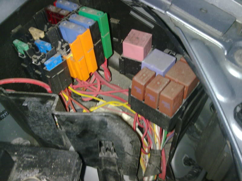

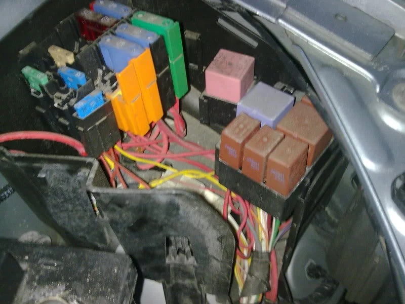

haha yeh got 21L yesterday got nearly half a tank, just been told i might have tried the wrong relay. hang on a min will get a pic up
  Golf GT TDI
changed the pink one but think its a brown one?

I have had issues with the one of the 3 little brown ones before, but not for a loooooooong time! So can't remember which one it was! :( Im s**t! lol!
Has the 5 amp fuse blown near the relays?
right hand one is usually the dodgy one from memory

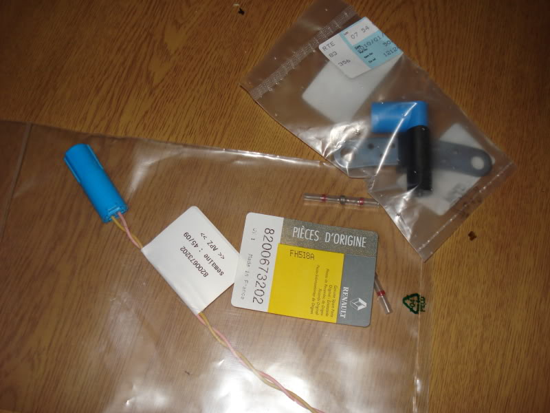

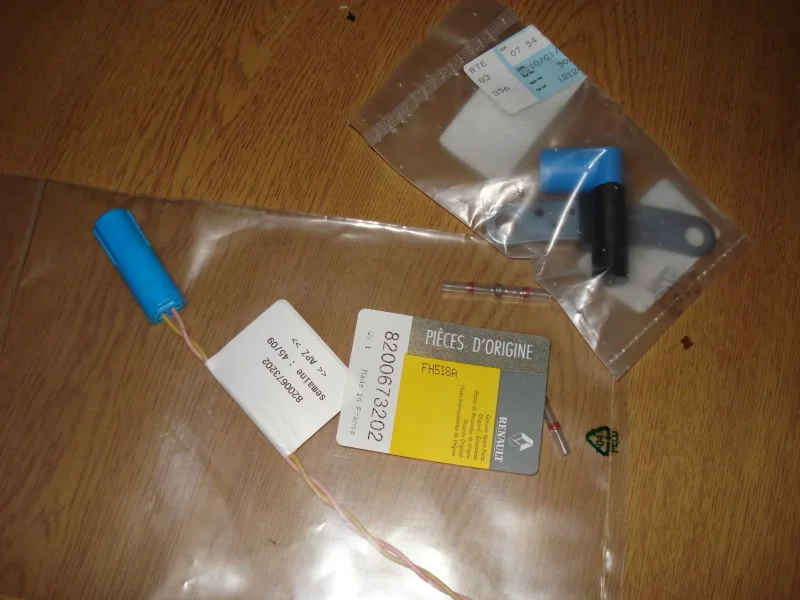

hi steve got this to try first
just to rule out the connetion.
but its a bit to cold and dark to do now.
the little heat shrink sleves just push the wires into them stripped and squash the metal bit in the middle?
i was going to krimp it but these came with the kit

You dont crimp them connections. You place the wire in them either side and heat the whole sleeve. The heat will melt that metal piece and bond them together.
Also note sometimes the wires swap positions. Just match the pin numbers (a,b) to the new plug.

Before you fitted the Tdc sensor, did you just cross the wires with each other first to find the correct way? i didnt and managed to put them wrong way, after about a month of piss farting about trying to find the answer i decided to swap them over and hey presto it fired.

ah right. well the old connections were marked on the plug
A=yellow wire
B=white wire
new one is
A= yellow
B= pink
so matched them up yellow to yellow A-A
pink to white B-B
think this is right?

Did you use the plastic thing to melt across them? i didnt because i needed to make sure it was the correct order first, i would go out and check for you but its freezing sorry,
But just losen them up then twist the ends so their tight and join Y > Y W > P then swap, it could be this, but not sure why renault have changed the colour of the wires tbh, its worth a try,

no i didnt i krimped them.
yeh i could try changing them but cant see it being A to B and B to A surely?
