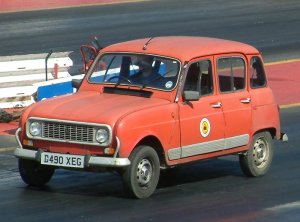

if you want a sleeper... get a Renault 4 and put a 172 engine in... preferably a really rusty looking R4
imagine being overtaken in that!
http://www.slowcarclub.com/renault4.html
LOL

172.com said:
They don't make cars like they used to!
I'd forgetten about that car, W-T-F were they thinking?
My dad had one of those years back, heck, he had two!!
