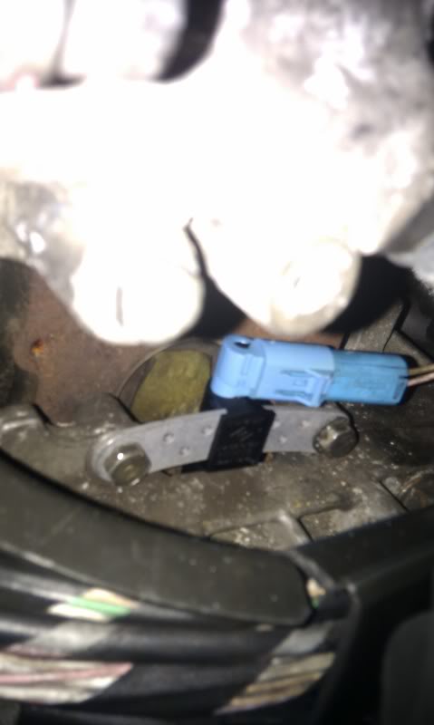

Crank sensor.
On top of the gearbox where it meets the block. Held on by 2x 10mm bolts.
Airbox out and it's visible on the block just below the thermostat housing it's got a curved bracket and is held on with a bolt (10mm head iirc) either end. Not hard just a bit of a faff due to it's location.

This is what the new sensor looks like. This is a genuine one i got from renault 2 weeks ago.
