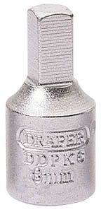

What type of socket do i need for the sump plug ?
Is it a square one ?
If so what size ?
And how much oil does the 2002 172FF hold with an oil and filter change ? ?
8mm square 3/8" socket . Halfords sell them for a bout a fiver iirc .
5.1 litres of oil with a new oil filter , but you might get away with 5.0 litres due to some sediment in the sump .
