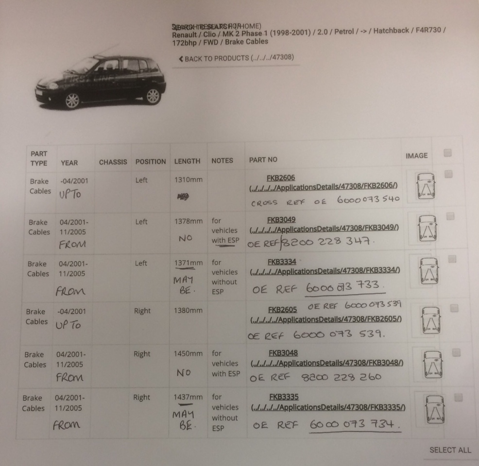

182 / 172 hand brake cable length
Instead of me making another post, anyone know the length of both cables? found pattern parts matching the oe part numbers but want to double check the length
172 ph2
TIA
Rather than me making a new thread , here’s my findings with regards to the cables .
I’ve read first line ones are pretty good fitment .
So on that note I took the punt and ordered both today . Let’s see what turns up tomorrow.
Feel free to use my findings , I hope it helps everyone out for those who are unsure.
