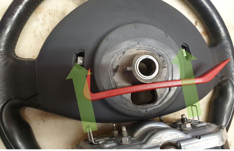

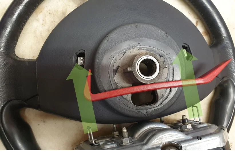

Hi VR - I looked at wiring under seat and all looked untouched factory as tidy. Checked connections and all seemed fine. So decided to take of airbag and look at connections. FYI videos on YouTube show you have to remove the steering wheel plastic cover/cowling to remove air bag - you don't. The airbag is held to wheel by just 2 thick wire/rod loops that snap over 2 matching metal spurs on the wheel. The loops just need to be pried off the spurs and I found a right angle plastic trim tool (see pic) was the perfect tool. Anyway ... took it all apart unplugged everything, found nothing wrong and put it all back together and it was fixed with No Airbag or Service light. Somewhere must have been a slightly iffy connection. Many thanks for taking the time to give me your help - much appreciated.
