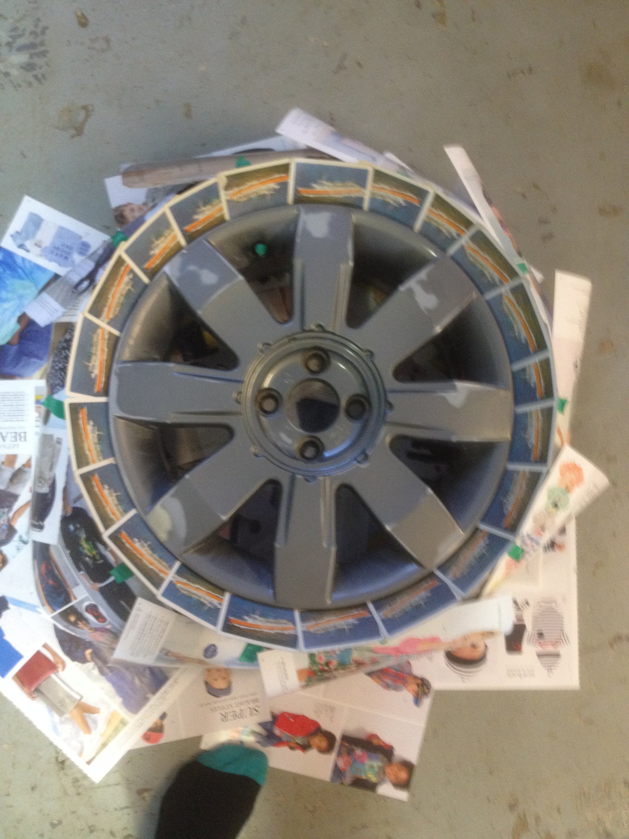

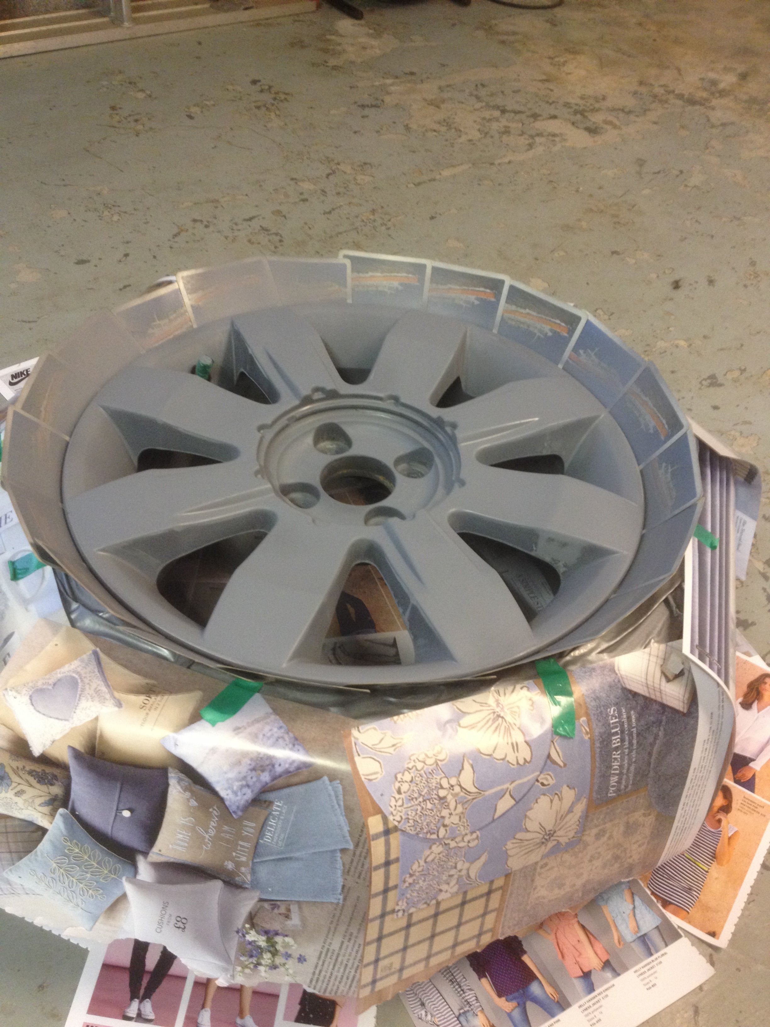

Thought it would be a good idea to refurb my 182 alloys in time for summer. Only two need doing and I didn't fancy splashing out £100+ for them to be professionally done. In an ideal world I wanted all four to be bmws sparkling graphite, however funds and the fact two are in great condition put me off the idea. So I thought a DIY refurb on the two would be a good idea. I cleaned then sanded down the areas of curb rash and scabbing also keyed the areas which weren't.
I then bought some primer from halfords and gave them three coats. Some areas will need re sanding and priming which are clear to see now. However I can't find a rattle can paint code for the anthracite colour? I am now concerned I can't get a matching paint code and will have to do all four.
Has anyone got a paintcode for a rattle can, or have any advice where or how to find one?
The pics below are before primer and after one layer.

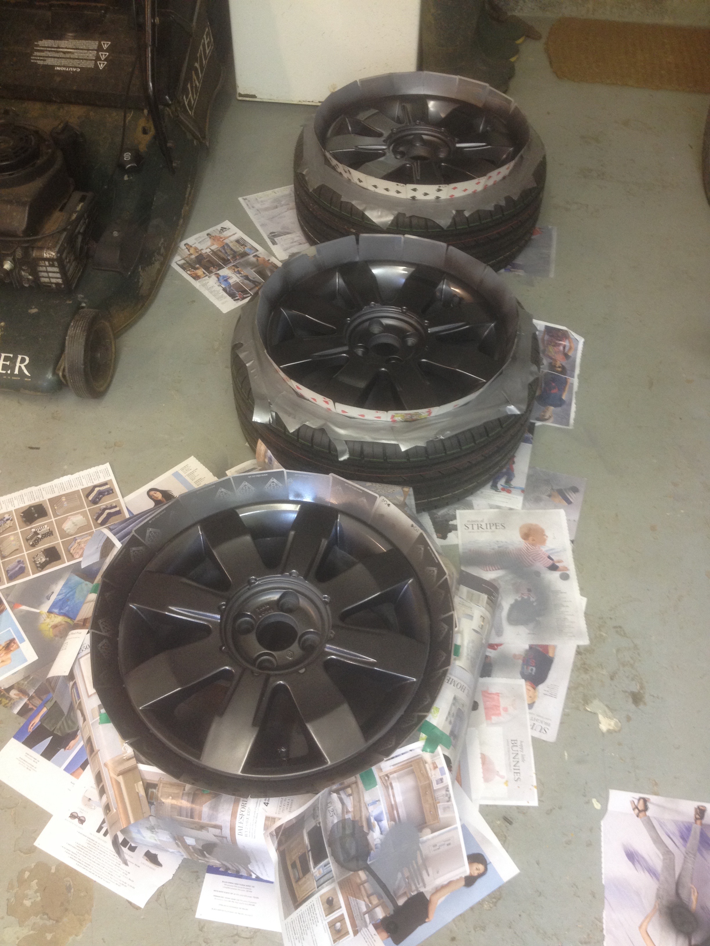

Considering I had never used a compressor to paint before I played safe and went for rattle cans. The finish won't be perfect, but hey it's my first time, got to start somewhere. I've just applied a final coat of colour, attached is a pic of them drying. The colour is BMW sparkling graphite, should look good against a blue clio. My next question is, what lacquer do I use? Will ordinary lacquer withstand the wear and tear of alloys? Halfrauds do some heavy duty stuff but it seems to have poor reviews..
