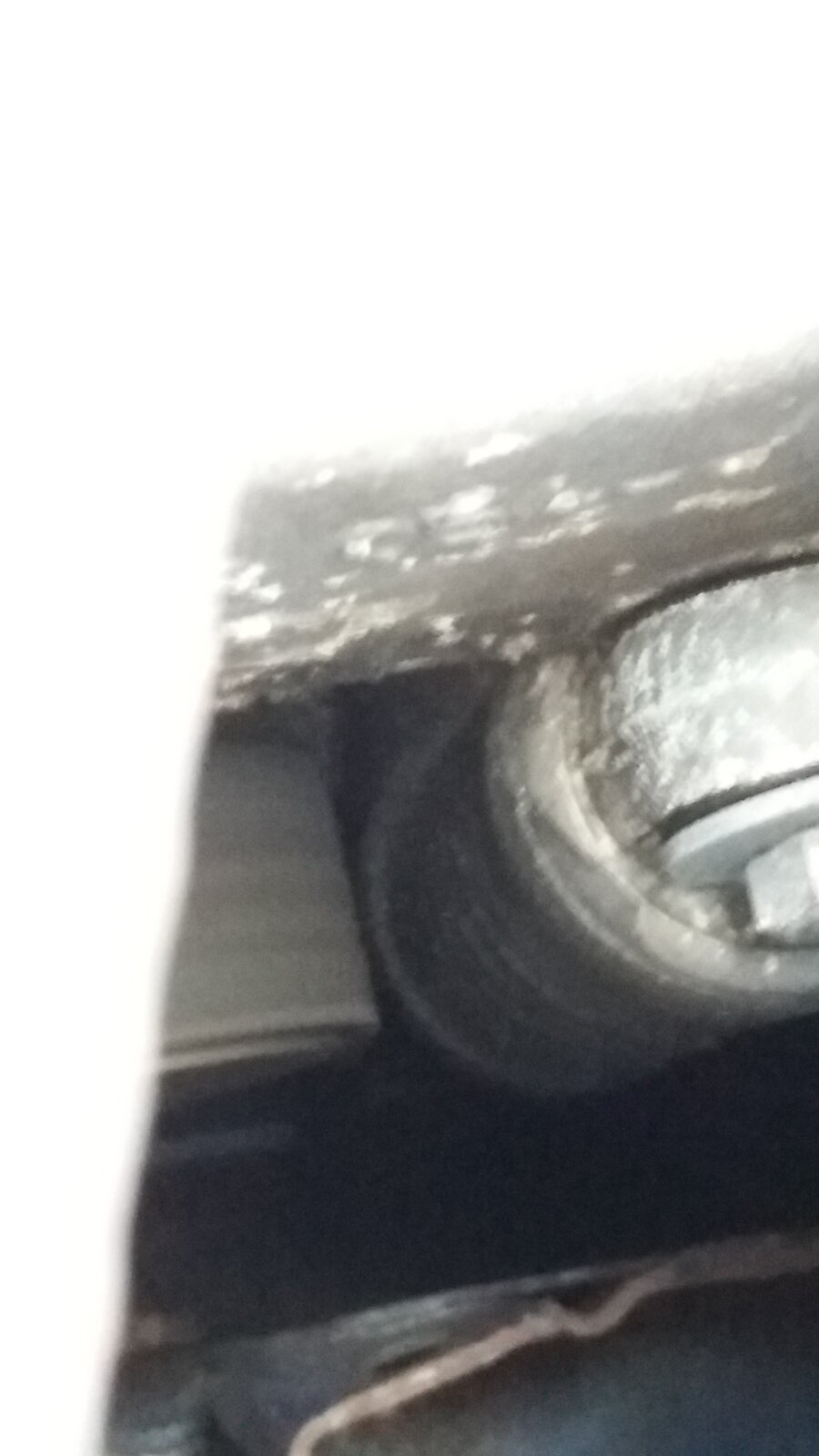

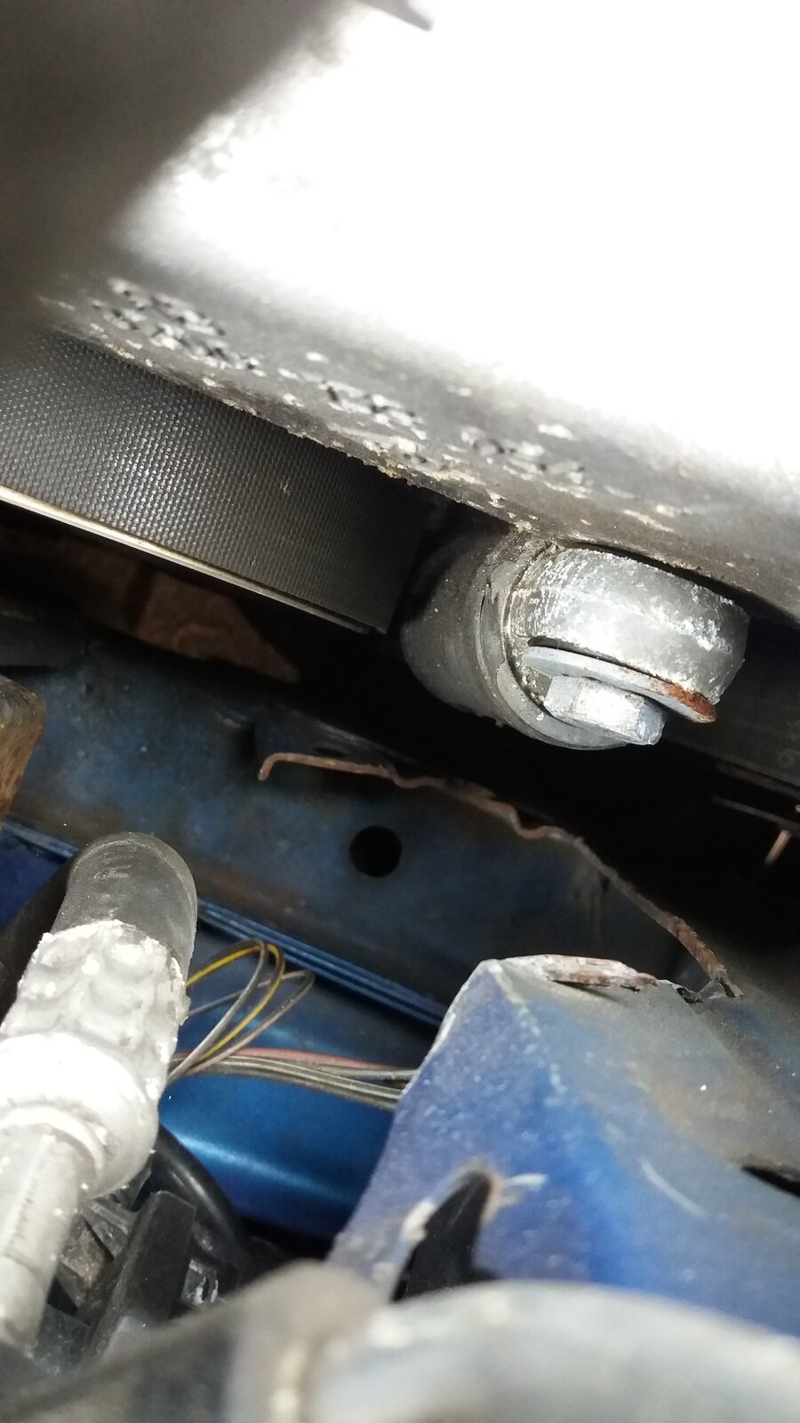

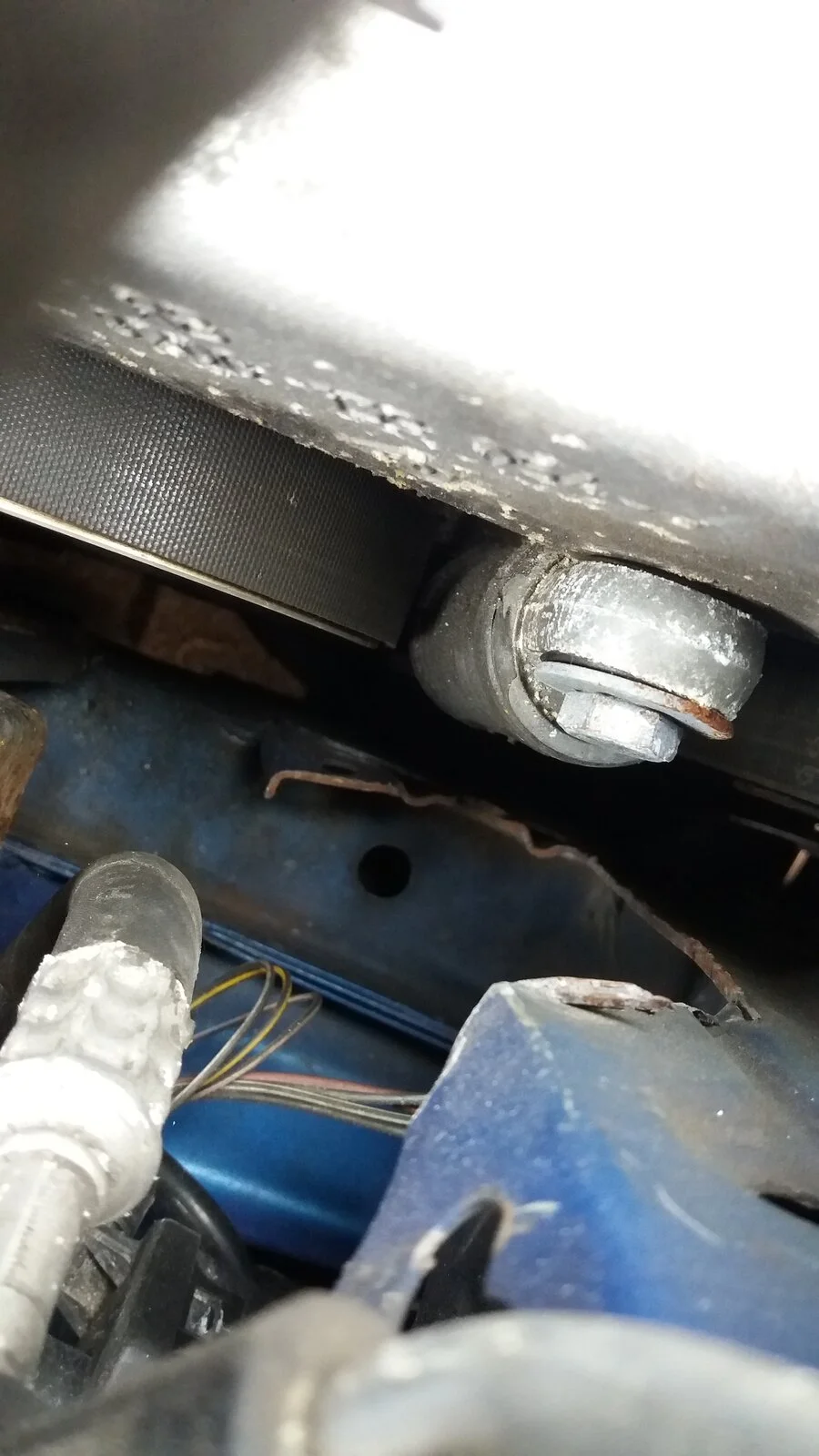

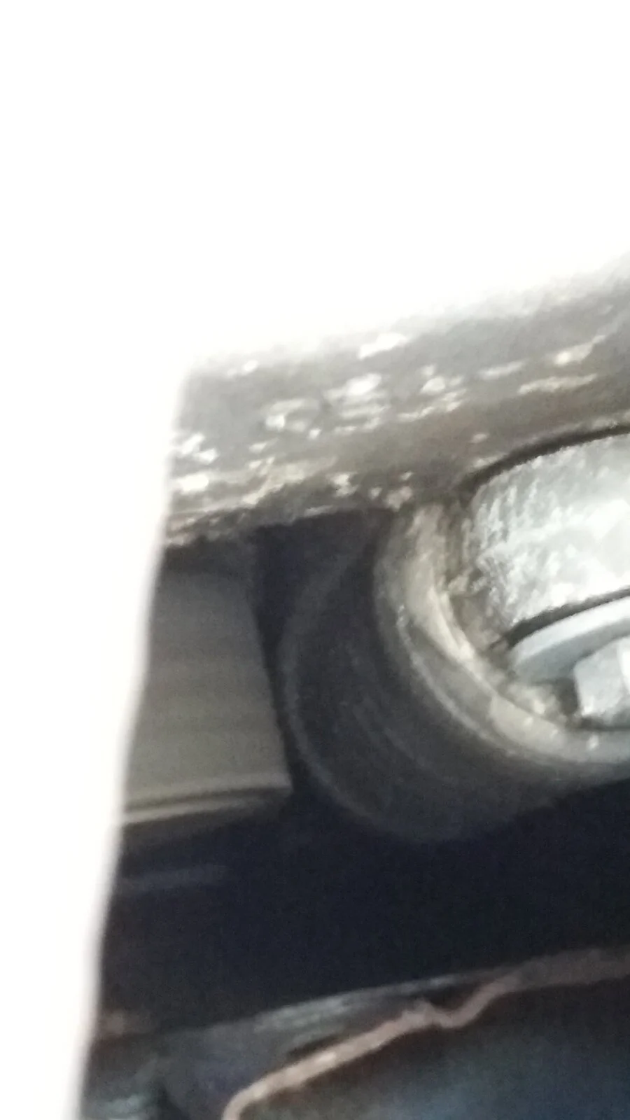

I've been reading a bit about alternator, Tensioner and noticed that there is only about 1mm or so between the tensioner and aux belt, it looks nervously close to rubbing on the tensioner.
Does that sound like the tensioner has seized ? Is so would that affect the car charging when the engine is running ?
The aux belt kit was only fitted @Birchdown April 2017 , just 14,000 miles ago. Just wondering if it'll need a new aux belt kit again if the tensioner is seized after being stood all this time?

There's definitely no signs of any rubbing on the belt , the dark patch on the spring is just a bit of s**t.
