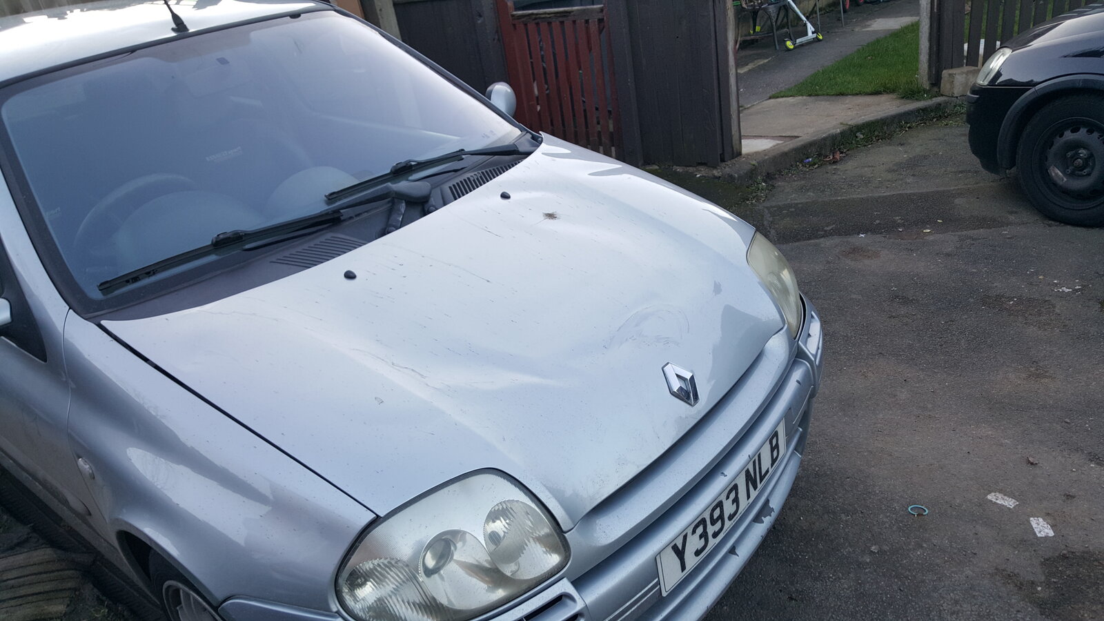

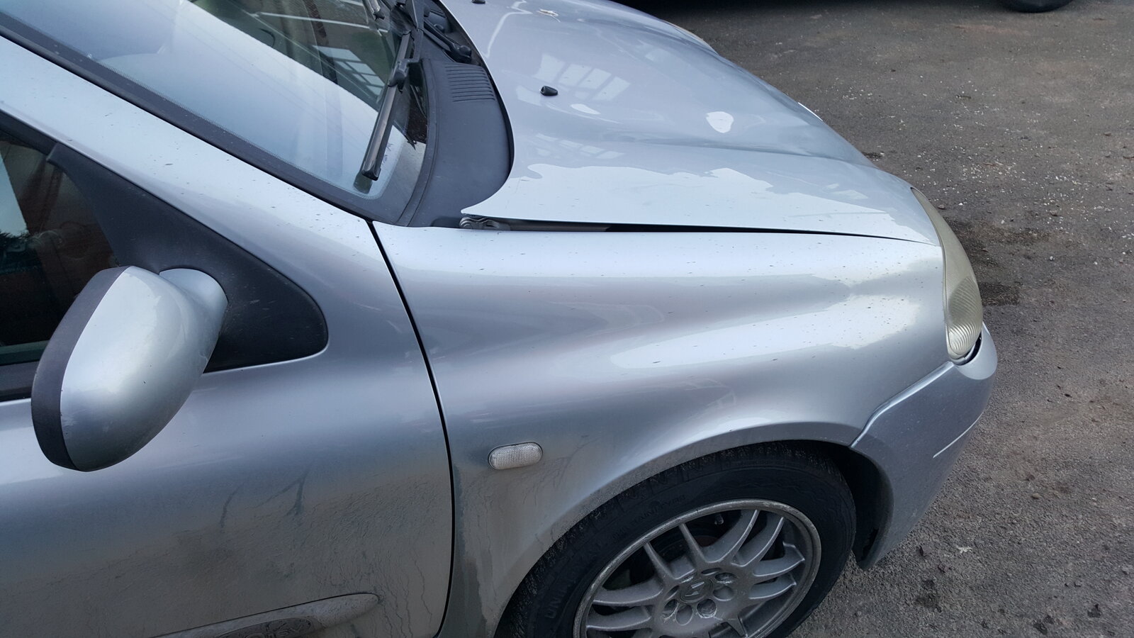

Hey everyone
I’ve had my slam panel off for ease of access. Now I’ve put it back on the bonnet won’t close! Is there a specific way to fit it?
Cheers in advance
Hey everyone
Cheers in advance
