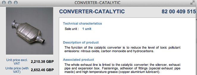

A lot of people go aftermarket or cheap due to the fact that the price of a new OE CAT is crazy
(Generic Picture Of CAT In The Price Tab)
