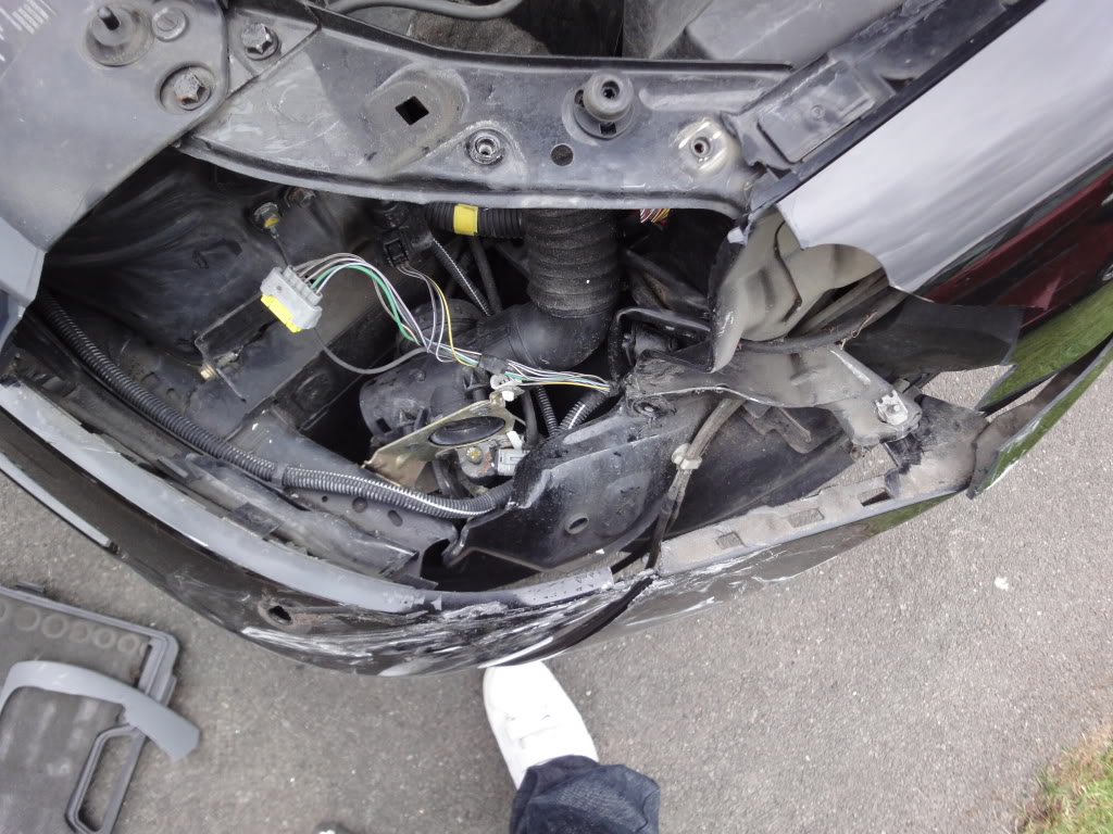

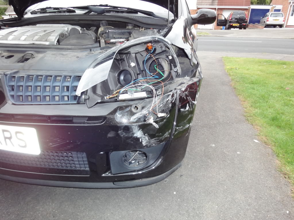

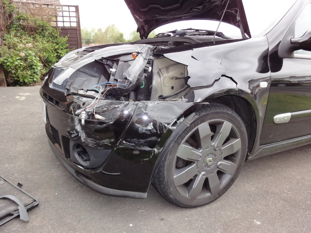

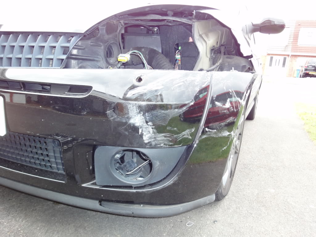

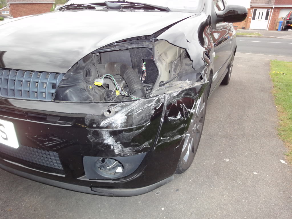

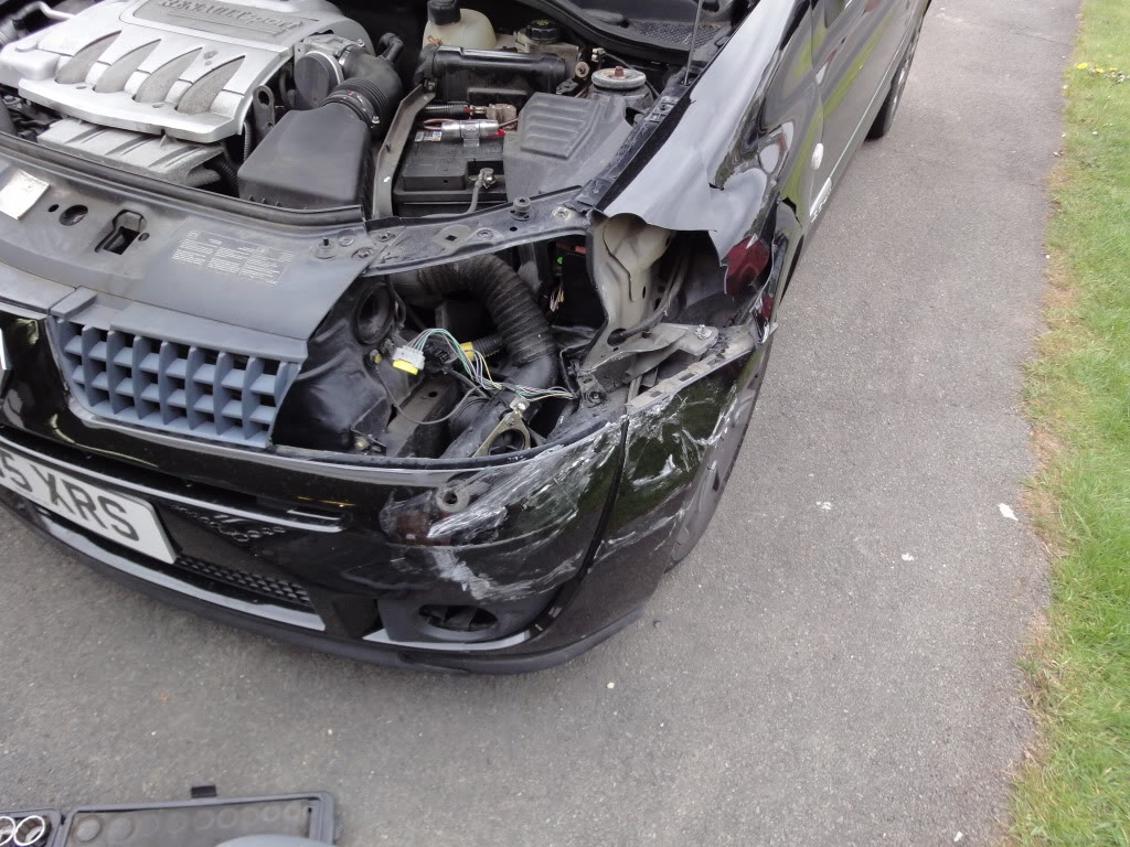

Cant work out if any structal damage as dont know the clios very well? can any1 tell from the pics?

Looks purely cosmetic from the limited bits we can see. Just buy all new bits and bolt it back together. Be fine.
  www.renparts.co.uk
wing bracket/flitch looks like its damaged and might want knocking back out!
as he says, just tap it back out. thin piece that joins the flitch to the front crossmember. Not long till the cat C brigade will arrive, telling you it should never return to the road.

Take the bumper and wing off first to see if there's any structural damage.
