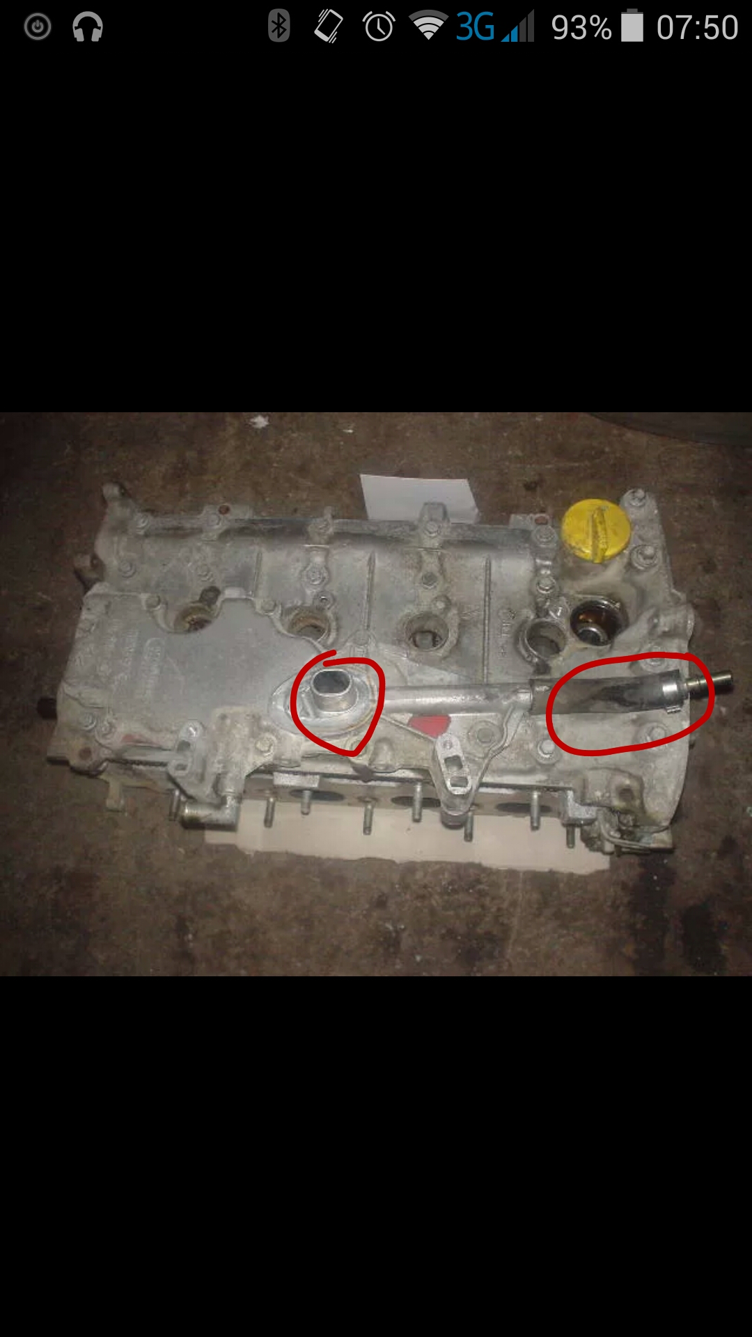

Ok thanks, the bits I have highlighted in red what are they for and can they be blocked off as the current cylinder head has the one to the right blocked off, was it the carbon canister pipe?

Ah ok, any idea why the 182 cylinder head doesn't have them?
The one you've pictured is a 172 head and the carbon canister is connected to the pipe that's currently blocked. The other piece that's sticking up isn't there on a 182.
You'll need a 182 upper inlet I believe if your running a 182 head. The carbon canister is connected up to the rear of the inlet manifold on them so obviously that would need blocking off.

So the blocked off pipe is ok if it's just the carbon canister? Have noticed oil around the piece that's sticking up not sure if that's normal

Yeah that pipe that's blocked off in your pic needs to be blocked off on a 182 inlet manifold instead. If you don't it'll rev itself and you'll have a 5k+ idle speed!
Oil around the piece sticking up isn't totally normal mate, but a small amount is no issue.

Thanks for your help mate, it's not a massive amount of oil might clean it off and see how much comes back, the back of the engine is covered in oil tho.

That's from the breather plate seal or the rocker cover seal or the rocker cover bolts I'd imagine mate. Breather plate and rocker cover bolts are simple to sort. Rocker cover not so much!
