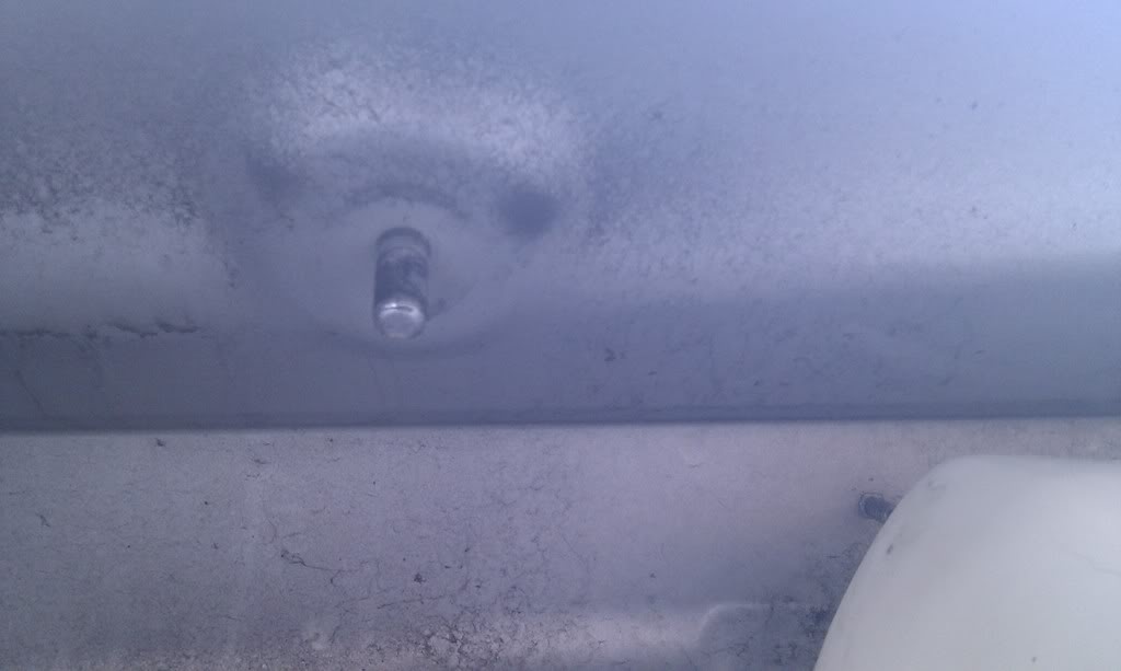

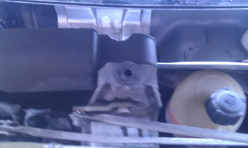

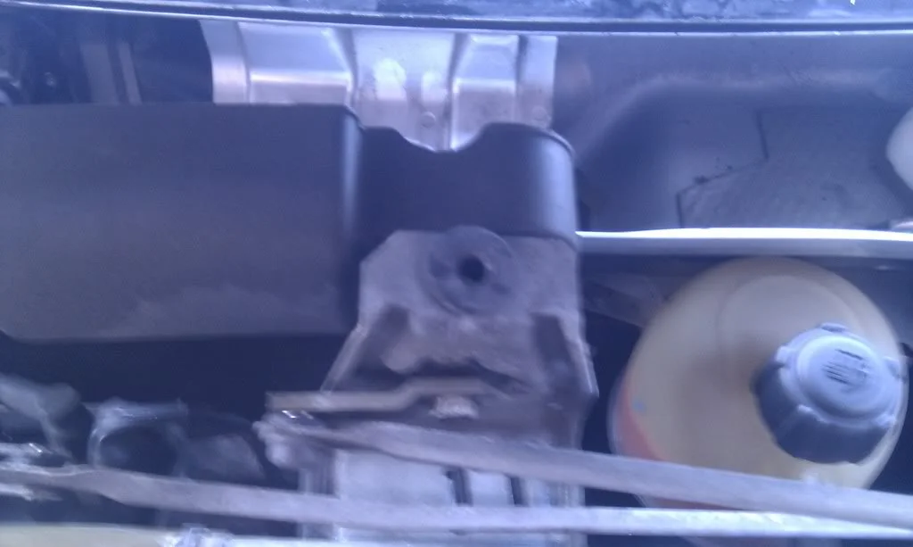

Did you locate the wiper linkage back on the dowel pin on the bulkhead?

Could you use simple words? I'm French and I can't figure out what dowel pin means
Like a pin that sticks out on the body.
Here are some pictures i've found
